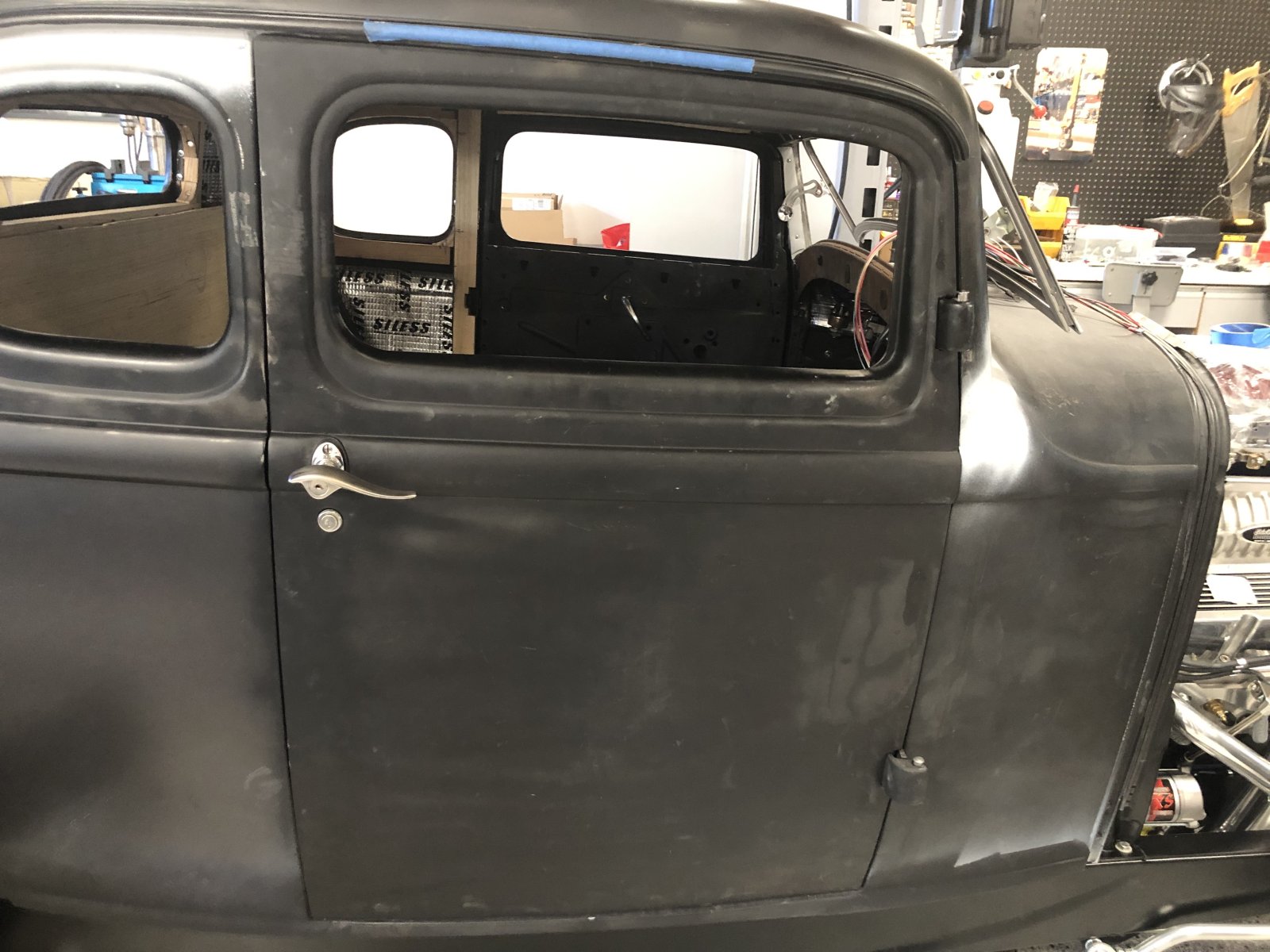

    Several things; I did have to have the ch***is straightened as it had about a 1/2" twist in it. All done right on laser table. I'm sure the chopping of the top has led to a lot of needed tweaks and additional welding etc. to get it right. I did get the p***enger side to fit better yesterday by taking the top body hinge out and using a "big hammer" on it. I'll need to play with the body shims until I get it as close as possible then finish by adding material where needed.
    There was a lot of work to do to get the windshield fitting correctly as the "A" pillars needed a lot of mods after being shortened. Due to way they dropped the top the bottom of my windshield frame was about 5/8" wider than stock which required a new piece to be made to fit right. I'm just going to have to go through the same process to get my doors correct. I'm attaching pictures of both doors as suggested by "clem" in one of the responses. Also, it does have the stock firewall with the seal intact. I had to fill 44 holes to save it though. picture showing firewall.jpeg passenger side door.jpeg
