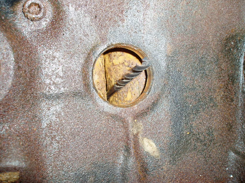

    If you have the center frost plugs out, do the old drill bit test. Of course this doesn't account for core shift, corrosion, wear, etc but it should get you close to understanding exactly how thick the cylinders are. It would not be unheard of, but pretty unlikely that Ford would machine a raw 427 casting to 390 specs.
    .375"
    3/8"
    No Good
    .312"
    5/16"
    No Good
    .281"
    9/32"
    4.080" Max
    .218"
    7/32"
    4.160" Max
    .187"
    3/16"
    4.18" Max (In a 406 or 428, Good Block)
    .187"
    3/16" (427)
    4.293" (68 C8AZ-6010-G) .125''
    .125"
    1/8" (427)
    4.310" (Marine Block & Some Early 427's)
