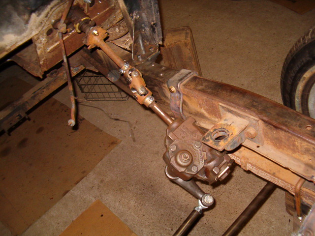

    ...525 box from mid 60's Chevelle,..or clones.
    raven and continentaljohn like this.
