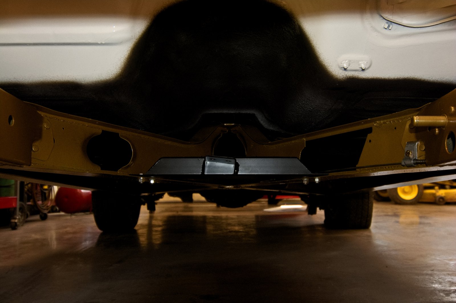

    I made my crossmember to accept the clocked transmission. It's hard to get complete factual full specifics on Pontiac stuff. I have a standard bellhousing from a 64 big Pontiac. It's different from any other bellhousing. It takes a big Pontiac specific starter and there is no such thing made now. We had to basically make ours. I have since found some factory rebuild parts.
    Your early bellhousing will be tunnel mounted with side mounts. While they are out there finding a bellhousing for your 57 is not an easy thing to do. Finding manual anything for the early Pontiacs isn't easy to do.
