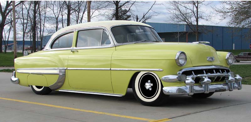

    Curious if someone could shed some light on a few things for me. I just picked up a stocker '54 Bel Air post and I'd like to start peeling away the layers of Grandma-ness. I've already got the Fatman uprights and arms, tires, etc. on the way but I'm somewhat stumped on engine stuff.
    I'd like to use those tube headers from Speedway to split the exhaust but I don't really want to upgrade to a multi carb intake just yet.
    1. Will the Speedway tube headers work in a '54 with a stick or will I need to use the cast manifolds? It looks like space could be an issue on the rear. Any interference from the e-brake or motor mount?
    2. Can I make a block-off plate to cover the heat riser area on the bottom of the intake and retain the original manifold for the time being?
    Also any other experience anybody can share would be greatly appreciated. I haven't delved into tearing the front suspension apart yet but I'm sure the learning curve will be fairly steep on that too.

    The header you are talking about will work just fine. I put that in my 51 chevy 2 dr sedan. You will need a very good exhaust man, (not a commercial shop) but a good experienced shop that deals with the older cars. There is quite a bit of tube bending to get around the e-brake and pitman arm. Also take a very close look at your throttle linkage from the gas pedal at the fire wall, you might have room issues there as well. The header will not hit your firewall at all the bolt right up and you will be fine but the gas pedal linkage will rub.
    As for the intake heat riser you don't really need it however it should come with a plate you can bolt on. As for body ans suspension, hell leave it as is cut a coil or two in the front and look into night prowlers for some lowering blocks for the rear.
    Great looking car by the way
