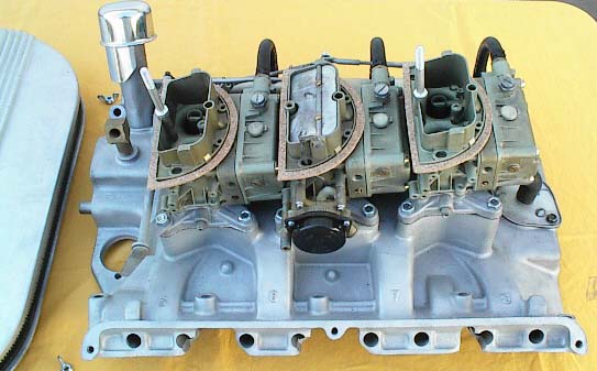

    Another option on fuel delivery:
    http://www.thecarburetorshop.com/Fordtripower_3.jpg
    Personally, I have dual Carter AFB's on my 390 shop truck; but they have been on there for 18 years and I am ashamed to post a picture of the engine compartment of a work truck :(
    And yes, the exhaust manifolds WILL leak between the manifold and the cylinder heads :mad:
