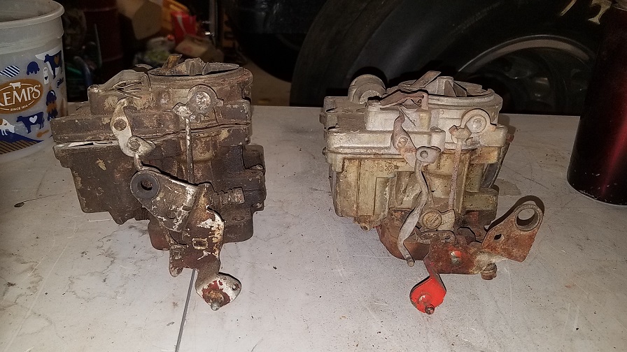

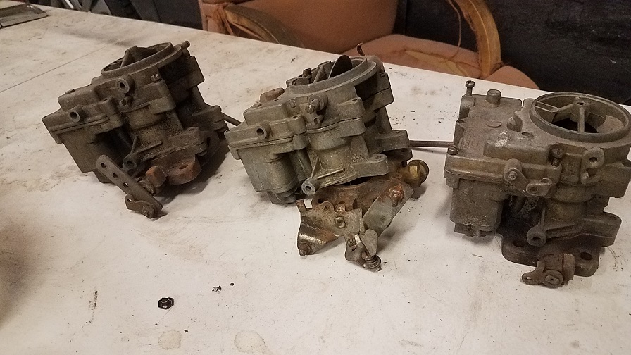

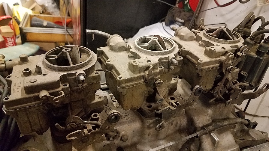

    These are the three I got with the olds intake. I'll post the others also. 58 olds 2.jpg 58 olds 3.jpg 58 olds1.jpg swaps1.2.jpg swaps2.jpg tonys1.2.jpg Tonys1.jpg Tonys2.jpg swaps1.2.jpg swaps2.jpg tonys1.2.jpg

  9. Outer carbs need no idle circuits and the ****erflies need to seal when closed. You can make your own progressive linkage with some bar stock. Also make sure you have the proper amount of fuel pressure so it doesn't overflow the outer carbs when not it use.

    I used the Speedway base kit with good results, came with thicker fitted throttle blades, front and rear carbs need to have tight fitting "closed" blades, or they will be a vacuum leak.
    If your J-2 carbs are rebuildable they could save you the cost of the whole kit, they got the right bases.;)
    Pretty sure progressive linkage kits with the replacement shafts are available.
