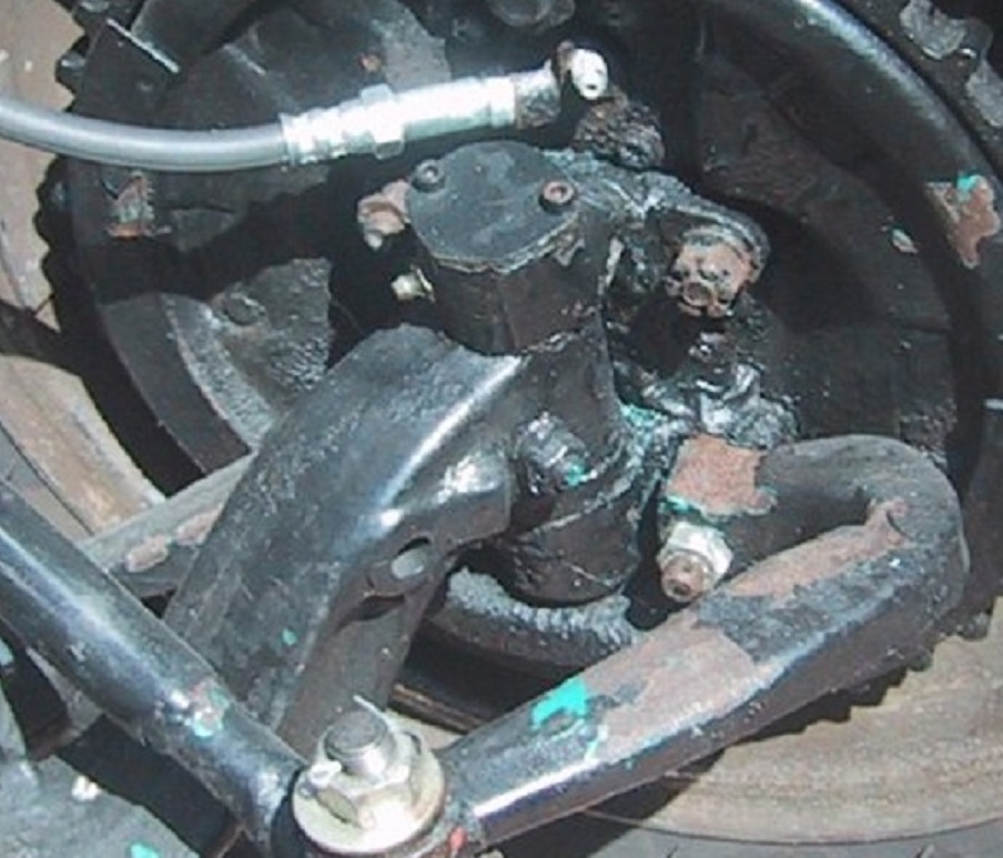

  3. King ford
    Joined: Mar 18, 2013
    Posts: 1,477
    King ford
    from 08302
    I agree,...looks like one bolt holds the steering arm to the spindle....if that is in fact the case I wouldn't drive that ***** onto a trailer !

  6. 117harv
    Joined: Nov 12, 2009
    Posts: 6,586
    117harv
    The steering arm is fine, it has two 035.JPG 036 (1).JPG 085.JPG bolts, but some other areas need a rework.

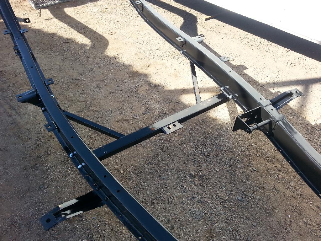

    Here is an example of a trans mount/gusseted crossmember from a thread about a Fleetline build. I think Marty Strode mentioned this early on as another way to strengthen ch***is. Haven't found a pic of dropped tube type.

  21. Marty Strode
    Joined: Apr 28, 2011
    Posts: 9,689
    Marty Strode
    This is how I do my center C/M in the track roadster ch***is. P1010037.JPG

  27. Kerrynzl
    Joined: Jun 20, 2010
    Posts: 3,611
    Kerrynzl
    This ^^^ is the best method for a centre x-member . Drop it down as deep as possible, then run straight pieces back to the rails [and preferably forward as well]
    What you get is effectively an inverted pyramid shape. It is one of the best methods to get torsional stiffness in a ladder frame.
    Deep front and rear x-members with spreader bars at each end also help a lot.
