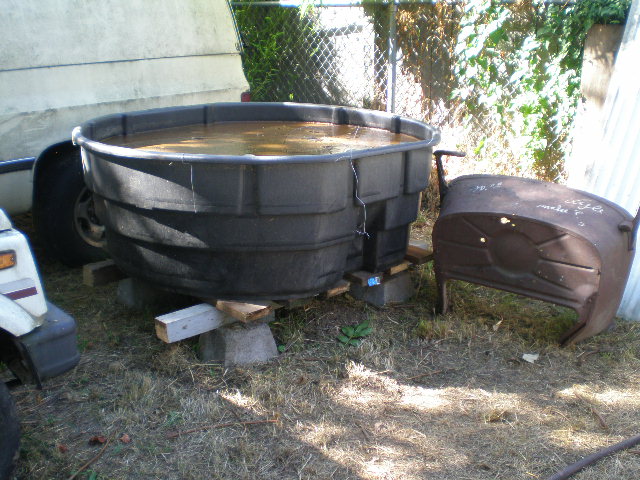

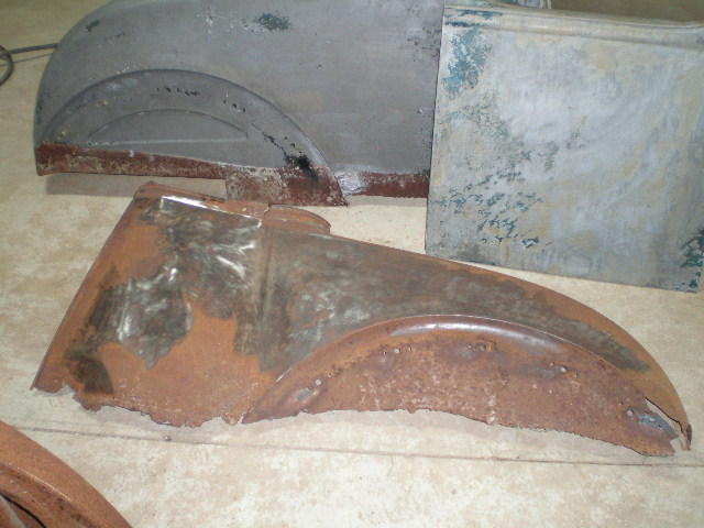

  17. NORSON
    Joined: Jan 19, 2009
    Posts: 469
    NORSON
    I use mol***es. I use a 300 gal. stock tank and mix it 7 to one. I buy the mol***es in 3 1/2 gal. pails for $9.00 per. It costs about $100 to fill the tank. The mix is effective for about three months. The tank is big enough to do model A roadster quarters, coupe cowls and doors. I use paint stripper for the paint. most of my parts have little if any paint, but mol***es won't remove it. It takes about two weeks for a load. I wash the "slime" off with a hose and nozzle and brush on phosphoric acid (etch) to kill the flash rust. I've been using this method for three years and it works great. I wash the parts off on the gr*** (where the dogs play) and drain the used fluid into the sewer. When the mix gets old it gets kind of rank, but by that time its time to dump it. Norm
