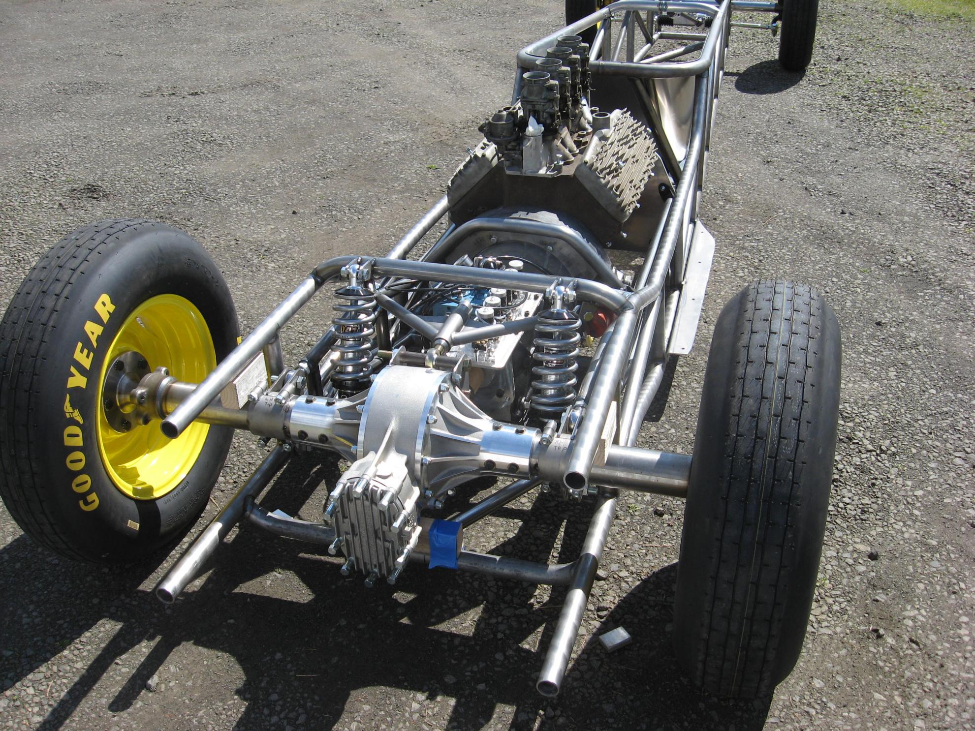

    Thanks for posting the brochure, we are in the process of repairing a V/8 Pat Warren rearend. The "live axle" unit is what we are putting together, and are looking for sideplates and what I think is a 1 1/2" axle.

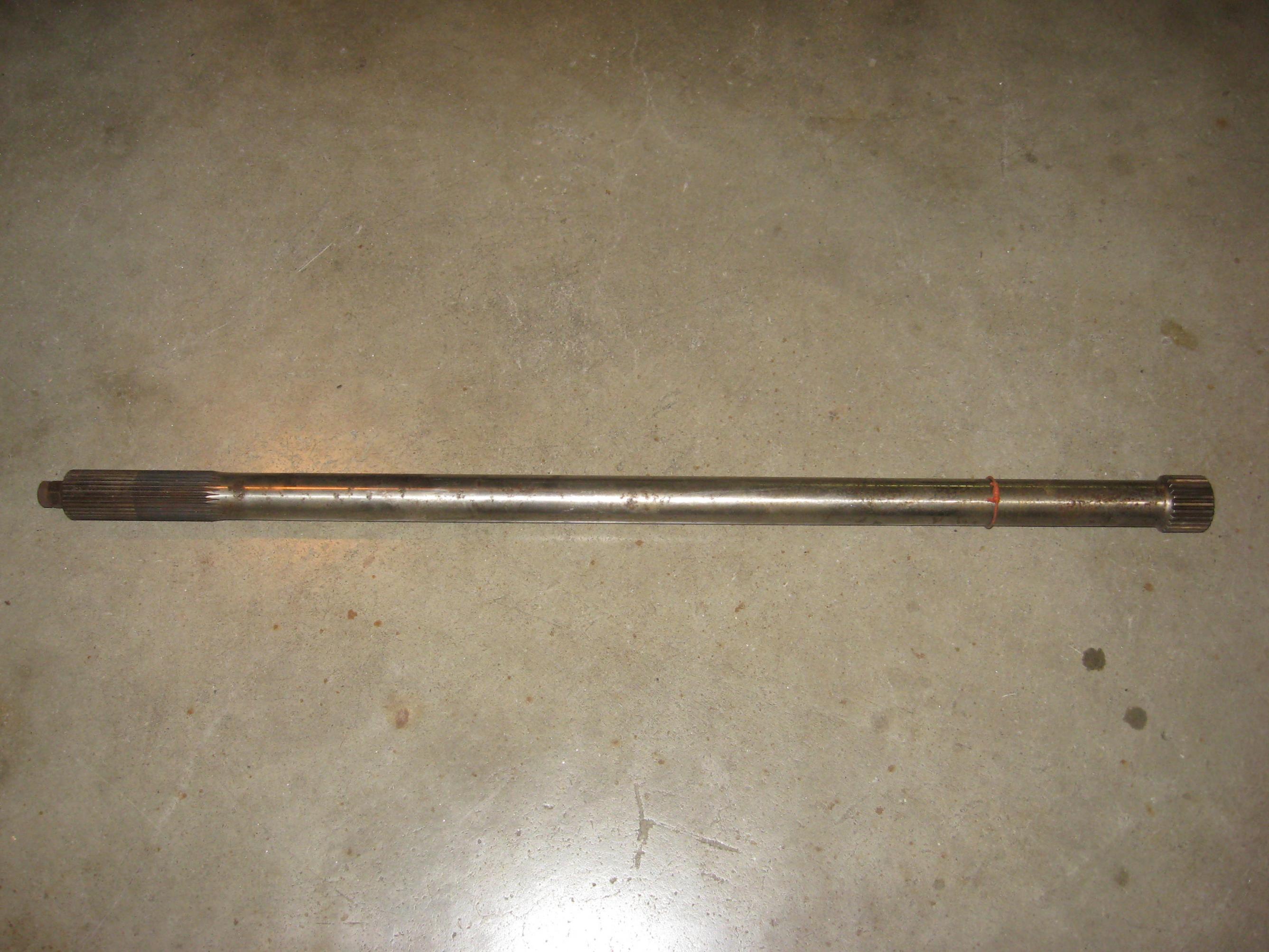

    What is the proper way to measure and setup the double splined axles for a quickchange with a differential? I'm used to the old truck style axles that you can just bolt in, and they stay where you put "em, but there must be some sort of locking bolt arrangement to keep the double splined axles apart...maybe I just answered my own question, but I'd like to get it right...Thanks.

    Thanks for the reply, these axles have splines on each end, (look like a torsion bar), 31 spline to the diff, and 24 spline to the drive plate that bolts to the full floating hub...I don't think they should **** up inside the diff, hence a locking spacer bolt? Should have clarified these are full floating truck style hubs.

    Hugh, The aftermarket full floating axles come with a 7/16 tapped hole tapped in each end. On the inside you install a bolt and lock nut, that way you can adjust the end play and keep the axle in the drive plate. This one is 31/24 spline. I would buy from Lefthander or Coleman.

    Marty beat me to it. That is the correct way to do it. You can put bolts in one or both axles. Someone once told me to round the corners on the bolt heads so they couldn't catch and unscrew. Seemed like a good idea and I've done it that way ever since. Never had one back out.
    Total end clearance should be about 1/16", pushing both axles against one side plate and measuring from the flange to the axle shaft.

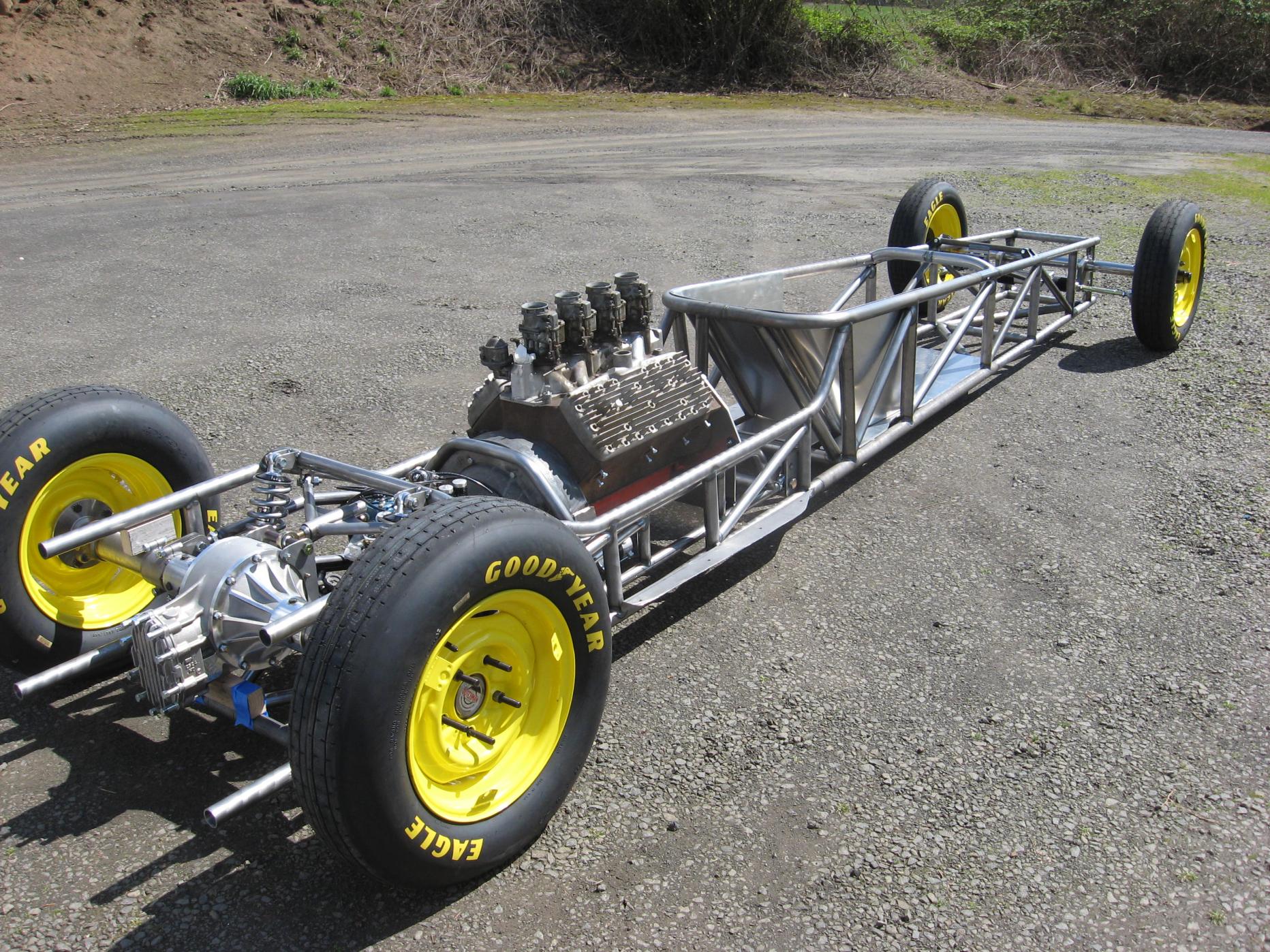

    Do you have any experience with the new Winters V/8 unit? We are using one in this Bonneville Roadster I am building. I hope it will hold up to a blown flathead and even more power down the road.

    Not exactly. We used a Winters Midget rear in a late model with floater axles etc. It held up to 600 H.P. okay. Went back to a 3/4 ton unit because nobody else was using 6 spline gears.
    I would bet that the V8 unit will hold up just fine in a salt flats type car. There just aren't the shock loads.
