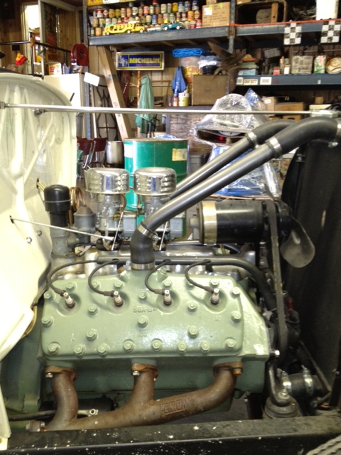

    ****well i was going to buy it anyways but after all the positive responses about the quick change noise (see question below) I bought the Roadster today from a first class guy! couldn't be more happy. here are a couple pics

  22. lowtech36rod
    Joined: Jul 21, 2007
    Posts: 626
    lowtech36rod
    from Kentucky
    Added pics of the car. Thanks again for the advice
  23. Kool pics. Looks like a fun ride. Enjoy the "noise".:)
