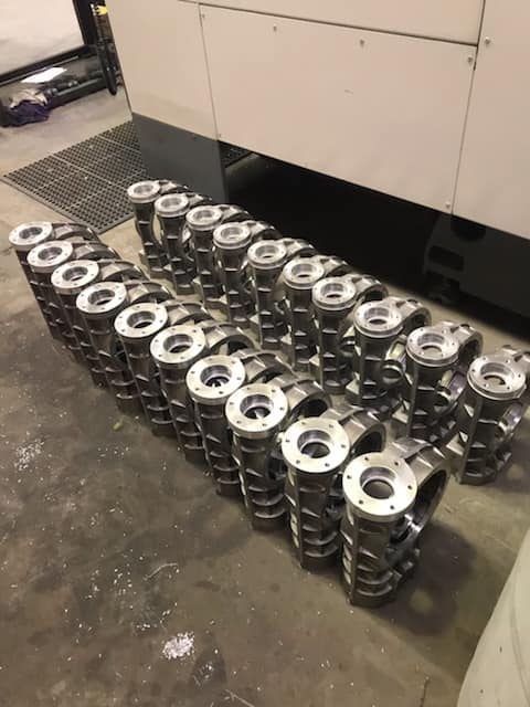

    Kiwi Quick Change for Model A is what I have.
    Check past posts and I see a FB page. 40ADC4D8-9CA3-4524-B4A1-191D59BFED55.jpeg
