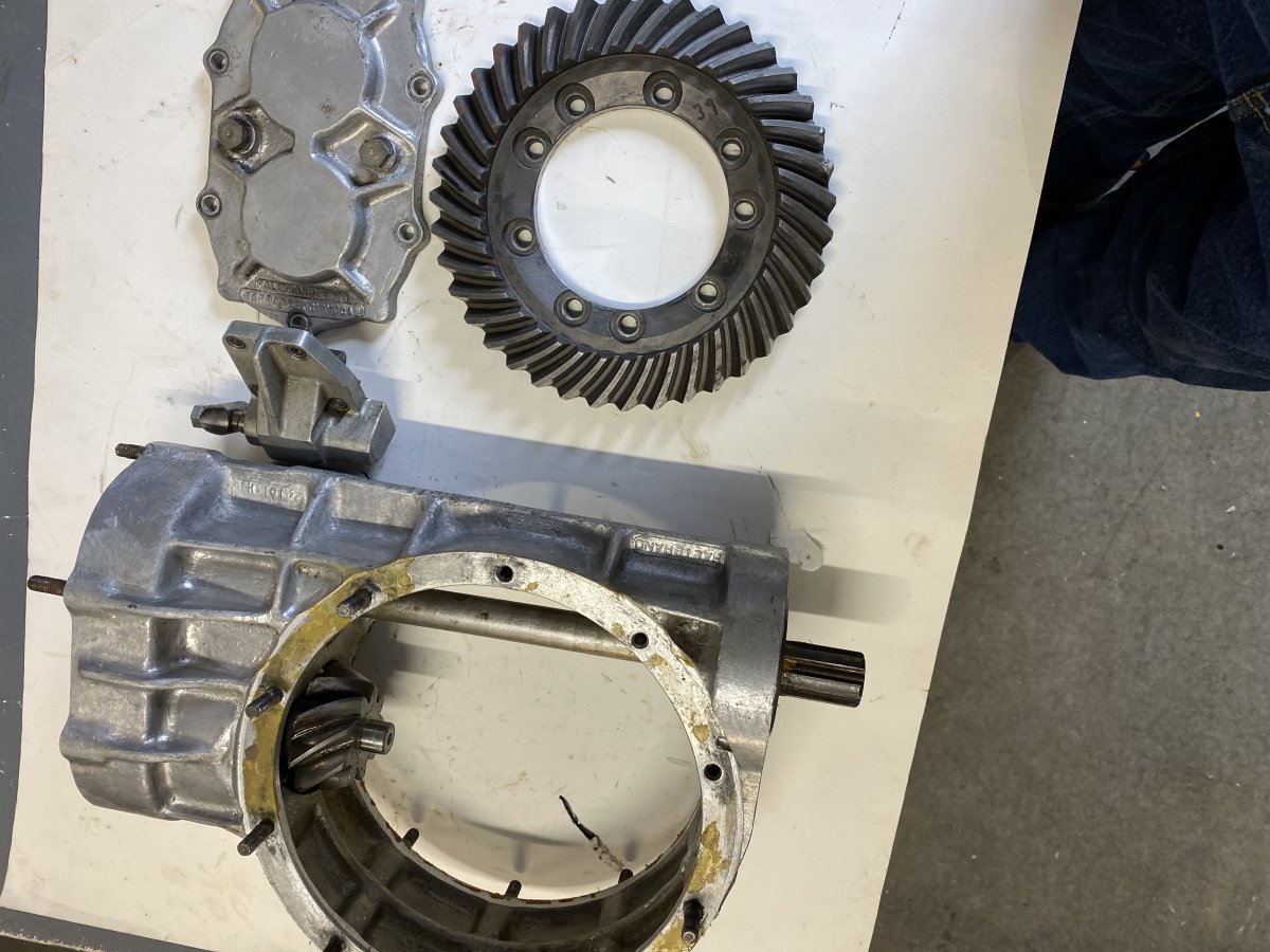

    are all magnesium case's???? didn't find the 101??? but l347 is stamped????
  4. ALLDONE
    Joined: May 16, 2023
    Posts: 4,041
    ALLDONE
    on the bottom rib it says Hilbrand eng... the bango is 3 3/4 wide and the snout sticks out, so def. not 101 ... how do you spot a champ??? does it look differant than 102? the rear cover says culver city2

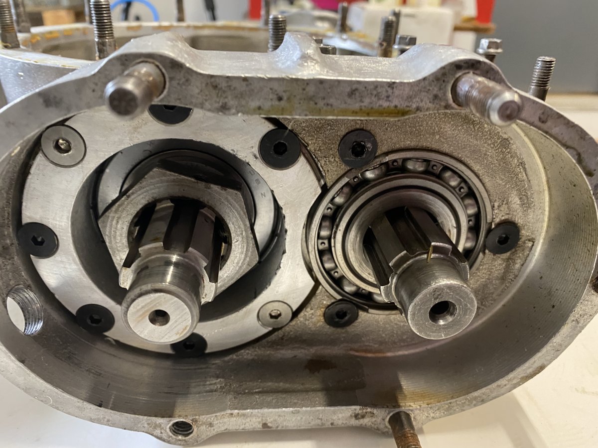

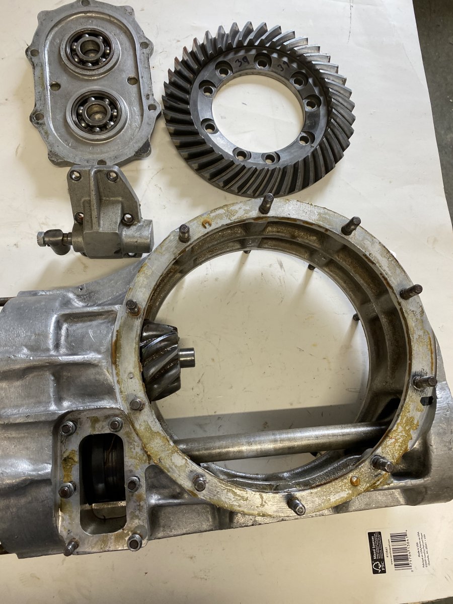

    mine has the same square casting on the rear side..mine looks like this one...? what is it..

    Can you post a picture or two of what you have?
    H101 no pinion support, uses Model A axle housings
    H201 Pinion support, uses 1935-48 axle housings
    H301 much larger 3/4 ton truck, no confusion with 101 or 201
    Edit: The one in the picture is a 201 (also known as a V8 case). If yours is like this then that's what it is!
  9. GearheadsQCE
    Joined: Mar 23, 2011
    Posts: 3,669
    GearheadsQCE
    Alliance Vendor
    Looks like our posts crossed in the Twilight Zone!
    Yes, that is a 201. The 201 designation is probably what is smeared on the left side of the casting after "Halibrand Engineering Co"
    You are correct, the axle trumpets are different than the Model A parts.
    Since you seem to want the Model A version, I'll take the 201 off your hands. Send it to me and I'll dispose of it properly. Just to be nice guy, I'll help you with the postage:D

    any Idea of the vintage??? it is magnesium
