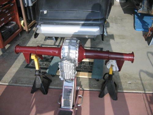

  6. Here is a Tech article Body & Frame # 3 011.jpg I did on setting up my Winters V8 Quick-change.
    ekimneirbo and mctim64 like this.

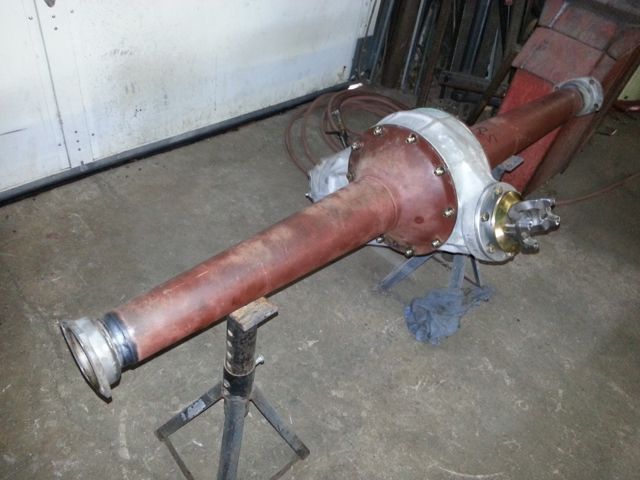

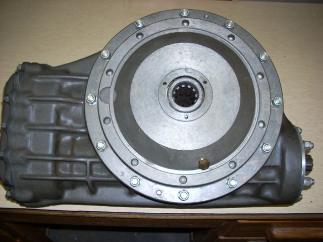

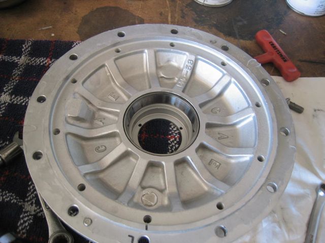

    Great idea as I have received questions on some of my old posts. I have been a QC guy my whole life and I don't plan to stop now. The volume of questions I receive are concerning a differential for the Champ with side plates for the early Ford axle tubes. I did a post on the conversion using a Diamond Trac but I know there are many others that can be machined to fit the bearing surfaces of this set up. I am helping a fellow right now with this very problem. The Champ center sections are a little too large for the Deuce but I like them in a 34 Ford. The cases are reasonable but the side plates and differentials are hard to find and expensive. Winters has the best deal going today with the demise of Halibrand but I still like to work on the old Champs. Here are some photos of what I do most of the time with the Champs.
    I prefer the look of the Ford housings but they are a lot of work.
    Finding the side plates is getting real hard to do. If you are using the 11 bolt version I believe the Winters adapters will work.

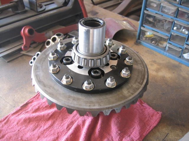

    Here is the differential that has been cut down on the right side to fit in the housing. Note the cut goes down into the differential but doesn't affect the strength as it is just a few thousands.
    This work was done by John's Rear Ends in the Valley.
    I was lucky to locate some NOS CAE units for a good price. Seals and races are available at any good bearing store.
    These EF bolt circle holes have not been drilled and came that way from Halibrand. I tap them but some people drill them all the way thru and use studs for easy removing and less striping of the threads. Note there is a seal to prevent any oil from coming into the housing. I still install axle seals on my 9" inch housing ends just in case.

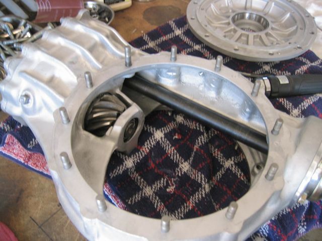

    The Hot Rod Works in Idaho has the blueprints to make the adapters that they made from one of my old sets. They are the experts on this set up. I would think they would be expensive to have machined. Most differentials used in racing are too wide for this set up. Halibrand used to purchase theirs from the QCE in Santa Fe Springs, CA but they no longer produce them due to Halibrand's demise.

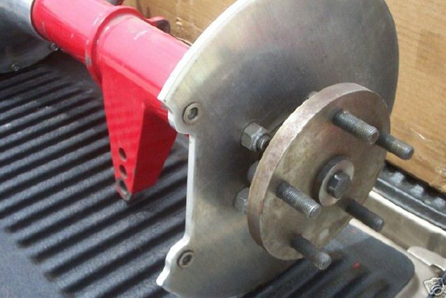

    Here is a photo of the plates used for the Champ 12 bolt housing.
    This is a nice pair of adapters being installed on a Champ QC 301 Roadster unit.
    Here are the new Winters side adapters used on the Champ case – 11 bolt case. I don't think you can use the EF housings with this set up but their housings are excellent.
    The small unit looks good but it's not a Halibrand look. The axle tubes will not bolt to the EF 10-bolt circle.
    Here is the advantage of the Winters unit – the gas tank does not need to be notched as it is shorter than the Halibrand 201 case.

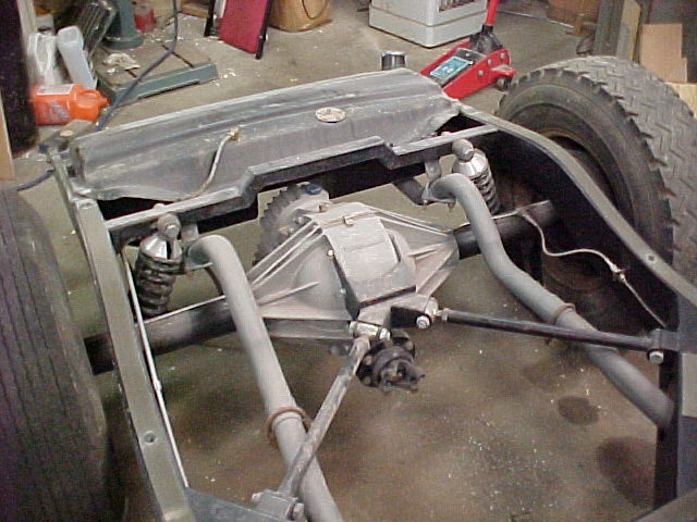

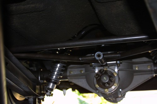

    [​IMG][​IMG]
    This Winters QuickChange is under my 54 Stude Conestoga (Station wagon).
    Mike

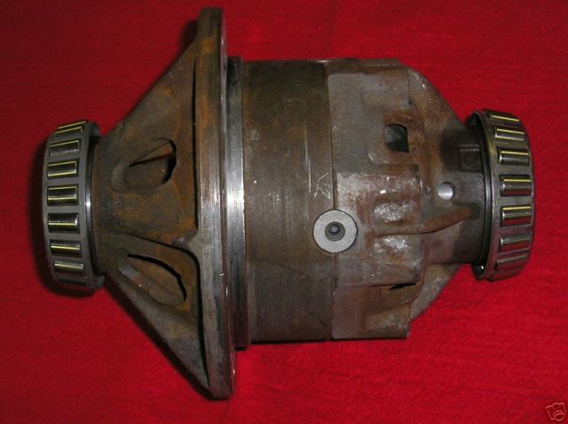

    As I recall, the bearing centers on the Champ with side plates is about 6.875 so everything I looked at required maching the right side down to obtain the correct bearing centers. You can see that in my post above. I found all my differentials on ebay and never got a bad one even though they were used. Prices varied from $100 -300.

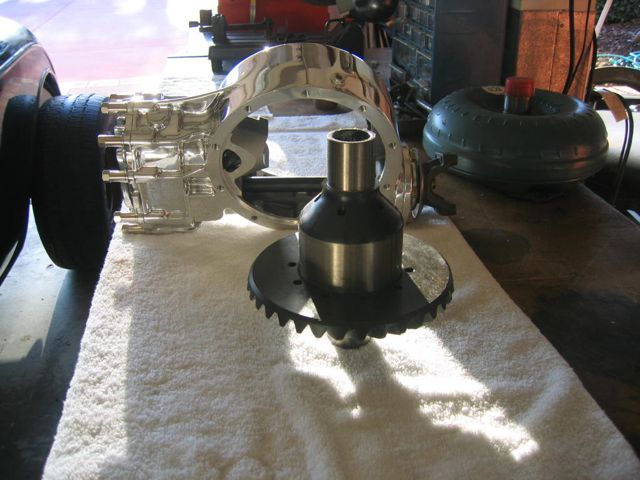

    This is a 3/4 ton Ford Truck differential that can be used with the 11 bolt side plates. Hard to find and usually has welded spiders. They have 12 spline side gears which I replace with Ford 9 inch 31 spline gears.
    Some machine work required.
    The Winters differential will not fit in the Halibrand to my knowledge but Rodsville used to offer a nice differential for their clone case.

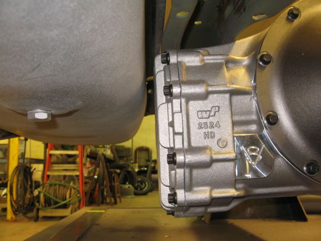

    Thought I'd pipe up and remind people that cyclone Q/C's are still available and they too are short enough to clear a 32 fuel tank in a 32.
    Cyclone Kevin relaunched Cyclone Racing Equipment a few years ago, and is a member here.

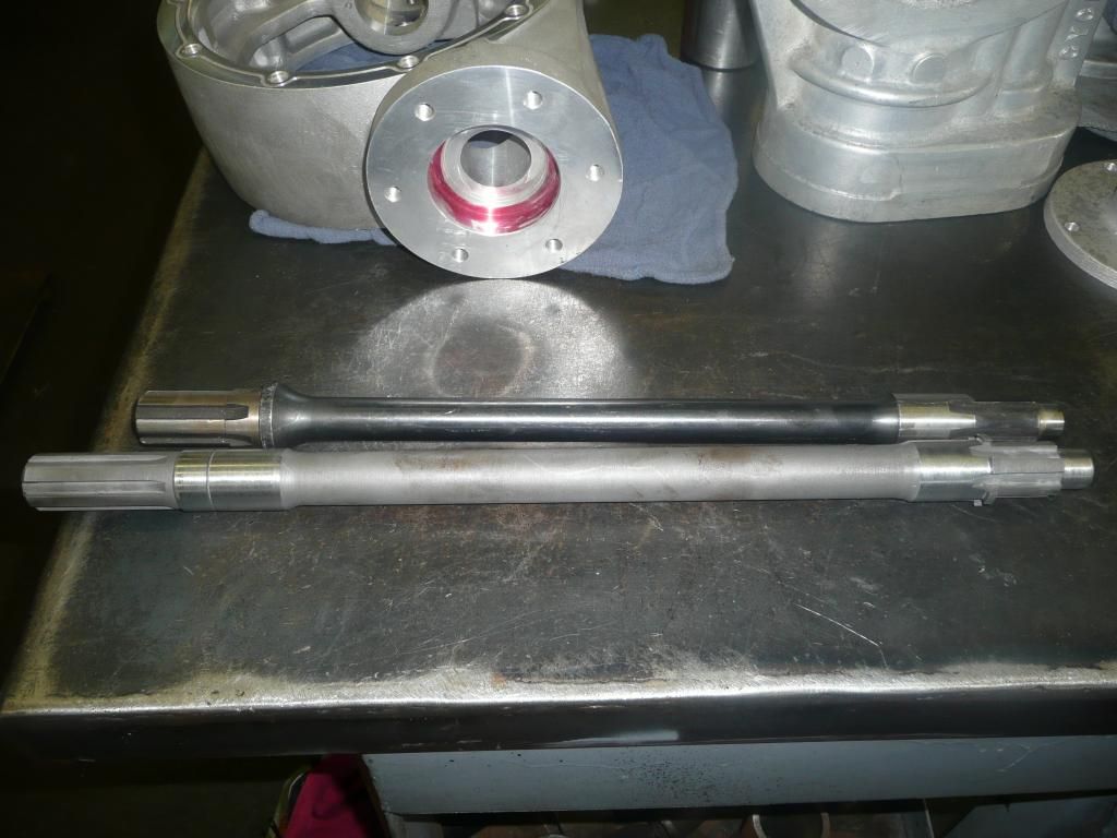

    Here are some pictures I took a few years ago, whilst visiting Cooks Machine shop.
    Notice the differences in the Quill shaft. The smaller is Halibrand, whilst the larger is the Cyclone. That, together with the reinforcing on the inside, makes the Cyclone a stronger Q/C as compared to the Halibrand V8.
    kidcampbell71 and loudbang like this.

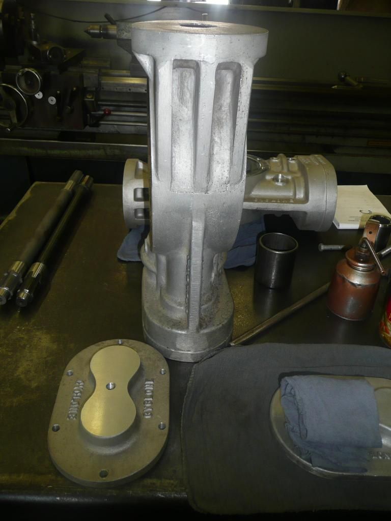

    Wouldn't the longer shaft require the gears to be farther back, thus making the Cyclone even longer than the Halibrand? I thought you said the Cyclone is short enough to not need a tank notch?
  28. Stovebolt
    Joined: May 2, 2001
    Posts: 3,690
    Stovebolt
    It doesn't need a notch, so the extra length must be forward. Cyclone Kevin has one in his 32, and no need to notch the tank

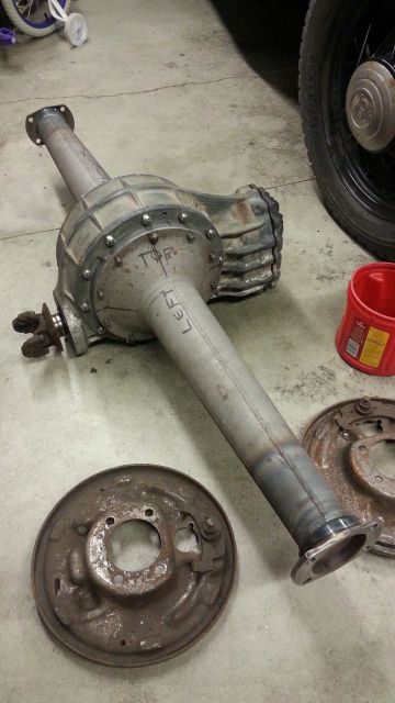

    Converted mine to 9inch axles, there is a photo of it in Pewsplice post. Anyone interested in one of these mods let my know.
