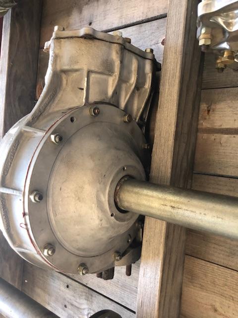

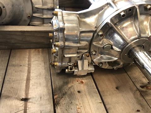

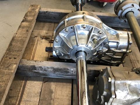

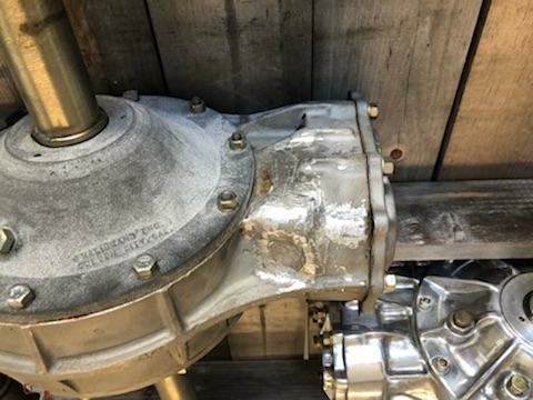

    I recently acquired two Halibrand midget quick changes. One is a 101, the other is a 101H. Both have live axles. I've seen articles about converting the 201's to use 28 spline axles. I have a 1931 Model "A" rear axle ***embly. The carrier is different than the 1932 V8 carrier. Will the V8 carrier and ring gear fit into the 101 housing?

    TrackTV6,
    I'm no Model A expert, but here is what I have gleaned over the years:
    First to answer your question, The V8 carrier will not fit in the 101 housing.
    I believe that most Halibrand Midgets were built as live axles. If you have a Model A axle ***embly you can likely put all the innards from it into a 101 case. Not sure about the pinion shaft, it may need to have the end turned down to accommodate the rear cover bearing.
    The conversion kit you want to adapt 28 spline axles is available from Hot Rod Works.
    http://www.hotrodworks.com/product-category/axle-conversions/
    I don't know of anyone else who has done a push in axle conversion for the Model A.
    As I understand it, the Model A rear end was used from 1928-1931 BUT there may have been carryover to some 1932 models. The 1932 had it's own rear but it may have been carried over to 1933.
    Most guys refer to the V8 rears as anything from 1934-1948. That eliminates any conflict with carryover parts.
    Now a couple of questions for you. You say your Halibrands are marked '101' and 'H101'. Are there any visible differences in the cases? Are you taking the numbers from enter section castings? Got any pictures? We love pictures.

    Its taking forever to load pictures from my phone! As I get more, I'll post them.
