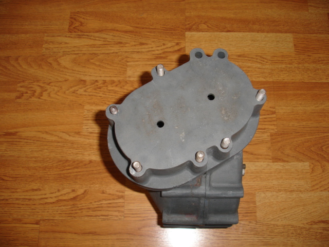

    Here is the new Winters side adapters used on the Champ case – 11 bolt case. I don't think you can use the EF housings with this set up but their housings are excellent.
    Lynn, I was under the impression that the early Ford axle tubes WOULD bolt up to the Winters adaptor plates. Do you have first hand knowledge either way?

    I believe the Winters bells are different than early Fords

    I have not used them but was told that Winters made their axle tubes bolt circle different from the 40 axle tubes. In other words if you have a Winters V/8 style that fits the EF axle tubes you cannot bolt the new Winter axle tubes to the unit. The 11 bolt adapters they make for the Champ style I think are made for their tapered axle tubes. I was told this by Dutchman when I inquired. I will check mine tomorrow and let you know.
    The bolt circle on the Winters tapered axle tubes is different from the EF axle tubes so I don't think they will work on the Winters side plate Champ conversions. The stock EF bells have a 9.250 bolt circle consisting of 10 - 3/8" holes spaced 36 degrees apart – I haven't tried them but Dutchman told me that when I inquired. I will try mine and see if they work. I would like to know how much the axle tubes sell for as they may be the way to go judging what I have to pay for good rust free housings, 9 inch ends and labor.

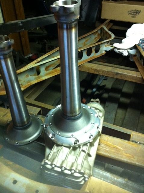

    New axle tubes from Lefthander (circle track store in Ill.)
    Big ford bearing cups and summit cut to fit 31 spline axles....
    Speedways disk setup...
    I just hope this doesn't make my *** look to big :)
    I will have to notch the gas tank a little, but i'm not worried to much about that

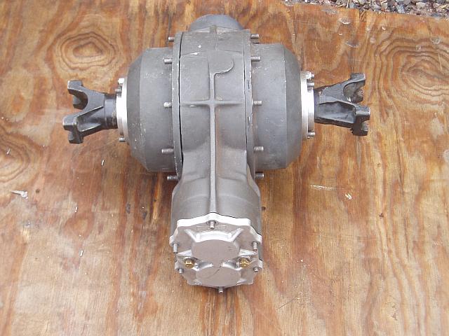

    I've got this center section. Its a halibrand V8 center, and the big side plates are magnesium, and it has a big old locker diff in it. I think it was used on some kind of race car over here (U.K) at some point. Found under a bench in a workshop over here by a friend of mine.
    I'll be converting it to 40 bells and nine inch axles, when i can afford it.
    Has anyone narrowed 40 bells? I'm going to have to so I can get my rims under my fenders.
    No one seems to know anything about the IRS conversion though, any thoughts?

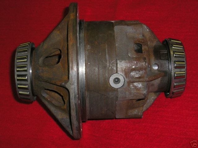

    Can anyone identify this? My buddy has this and we are all stumped as to who made it. The unit is magnesium and the only markings are 46Q6 cast into both sides of the case. I may be wrong but it looks like it takes model A gears.

    NEILSWHEELS,
    I would like to see some more pictures of that. Based on where you are, I would guess Allard. I will look to see if I have any thing like that in my files.
    I have narrowed '40 axle tubes (I prefer to call them trumpets) the secret is having an alignment bar that locates the carrier bearings and the bearing cups when you weld it.

    $um Fun,
    I've seen one of these somewhere before. I can't find a picture right now, but I think it is from a 3/4 Midget. The offset jack shaft is a clue.

    GearheadQCE, Thanks for the heads up. Do you know who made this and what gears it takes? To me it looks like Modal A gears, but I could be wrong.

    I saw one in a midget at a show, pretty sure it [the midget] was larger than 3/4..Maybe 1/2 or v8-60 cubic inch wise...I asked the owners son and he wasn't sure but threw Jones out...Back of my mind says Albion, got no clue where I got that from..

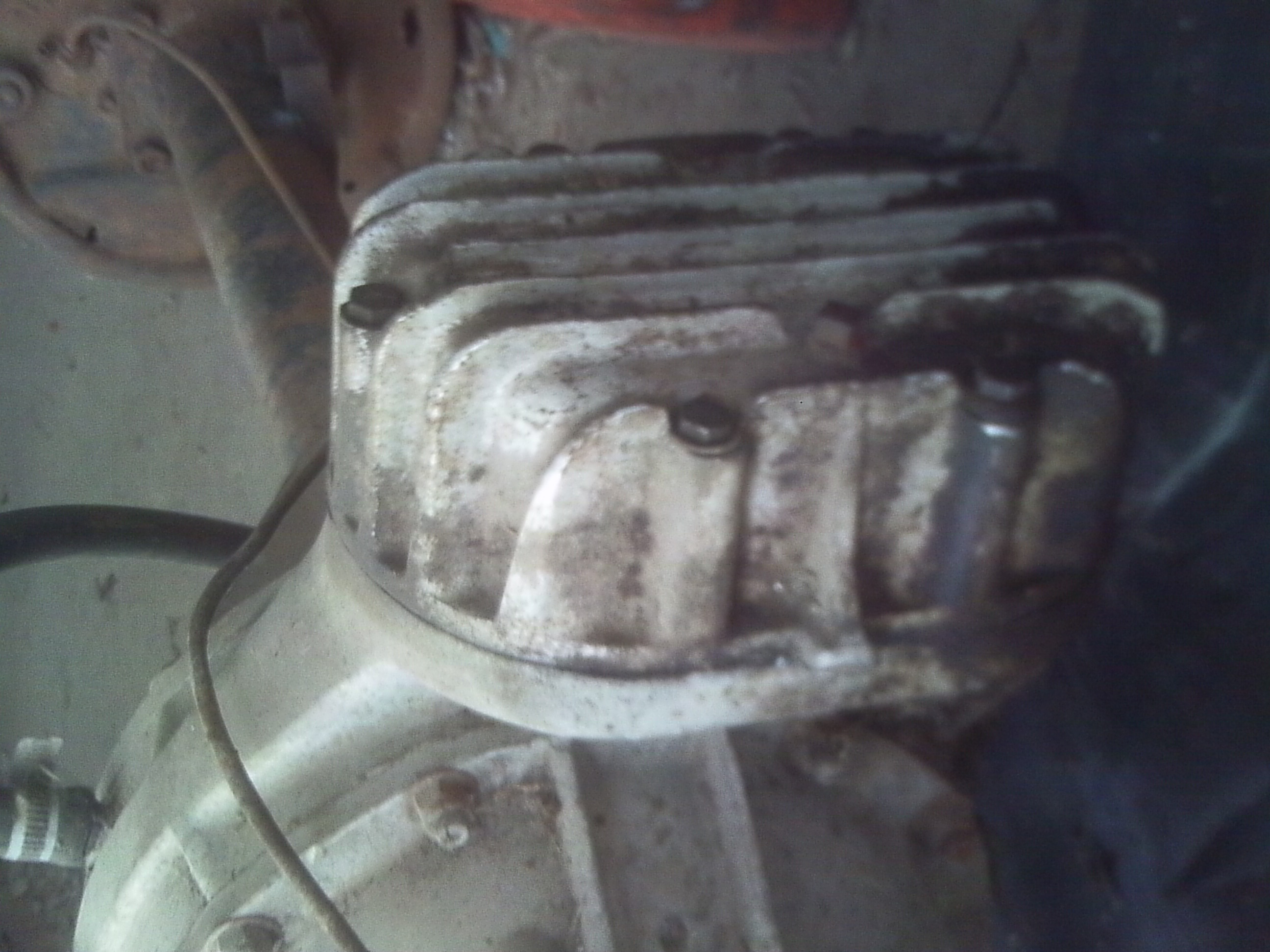

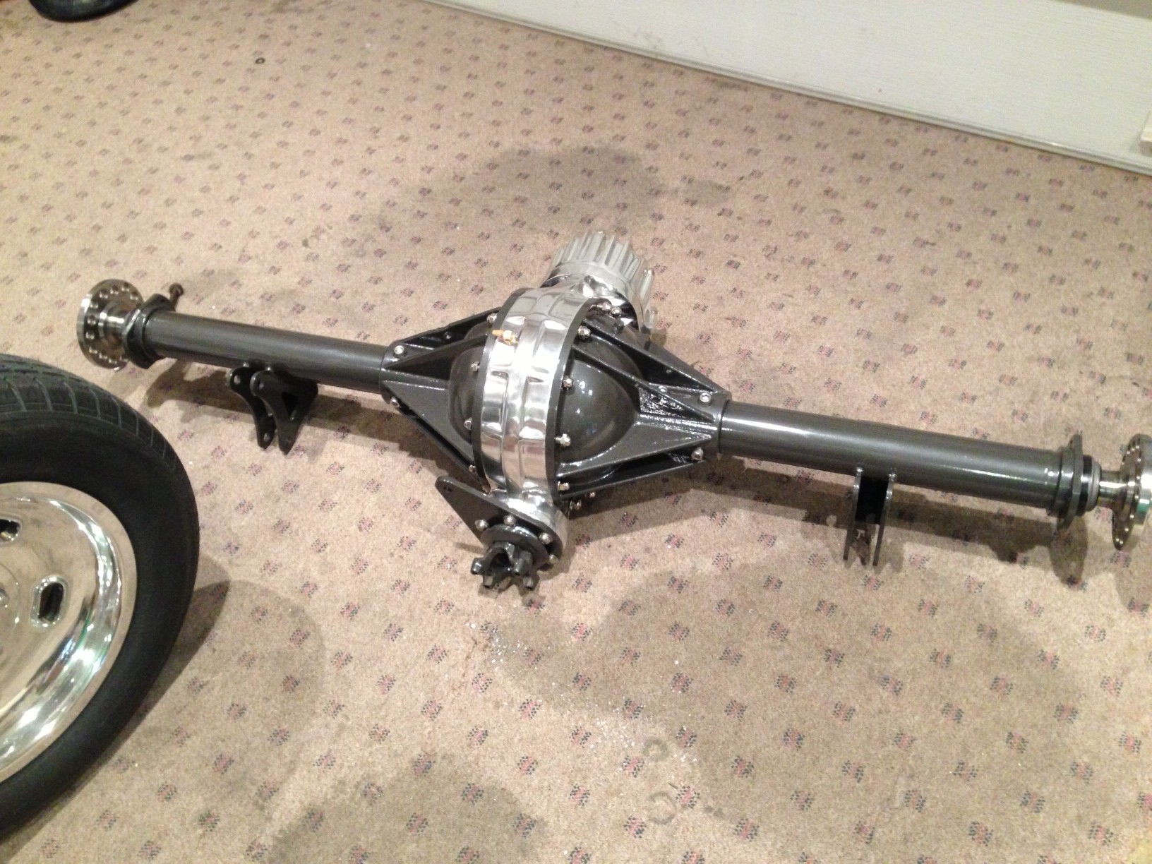

    Here is a Winter's/Frankland hybrid I put together from evil bay and the HAMB cl***ifieds. I am pretty happy with it. It was not as pricey as I was told it would be to peice together, it no where near as loud as I was told it would, and it was pretty easy to set up following the instructions on winter's website.
    Lil'Alb, afgjr and loudbang like this.
