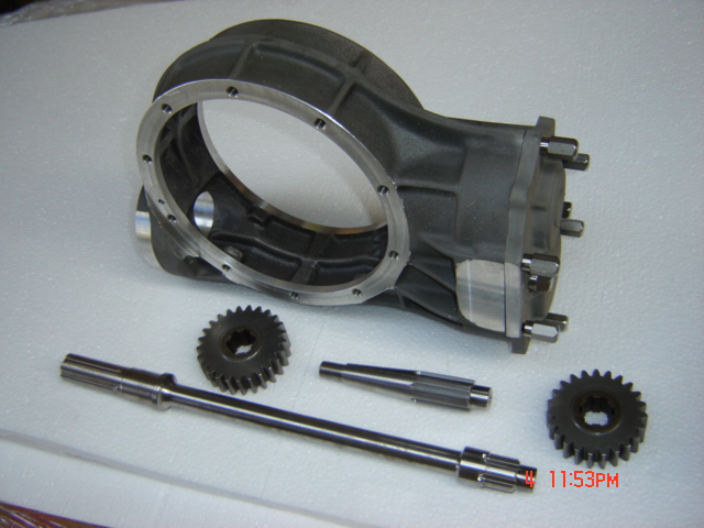

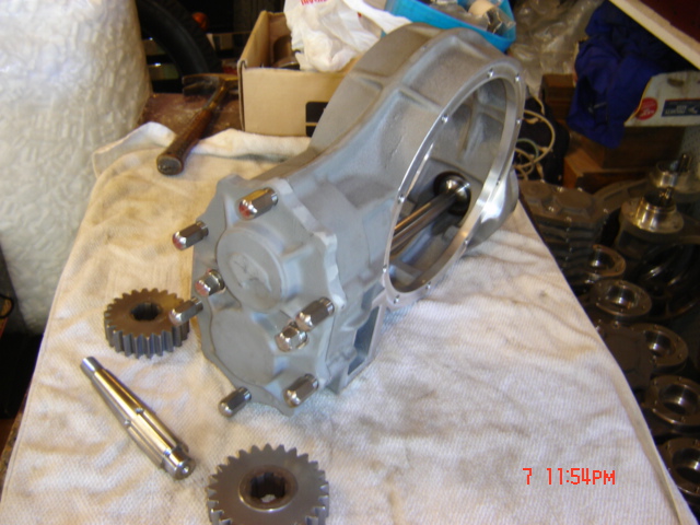

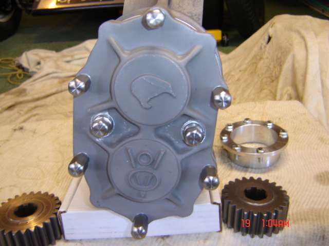

    Here are some Kiwi quickchange pictures, We produce the V8 version Plus the Model A one .Been doing them for 16 years & was about to stop due to my interest in Bonneville ,plus age , I have not visted this site for years but received a note that there was interest so took the time to come look. , Hope these pics are of interest & i can be contacted , antiqueford@xtra.co.nz ,Think im allowed to put that here , if not apoligise, Regards Derek
    IronFord likes this.
  6. Pewsplace
    Joined: Feb 10, 2007
    Posts: 2,795
    Pewsplace
    Derek, that is a good looking unit and I'm sure the demand is still there in the US but Winters has captured the market with m*** merchandising by companies such as Speedway Motors and offer the complete package for under $3K which is a deal for a QC. Perhaps this site can increase interest in your nice QC. Good Luck!

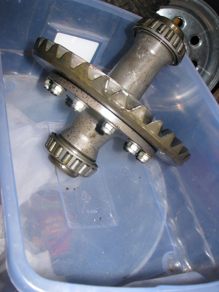

    Also know someone with this old ford diff. Is this anything worth latching up? Is this carrier too small? 6a.jpg

    That is a 33/4 rear axle and is used by some to replace the 32 due to the change in the R&P setup and other changes. Most folks go with the 37/40 due to the availability of 3:54 gears. What's it worth depend on your needs. I sold one for $250 last year at the LARS.

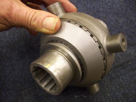

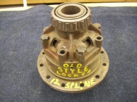

    The first thing you need to decide is if you need a limited slip differential or not. Let's ***ume you do.
    If price is your priority then you want an original Ford carrier with a locker conversion, 12 spline. Most guys feel they need to use 31 spline axles because that is used in newer rear ends. (Ford 9") I'm sure that there are advantages to the 31 spline, but if you look at the 12 spline you can see that it is plenty beefy. It is 1 3/8" dia. while the 31 measures 1.330".
    If I were you, I would pull one axle out and see what the inner spline count is. Then, depending on the final width desired, I would shorten one or both tubes. Use the brake and hub setup that you have. Probably wide 5, or 5 on 5". add a locker and go.
    We could get into a very in depth discussion about the various differentials here, but with cost being the big consideration, this is the least expensive way to go.

    Yes, the Ford open differential carrier should be the least expensive IF you can find one. That is a BIG 'IF'.
    The pictures in my last post are that Ford carrier with the No Spin Locker installed. This is the next least expensive unit. The piece in my hand is the locker.

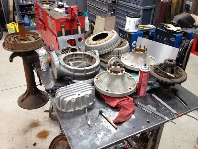

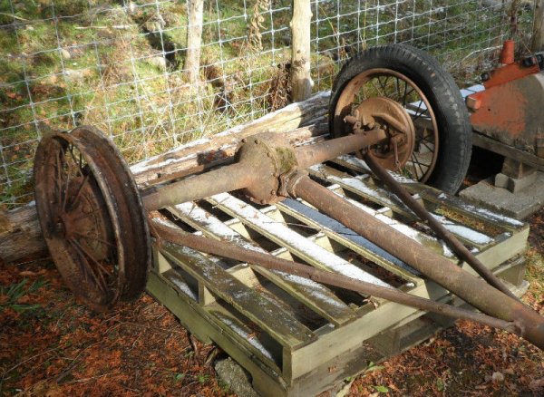

    Well, this Is what I got myself into.
    It is an old dirt track unit I bought and realized I bought some seriously used up parts. I think it was actually a pile of parts someone hung together enough to call it a rear end.
    It has flanged 12 spline axles, a welded Ford differential, one stock looking Ford bell and tube and one tube with the end that bolts on. The case has a repair that is cracked, you can see the rust below the tube from the hub bearing one one of the axles. The other hub did not have bearings. The backing plates are bent and one drum has a chunk missing from it and the other has been ripped off at one point.
    I could go on but figure you would get board reading that much.
    I have rounded up some parts for it, I bought some great original Frankland wide five brake drums and managed to pick up another set of the Buick style already cut for the wide five hubs. I bought some aluminum bells and a new yoke from a guy in NJ so I can get some replacement tubes. The tubes I have have had so many things welded to them I just can't imagine them being straight.
    I want to stick with the drum brakes, they just look so damn cool. I got my hands on an original set of skeleton backing plates I am going to use and just got my new set of 1959 Buick shoes and wheel cylinders. I still need all of the springs and adjusters if someone knows a good place to get them.
    I want to put a more modern locking or limited slip differential in it but I have a question about the axles.
    This unit had the Ford flanged axles, can I buy a set of 8 hole splined drive hubs and use those on my early wide five hubs? I figure that was the evolution of these but like many out there I have never touched one until I bought one.
    Actually having one to tear apart and learn as much as I have is the only way I can justify what I paid for this unit. Not to mention driving a seven hour round trip to get it. They are not easy to find here in the Pacific NW, well for me anyways.
    For those of us not raised around the track and too young to have lived through the "traditional" years it can be a long learning process. These informative threads are priceless, I hope that somehow p*** on a tidbit myself.
    I still have a differential, bearings, seals, hub nuts, quick change gears and tubes to buy so I am a ways out from putting this together. This thing is bleeding my hot rod fund out at a rapid rate. I actually think the only parts I will end using is the center section, rear cover and hubs.

    I've bought a pig in a poke a time or two myself. Sounds like you have a pretty good handle on it, though.
    To answer your questions:
    There were 12 spline lockers made for this rear end. They came in two varieties, one was a unit that would drop into the carrier you have and the other was an iron carrier with the locker unit. The self contained one is a newer style but both will work fine. There is no reason to change to double splined axles unless you need to change the overall width of the rear end. This will save you money. The splined drive plates will bolt on your hubs.
    You didn't say where the crack is, but I would guess it is in the pinion nose bearing support. These can be fixed, but unless it is done right, they will crack again. The trick isn't in the welding, but in re-machining the bearing bore. I have seen these run cracked for years. If you do it this way, use green Lock***e to hold the bearing in place. BTW, a recommended upgrade is to replace the ball bearing with a roller.
    I don't see a pinion in your picture, but look for pitting in the root of the gear teeth.
    I have the pieces you need. Send me a private message and I'll help you.

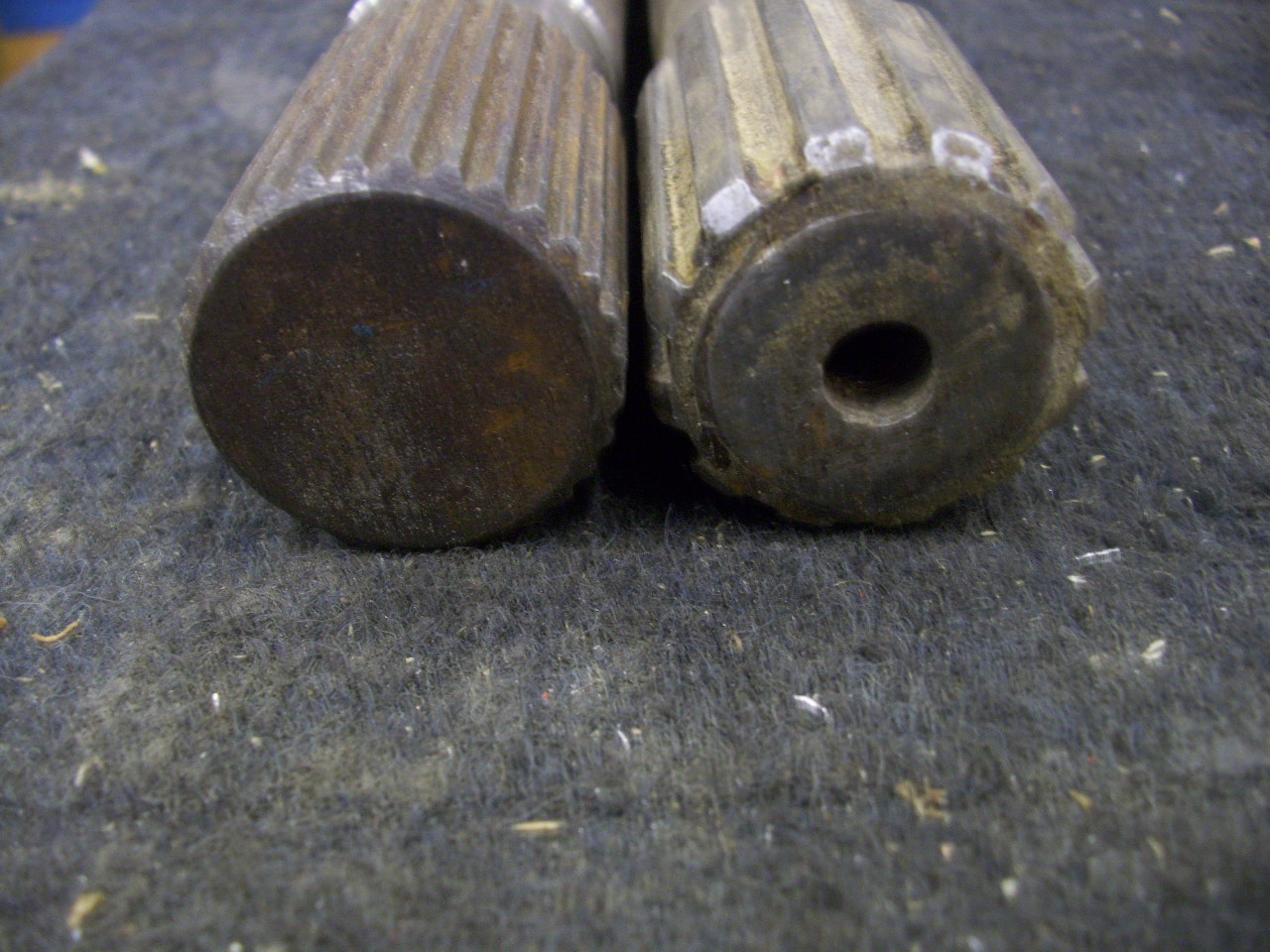

    My axles are part of my "pig" I bought, in fact I may name it that, ha. They are two different lengths and one has the first 1/2" of the splines stripped off. So I am thinking I may be at the cross road of making a choice to use the old 12 spline or update to a more modern diff with double splined axles.
