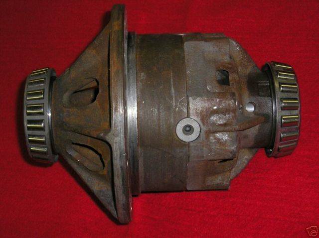

    Blackout,
    When you say, "will not fit in the early housing," does that mean the V8 carrier?
  2. blackout78666
    Joined: Jul 3, 2009
    Posts: 582
    blackout78666
    Yessir. The 3/4 ton 12 spline as well as the 31 spline drop in replacement for the 3/4 ton ford carrier will NOT interchange with the smaller v8 carrier that would come stock in an early banjo rear as a " drop in" swap. Not saying you couldn't do it without a bunch of machining, but I'm on the warpath, hunt for a true 28 spline drop in , no mods needed for the early v8 banjo open differential. For use with the halibrand 201, rodsville, or early banjo with modified axles and axle flanges. Have some parts on the way. Will update as soon as I get em.

    I hope you find that elusive V8 gear.
    I am more interested in a 28 spline side gear that will fit the 3/4 ton carrier. For most hot rods a 28 spline axle would be sufficient in a Champ size Quickchange. If guy was on a budget, he may be able to find a 3/4 ton carrier, upgrade it with 28 spline side gears and get two readily available junkyard axles.

    If converting a ford 9" from 28 to 31 is a matter of switching the side gears, ( and releaving for the bigger axle), that would make one think the 28 spline and 31 spine share the same machined diameter. Waiting for " blackout" to get his 28 spline side gears in that he ordered, wondering if they will fit in the 3/4 ton F2 carrier.

    On the four I measured: 28 spline side [16 tooth] gears locating dia. measure 1.745/1.747..Dia of face is 2.930.., over the teeth is 3.295..I believe that if you trim the 28/31 side gears close to the 2.930 dia. of the face [as simple as a belt sander like in pic of post #179 by B'duece] it will fit in a banjo [p***] rear carrier 1938 or so up..The difference of the the dia. of the 28 and 31 splines was/is about .110 more for the 31 so was not [I don't think] necessary for any other change in gears, I dug for an hour and couldn't find any 31 spline gears..Gremlins.. Just a note, 28 spline axles can be made into 31's when shortened as long as they can be turned to 1.335/1.340 dia..

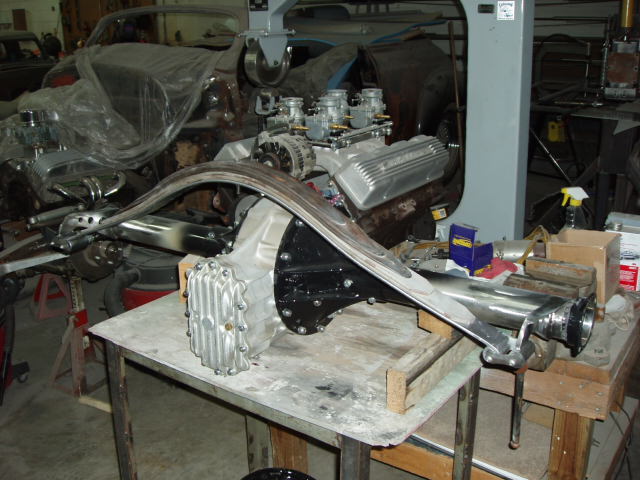

    I like the look of the truck bells. built this 301 for a 6 carb Caddilac rod I'm going to build. got this far and I didn't want the A spring into the trunk. Sold it. It went to Australia. Picture226 301 001.jpg Trans sprint 039.jpg Picture226 301 001.jpg went to Australia.

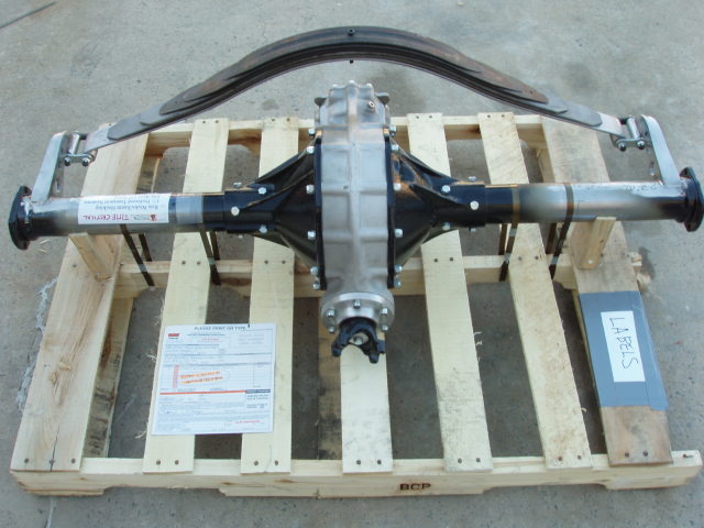

    This is the 301 I now have for my 6 carb Caddilac rod. 4 rib Winters bells. Cleanest set up of all. Now going to use coil-overs. Don't buy 4 rib bells used. They are almost always bent. 3-26-2015 005.JPG 3-26-2015 006.JPG 3-26-2015 007.JPG

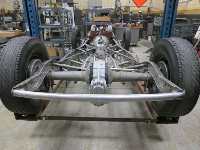

    I sold 3 sets of H852A side plates because I had no use for them but I did use a 4th pair on a supermodified I am building because thats the way most supers were done in California before the open tube rears took over. #72   #45jr  backers 013.JPG done in California before the open tube rears took over.

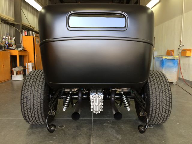

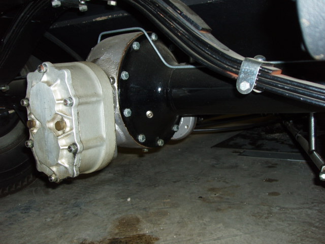

    Yes, Brizio uses them often with high hp engines. They do diminish the size somewhat. Pete builds whatever the customer wants or has possession of at the time. The 8 rib bells belong in race cars in my opinion but again if the price is right many people install them.
    Here is one going together at Roy's with the 4 rib side bells. I have seen the finished car and it looks perfect under the Deuce.
    I still prefer the 40 axle tubes with the Winters or Halibrand as it is the way I built them in the 60's.
    Here the Champ with 40 axle tubes and CAE side plates under my 33 roadster. Using the rear mounted tank almost hides the unit but I like the look. Do you have any of these CAE side plates in inventory? Bruce has one but I have never seen another one.

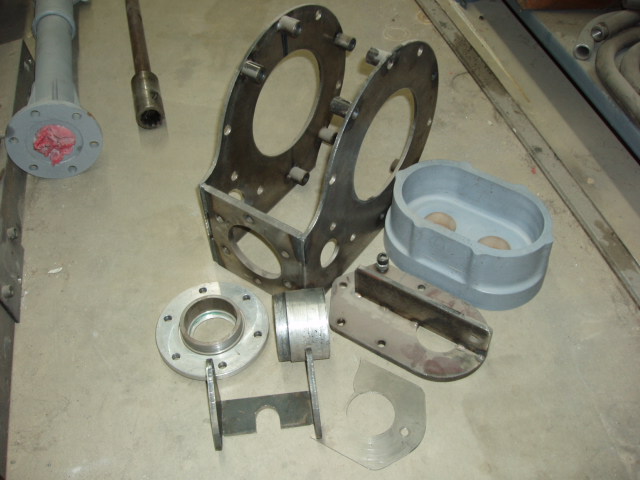

    Yes, that combination will work. You are right abut the price. The side plates are about $300 ea. and the differential is close to a grand. If you saw my post for tech week about the Halibrand/Winters hybrid I show how to make adaptors to use a conventional differential instead of the special Winters unit.
    I just finished doing the same thing using a Winters center and a Gold Track differential. The customer supplied the diff and side plates. I made the adaptors and machined the Gold Track.

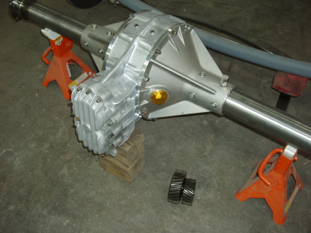

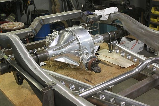

    Here is some more photos for comparison.
    Early 301/CAE with 40 axle tubes.
    Late Halibrand with new side adapters. Very popular in the 80's-90's under Deuces and Model 40's. I would like to find some of these adapters.
    DPI machined for 301 with Halibrand side plates.
    3/4 ton differential with 12 spline side gears. Stock
    Halibrand under a Deuce RPU. Looks fine to me.

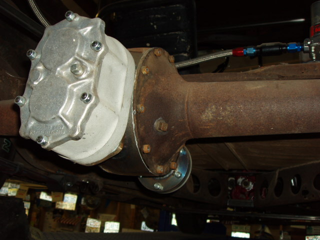

    A Champ under a Deuce sedan without the gas tank.
    Scott added the Big Champ under his sedan for the look he wanted. The EF axle tubes disappear when painted black. The tank will hide much of the bulkiness. The Winter V8 requires no notching of the tank.

    Okay, I got the 28 spline side gear from Frames. It is a drop in my 3/4 ton original differential. Now to find out if they are available individually. Blackout, did you get your kit?

    Yes I got mine. 28 spline drop in to a 3/4 ton carrier. Not so to the smaller 39-48 differentials without extensive machining. ImageUploadedByH.A.M.B.1450948255.515148.jpg ImageUploadedByH.A.M.B.1450948271.647974.jpg ImageUploadedByH.A.M.B.1450948288.432243.jpg
    So these Will NOT fit as a drop in to a 201 style ear ly halibrand using a stock open diff. Will DROP IN to a 3/4 ton open diff. I will follow up with a part # later. So for the 3/4 ton carriers there is an off the shelf 31 and 28 spline side gear conversion. Thanks again QCE for the suggestion and Frames as well. And you too Big duece. Now for the elusive small carrier 28 spline drop in. I know your out there!!!!!
