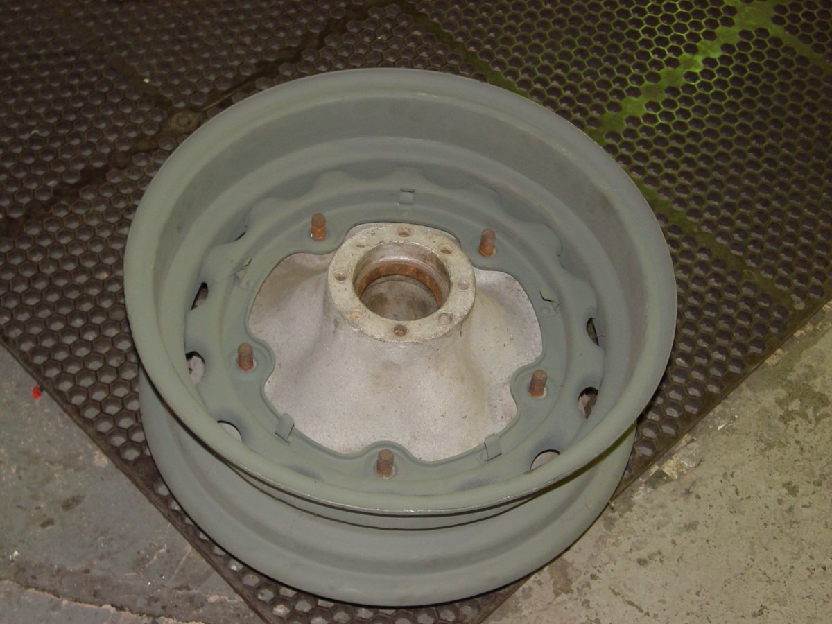

    I do not have a picture off the wheel. It was used on sprinters and some late models
    in the sixties It is a wide five with an oval looking spoke emerging from between the
    lug nut area. Hard to describe but are seen on some vintage racers etc.
    Cool looking wheel I think.

    I don't think you are describing the wheel but the hub the wheel bolted to..

    I have hubs like you are showing. I am thinking that may be an original ford wheel?

    You may be correct, although I will see if I can find a shot of them that may show the wheels clearly.
    Thanks for the reply.

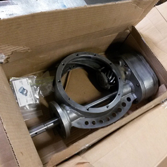

    Now accepting orders for Halibrand style side plate adaptors. PM me for ordering info.
    Thanx,
    Bruce

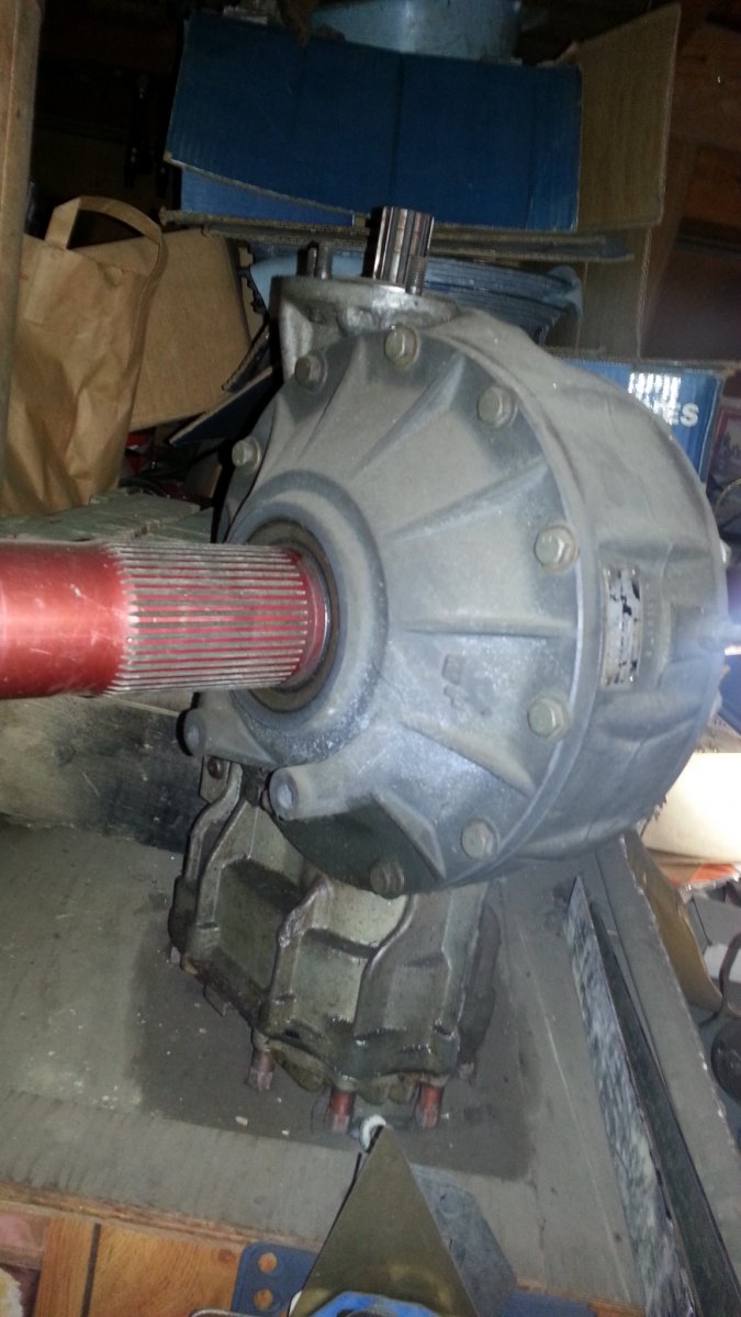

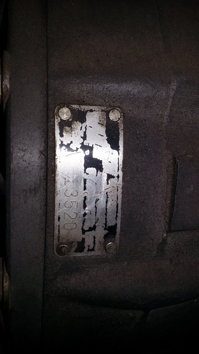

    I have this one out of a sprint car.
    Is this worth the work to convert to put under my car? 20160302_095612.jpg 20160302_095639.jpg

    Alliance Vendor
    Sure, especially if the Ring & Pinion are still good. I don't know what the live axle is worth but they are pricey when purchased new.

    The ring and pinion are good.
    Just wondering about converting it to the axle tubes with the grand national style ends for the wide 5 hubs and a locker diff.

    It can all work. You need side plates, differential, axle tubes w/ snouts and axles. I can help.

    I have a live axle like that but it has a split lower shaft that shifts it in and out. Is it usable?

    Yes you can do one of two things change the lower shaft or just lock the shifter in with a lock plate I done that on the halibrand that I run in our land speed car

    Seriously, I wouldn't hesitate to put 800+ HP through one. But, I would be careful in drag racing with one. With an automatic, where you can preload the driveline, no problem. With a clutch, the shock load will eventually fatigue something. The V8 units were used extensively in the 60's in dragsters. These 3/4 ton units have to be at least twice as strong.
    Tommy Ivo put two Buicks through one. Actually, 4 Buicks through two.
    In the end, it's not about the HP number. It's about the amount of torque that can be instantaneously applied and the amount of traction available.

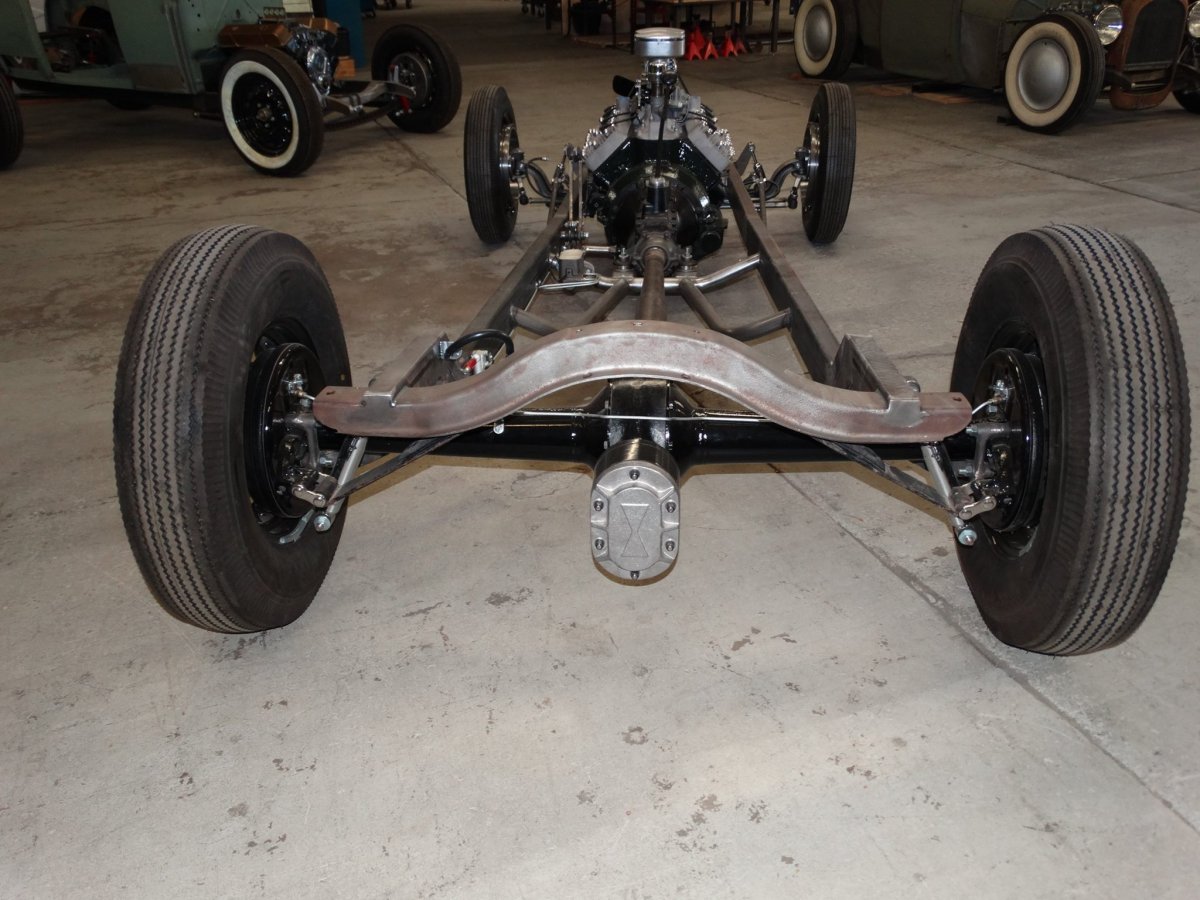

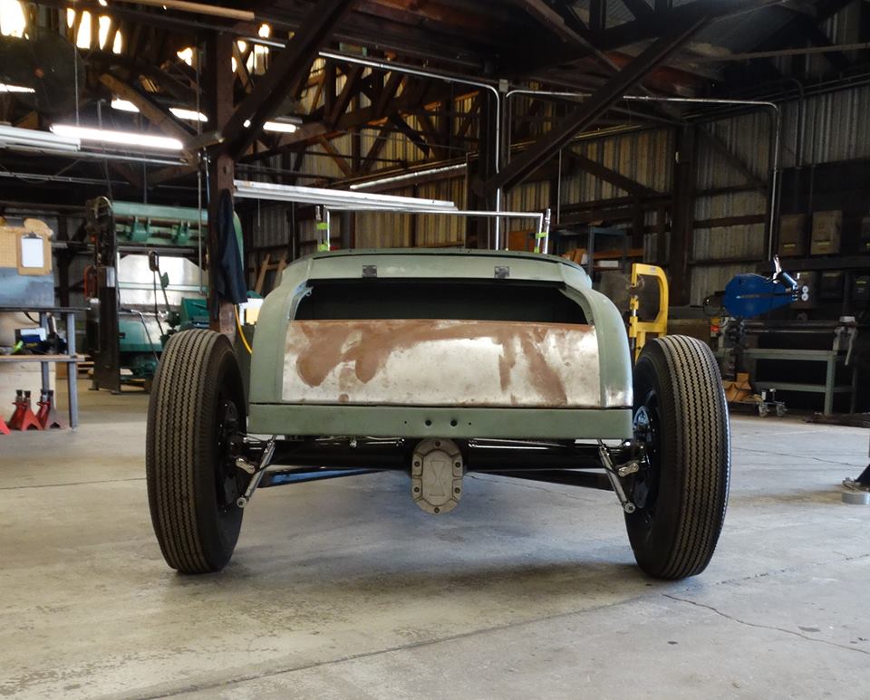

  28. Just found this thread, I notice that Mike @bone31 made mention of his QC that he makes and it didn't get too much attention. Just thought I would share the link to my build thread starting at the point where Mike hijacks it to build the center section. That way you don't have to read all the fluff about my car. ;) He does beautiful work and I think it deserves notice. Start here: http://www.jalopyjournal.com/forum/...flathead-powered-car-t-roadster.954035/page-3
    10450928_10206078958680011_5164356711397003059_n.jpg 12240453_951674131579485_3531896928465834140_o.jpg 10360844_1013286622084902_8311555375885076777_n.jpg
    51 mercules, Lil'Alb, Tim and 3 others like this.
