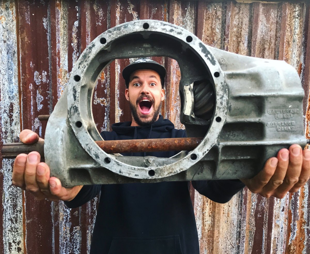

  1. Hey guys, sorry to start a new thread based on something that has been covered a million times on here, and will delete if needed. Ive looked through a few different threads but haven't found much.
    I just acquired a Halibrand 201 quick change for my '40 Ford rear end,
    Now this QC doesn't have a ring gear or rear gears aswell.
    I plan on running a mild hopup Flathead and a '39 Ford toploader.
    16'' wide fives and 7.50 rear tires
    From experience what would you guys recommend for gears to run that would be nice for hwy use but still have a bit of guts of the line?
    Thanks very much guys.
