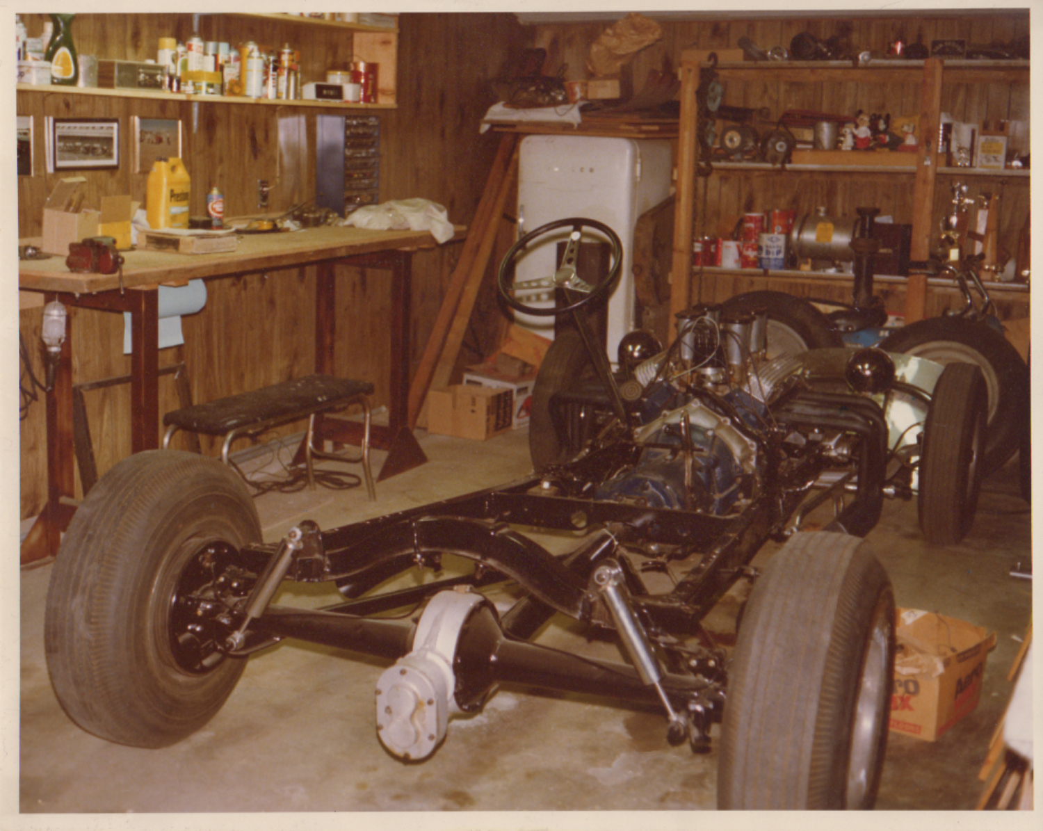

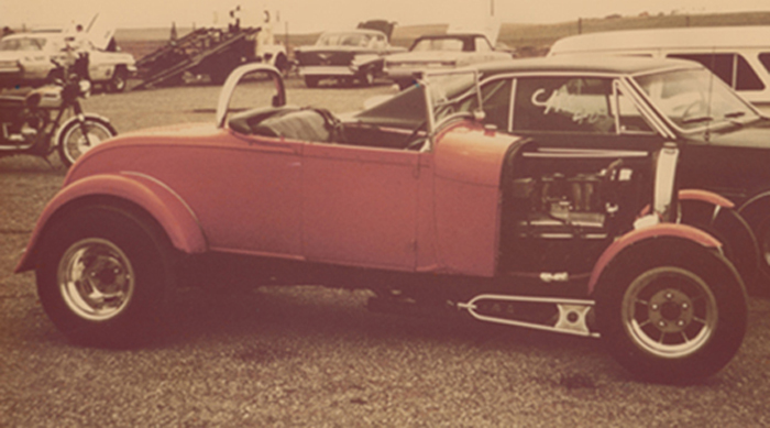

    A hundred years ago (maybe 59+) I borrowed a set of 4.44 gears for the V-8 Cyclone in my roadster to go drag racing. Made one run and broke the rear plate. Learned that the A gears were 1/2-inch(?) wide, the V-8s were 3/4-inch?) wide.
    Whatever you do, make sure your pieces are in harmony.
    (Also learned that Cyclone probably had a teenager hand-drilling the rear plate. So, I had to match it up myself. Maybe that's why the studs showed threads out the sides of the housing.)
