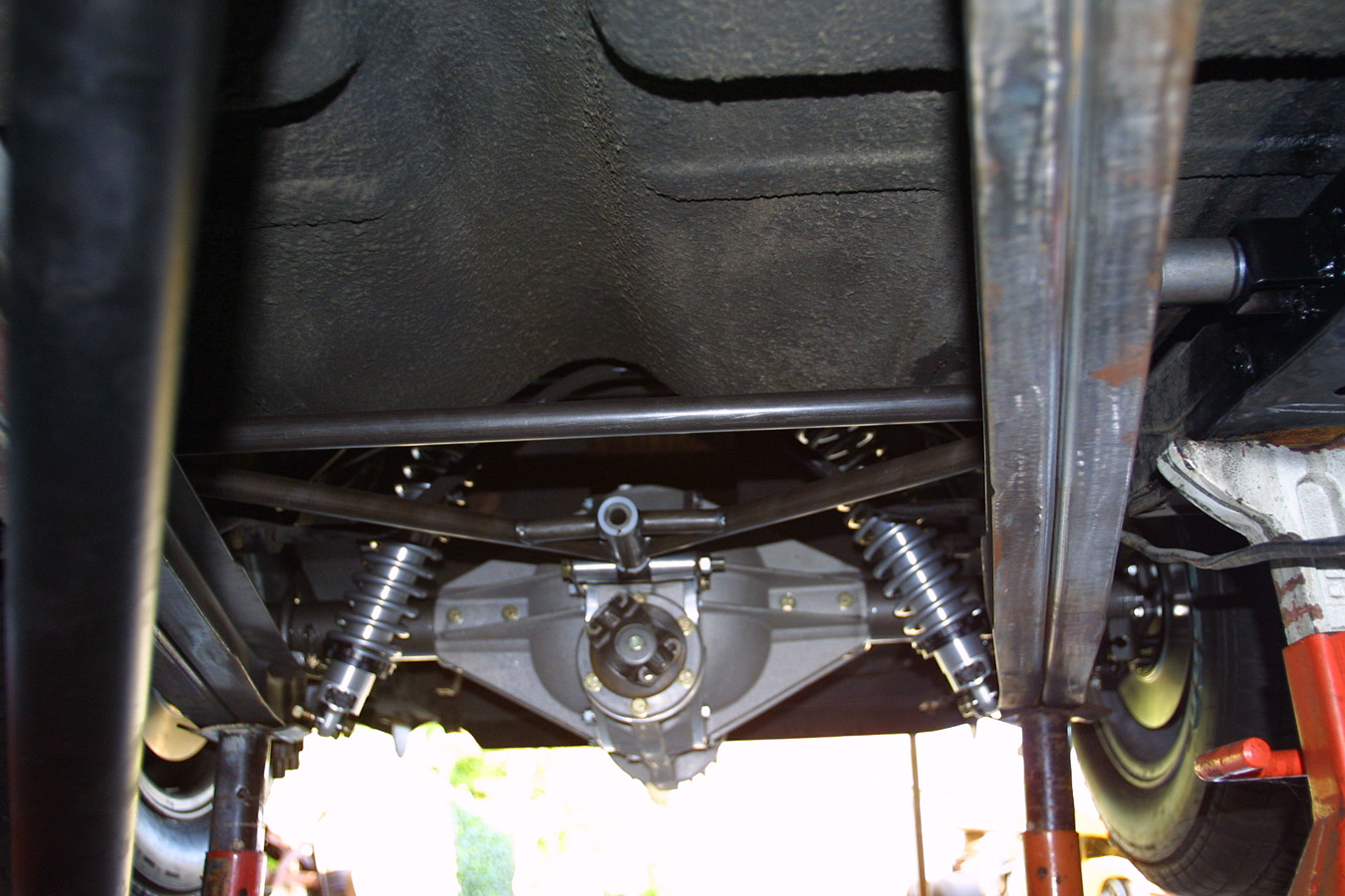

    Do you have any other pics of how you anchored that wishbone to the snout? I'd love to run one in my 4 linked falcon on the street, but:
    A. Dont know how streetable a wishbone is
    B. Dont know how to mount to the front retainer
    I've seen the top mounts for circle trackers to mount pull bars, but those are different forces than a wishbone. What did you use?
    -rick

    Rick -
    No, no detail shots of the wishbone to frame pictures.
    A. As long as the wishbone is firmly braced, as mine is (store bought), I feel VERY safe with it. I've done some hard cornering with it, with no problems, noises, or other concerns.
    B. Front retainer ? Don't understand the question.
    C. Here's the slider mount. I have aluminum spacers to take up the extra space between the rod end and the bracket.
    Hope these help some.
    Mike
    69fury likes this.
  23. 69fury
    Joined: Feb 24, 2009
    Posts: 1,734
    69fury
    from Topeka
    Thanks!
    A. Do you remember what company you bought it from?
    B. I was referring to the front bearing plate, as i've seen panhard mounts incorporated (which wont clear my 4 link) and I thought your slider mount bolted to that plate.
    C. My quicky came with 2 side plates just like your-except in softer aluminum because they pointed up and only had a tension load from a pull bar with a spring, and didn't see side loads.
    This is really helpful. I'd love to figure out how to run a Watts in with the 4 link but a wishbone is my next best thing i think. Its a g***er going back on the street- so 75mpg Highway curves and slower turns while cruising the square is the only cornering it will see. No slaloms for her at all.
    thanks again,
    -rick
