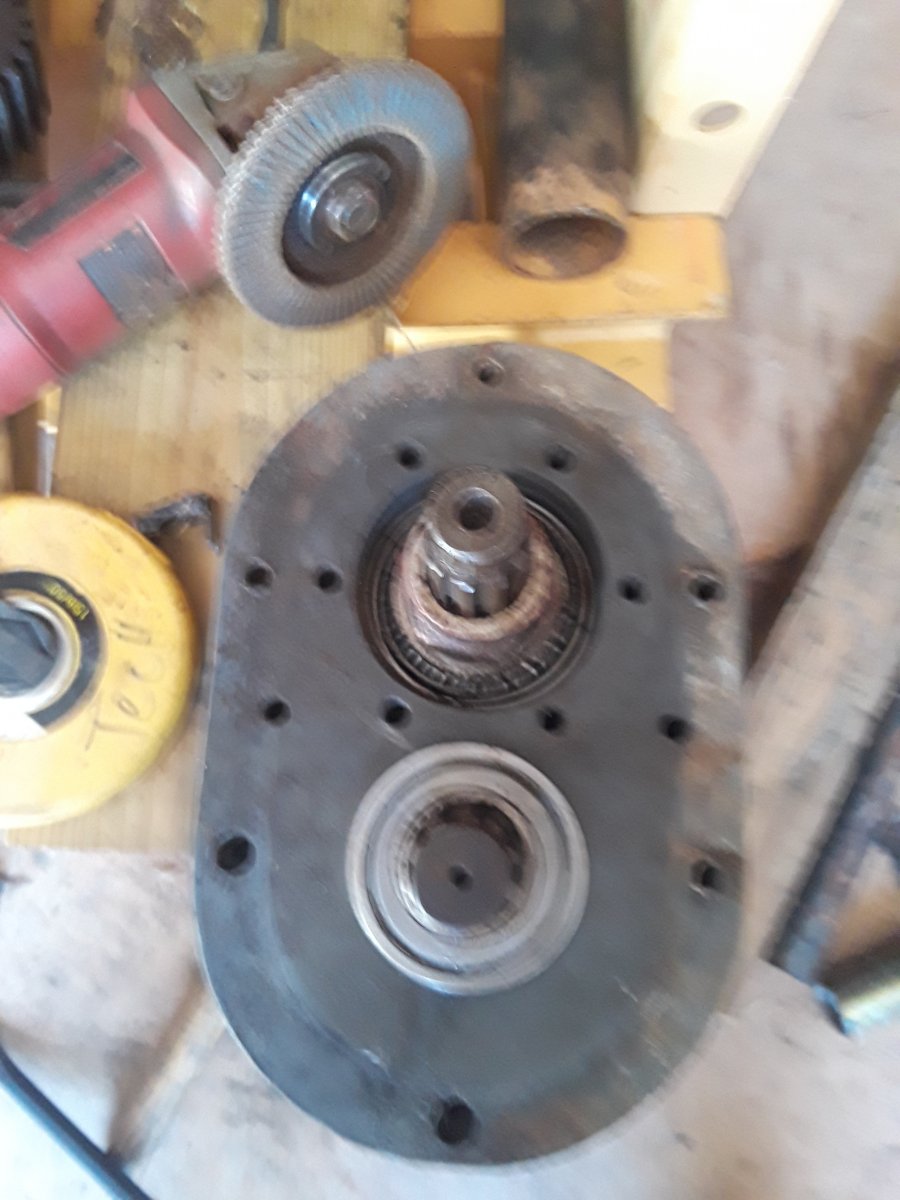

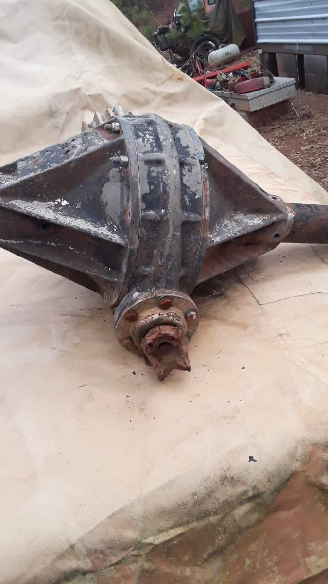

    Hey guys , need a little help please . I picked up an old jones magnesium quick change , I really would like to set it up under my coupe for the street. I've read someplace , which I cant find again , about using a 9 inch carrier in the quick change. Any info or just a direction pointed in would be really appreciated. Thanks for any and all help in advance.

    Sorry, I couldn't take the time to respond before. Very simply, no 9" parts fit a Quickchange. Most of the late model stuff do use 31 spline axles which are interchangeable with Ford 31 spline.
    The thread @Barrelnose pickup referred to is 'Quick Change Quickchange'.
    Post pics of your Jones QC. The bells and rear cover can be a bit unique.

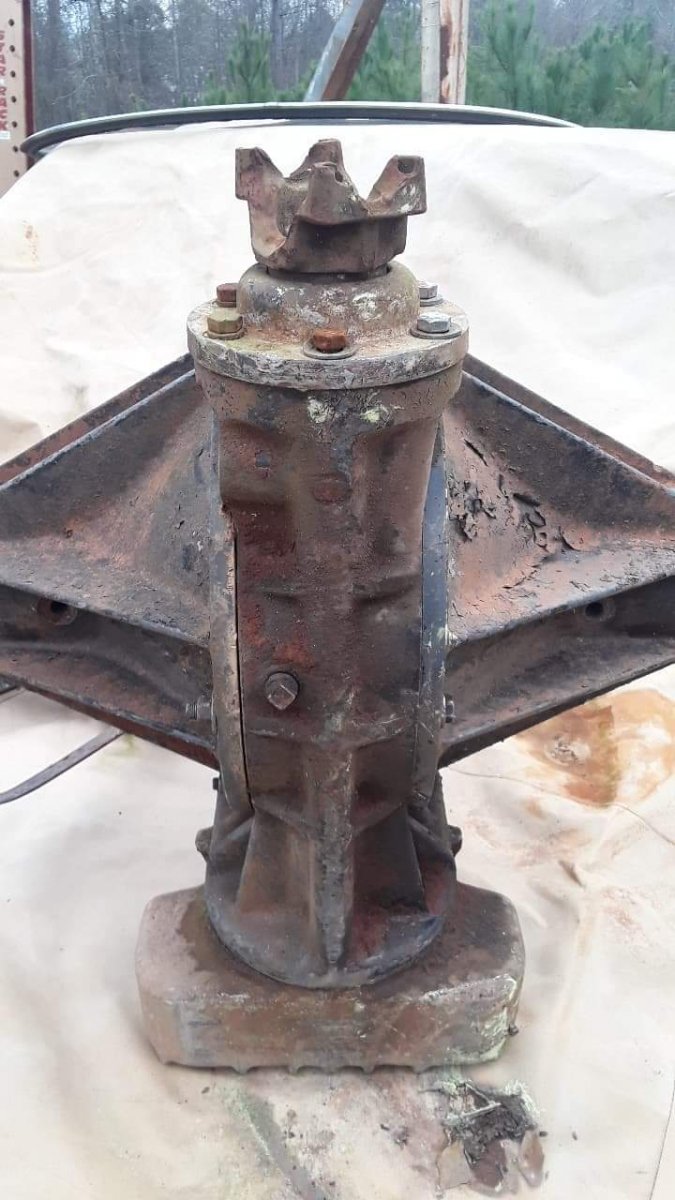

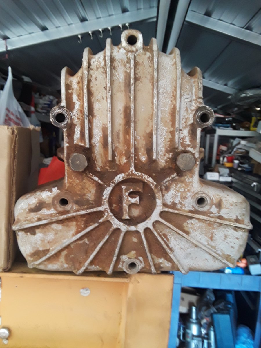

    received_838346783352634.jpeg received_838346783352634.jpeg received_276484356672763.jpeg received_217832006261440.jpeg received_217832006261440.jpeg received_217832006261440.jpeg

  8. GearheadsQCE
    Joined: Mar 23, 2011
    Posts: 3,670
    GearheadsQCE
    Alliance Vendor
    Drifter,
    I was thinking it may have been a flat bottom Jones. Like this:
    Anyway, I'm not sure that the side bells are Jones, but they could be. What I am sure of, is that they are on the wrong sides. The area between the fins on top are actually a pocket for additional gear lube. They should be on the bottom. Not sure if that rear cover is a Jones or not. Looks like a Frankland Supercover from the angle you posted.
    That rear can be made to work very nicely in your coupe.
    If you are looking for direction on where to start, remove the rear cover and drain any remaining gear lube.
    I find it easiest to do by putting the whole ***embly on jack stands and putting a drain pan under it.
    Then remove the left side bell.
    You can't hurt anything and it doesn't upset any settings. Word of caution: don't wedge a screwdriver between the bell and center.
    Now you can remove the carrier with ring gear.
    Take pictures and post them. We'll go from there.
    Please show the rear cover from the back, too.
    Bruce

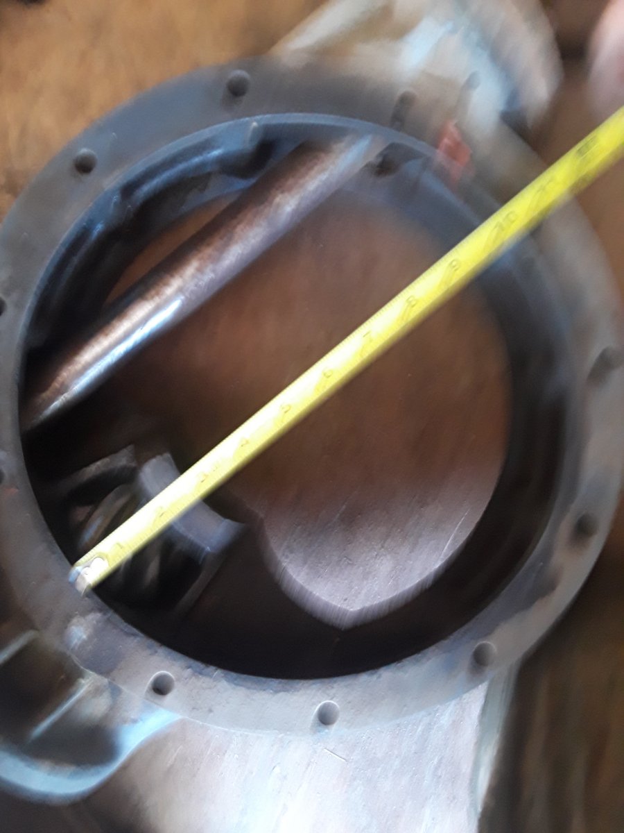

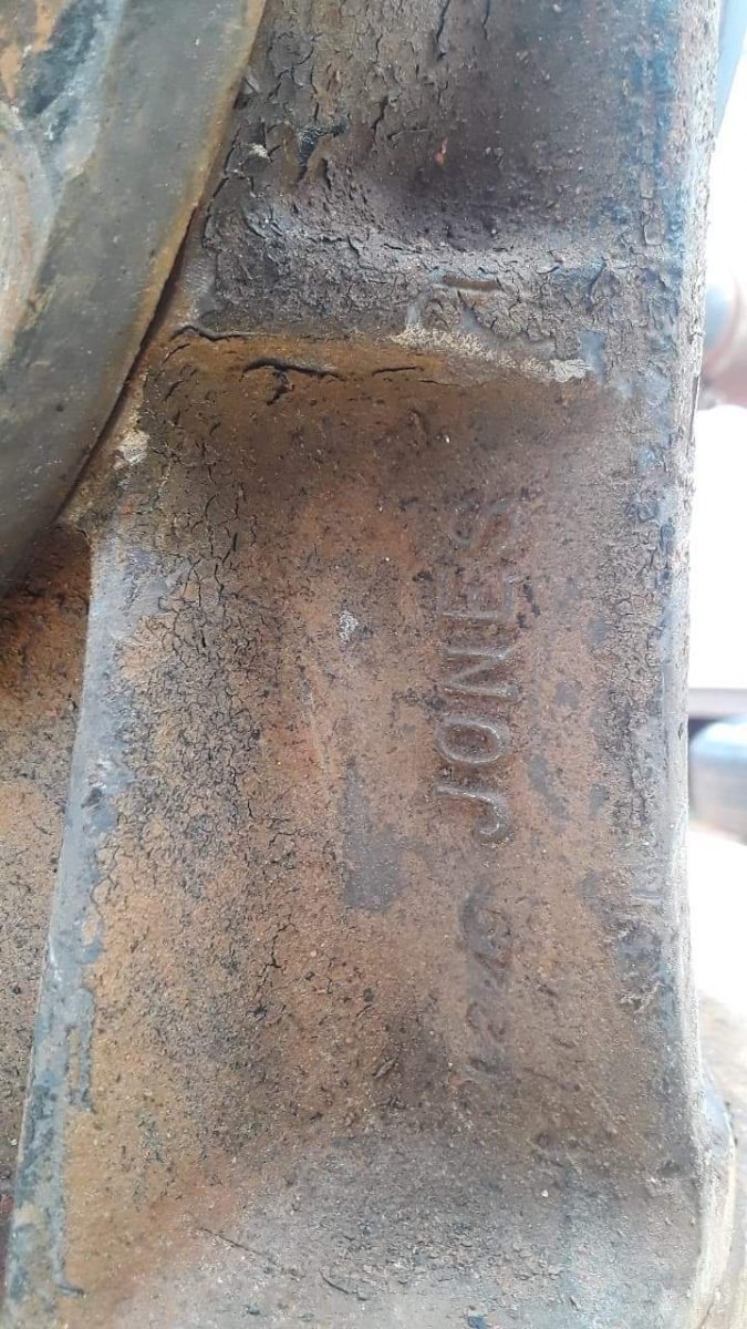

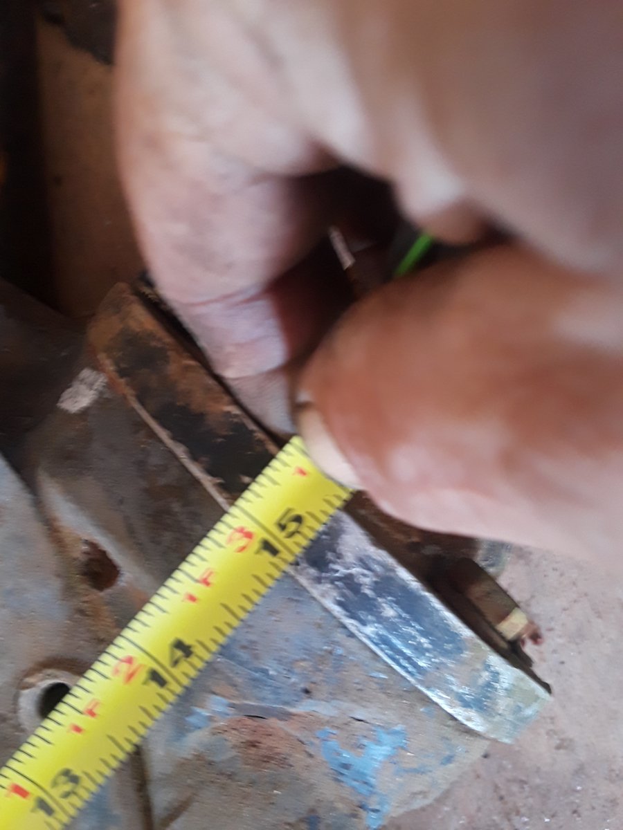

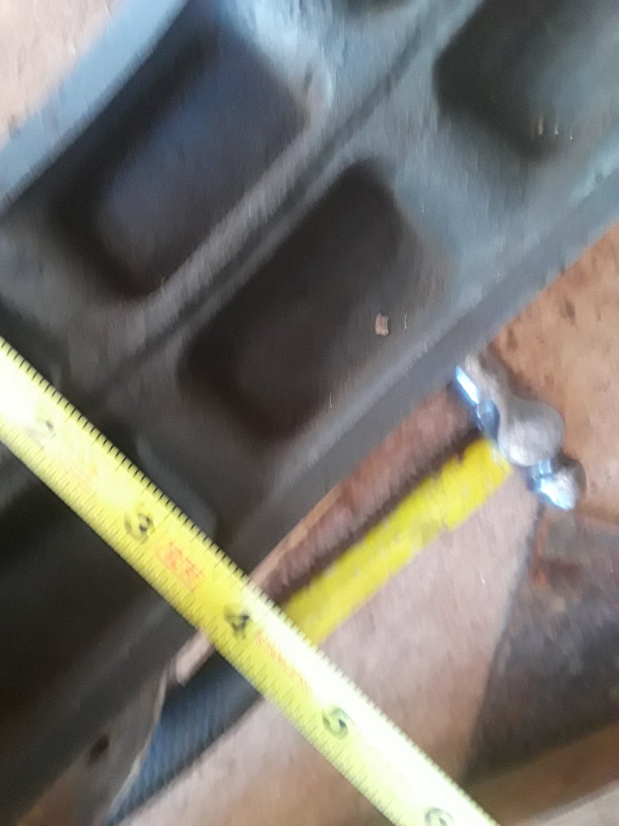

    Hey doctor satan , thanks for the responce , I did pull it apart a little while ago , the bells are jones , they were still lose just bolted on rag tag. No carrier to speak of. But lower shaft is intact and pinion is intact. Yes it has a franklin cover on the back , wich I really dig. Lol stupid I know but still think it's cool. So I measured the thickness of the center without bells on it. 3 3/4 , tried to research a bit and man i got nothing. I really am not sure if it's worth my time and money to build, or just swap for a newer unit a d keep moving along with my project. Any input would be greatly appreciated. Thanks Mike

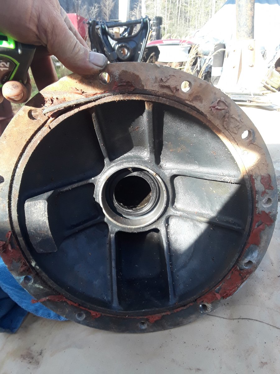

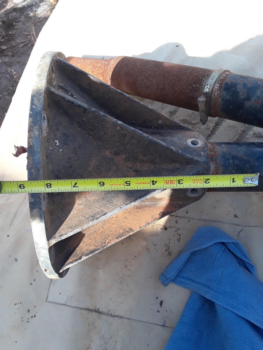

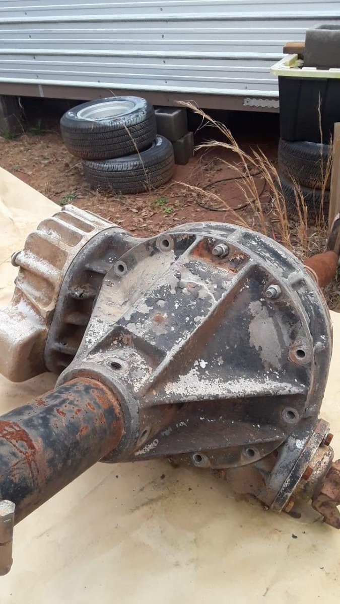

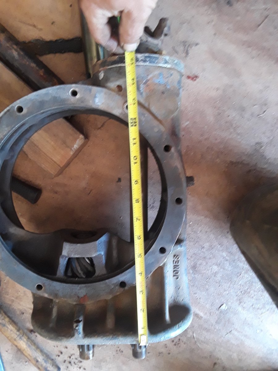

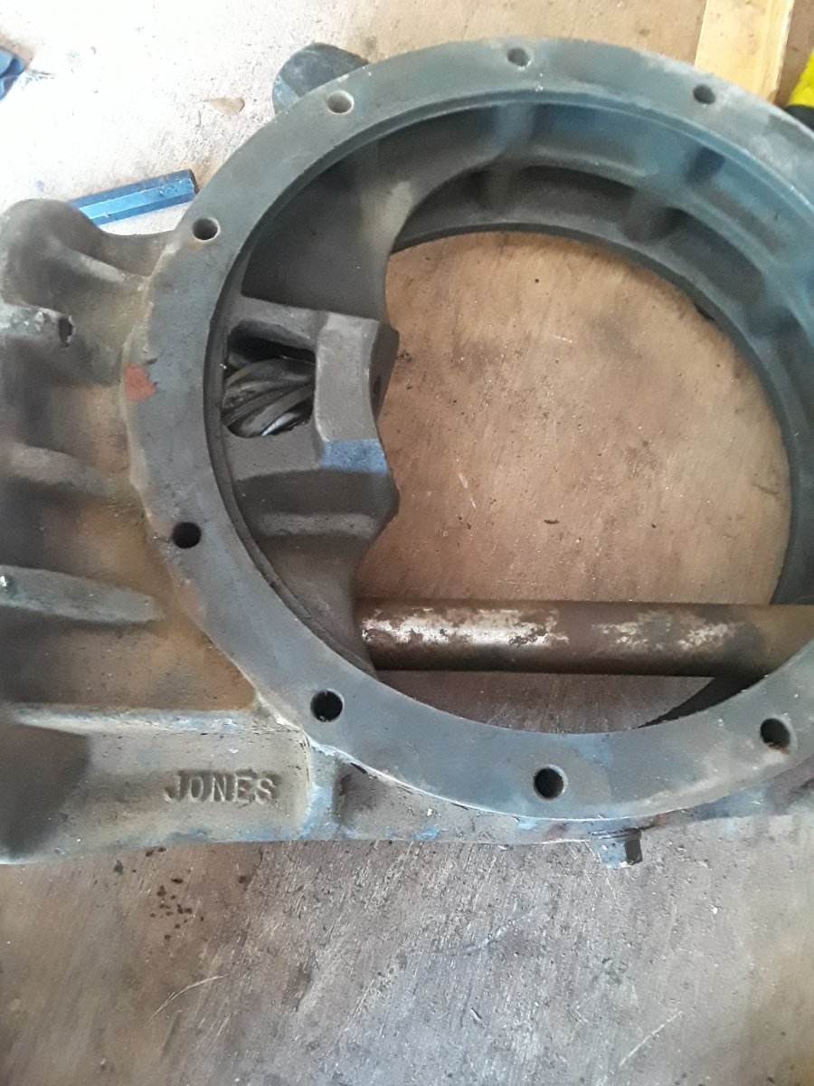

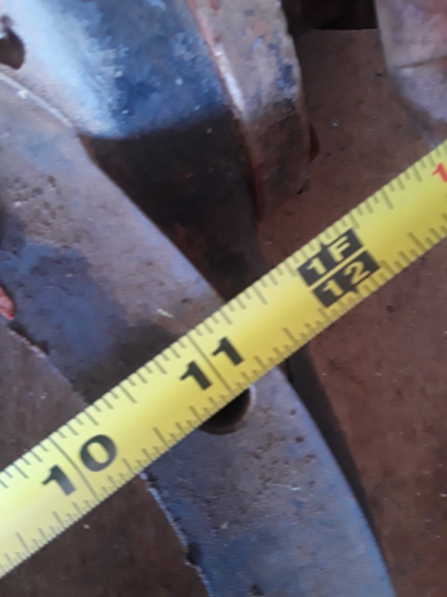

    20200321_171818.jpg 20200321_171824.jpg 20200321_171740.jpg 20200321_171740.jpg 20200321_171626.jpg 20200321_171457.jpg Doctor satan , this is what I have , 20200321_171825.jpg 20200321_172110.jpg

  13. oldtom69
    Joined: Dec 6, 2009
    Posts: 583
    oldtom69
    from grandin nd
    looks like a direct Franklin copy-didn't see which axle snouts you have on those tubes,that could affect your decision money wise.You said there was no ring gear or carrier?GearheadsQCE will have everything you need

    Oldtom69 , hey thanks for chiming in , I have both , bells is what I've been calling them . They are jones , 1 is in need of a bolt hole repair. But as far as I have seen that's it , also the housing in the rear , they used a bolt to long on the rear cover and it came through the magnesium. Honestly I was going to shave both sides to match. Such a small thing seems stupid to worry about making perfect. I just found a franklin carrier online , waiting for the guy to get back to me , after that just ring gear ( not sure what tooth ) are they a standard gear everyone uses ? And axle tube conversion for 9 inch axles . The rest of the parts I have , I think.
  15. flamedabone
    Joined: Aug 3, 2001
    Posts: 5,753
    flamedabone
    That is a Jones magnesium quick change, which shares most parts with Frankland, Winters, etc. Parts aren't too hard to find and it is not too hard to ***emble. Going together, they look like this:

  17. oldtom69
    Joined: Dec 6, 2009
    Posts: 583
    oldtom69
    from grandin nd
    4:11 and 4:86 are the common ring and pinion ratios.Ring and pinion are actually just copys of 1939 to about 1952 3/4 ton Ford and others [Stude etc] If you wanted an open[non-posi] rear you could use a stock 3/4 ton carrier,but it give you an odd 12 spline axle spline.Locked spool is the most common ring gear carrier to find,but I wouldn't recommend it for the street!Flamedabone has the nice [$] setup and he has the non-floater axle ends on his tubes.Ebay can be your friend here,but beware!Again Gearheads can help with parts and walking you through the ***embly

  18. oldtom69
    Joined: Dec 6, 2009
    Posts: 583
    oldtom69
    from grandin nd
    P.S.-your rear cover is what Franklin used to call the"super speedway" cover with the extra side pockets for more lube-a regular oval cover will fit depending on what look you want

  21. GearheadsQCE
    Posts: 3,670
    GearheadsQCE
    Alliance Vendor
    What Abone showed you is known a Gold Track. There were several manufacturers that made that style. I believe the only new ones now are Winters. They are offered on the auction site all the time.
    Nothing to worry about as far as parts availability. What you have is a pretty basic 3/4 ton Quickchange. Unfortunately, if you don't have the ring gear that matches that pinion you will have to replace them as a matched set.
    What you might want to do is take it completely apart and lay out all the pieces you have. I can tell you what is missing.
    The bearings are generally replaced but it is amazing how many are still good after many years of use. That stuff was way over engineered.
    If the axle tubes are not bent, you can cut them off and weld on late Ford housing ends. If they are bent you can get axle tubes with the housing ends already welded on.
    To get the pinion out, heat the case to about 350 degrees and it should fall out. (have to unbolt the pinion retainer first) Don't do this in your kitchen with the wife's oven. That was what I did on my first QC and she's still mad 37 years later. A grill works for this.

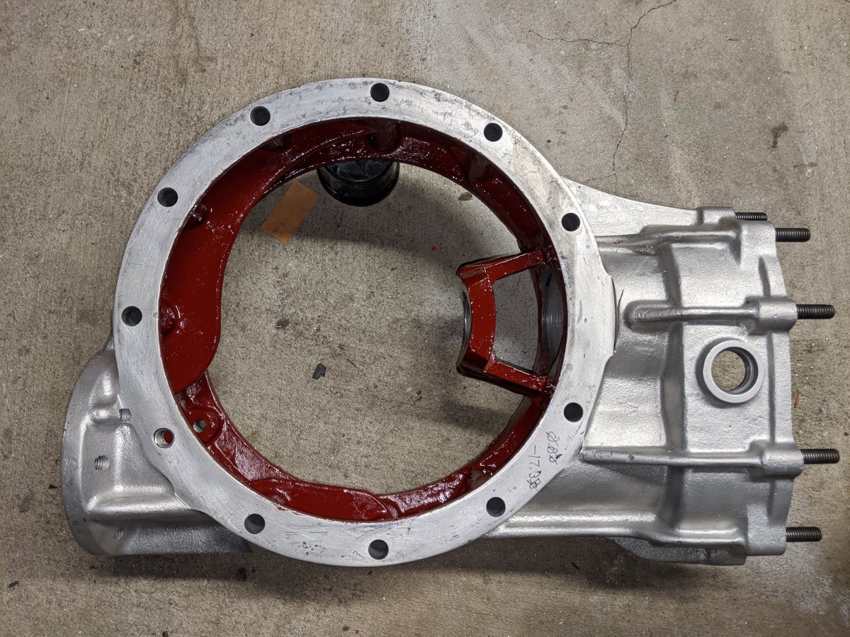

  22. gimpyshotrods
    Joined: May 20, 2009
    Posts: 24,513
    gimpyshotrods
    There is a healthy supply of used quickchange parts on eBay, for things like a limited slip differential.
    All else should be installed new. @GearheadsQCE can hook you up.
    BTW, magnesium bead-blasts really nicely.
    This one had thick rattle can black, over heavy oxide. Just mask off gasket and bearing surfaces well.
    JUST A NOTE: This center section has been intentionally modified, in case you are wondering why the appearance is a little "off". This has been set up to run backwards.
