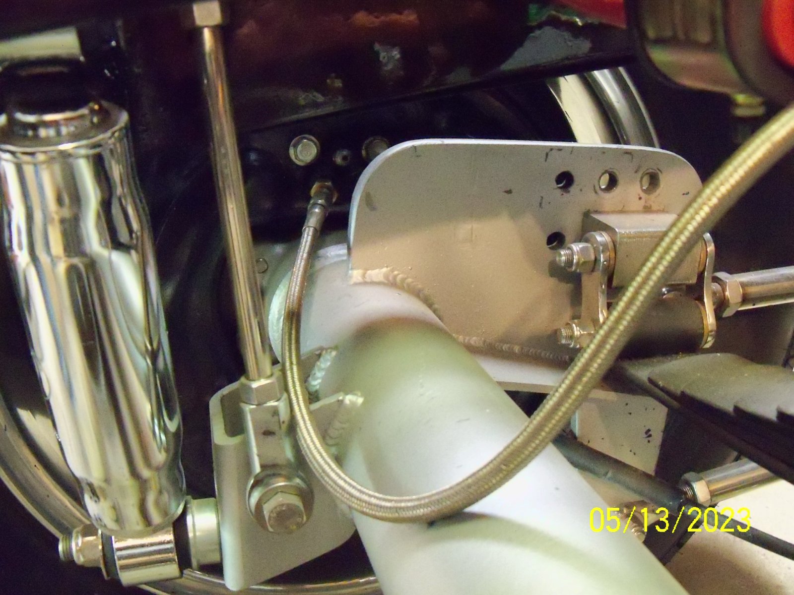

    I designed my Winters brackets so I could show off the quick change behind the spring. Works great, 100_1709.JPG 100_1711.JPG
    panhead_pete likes this.

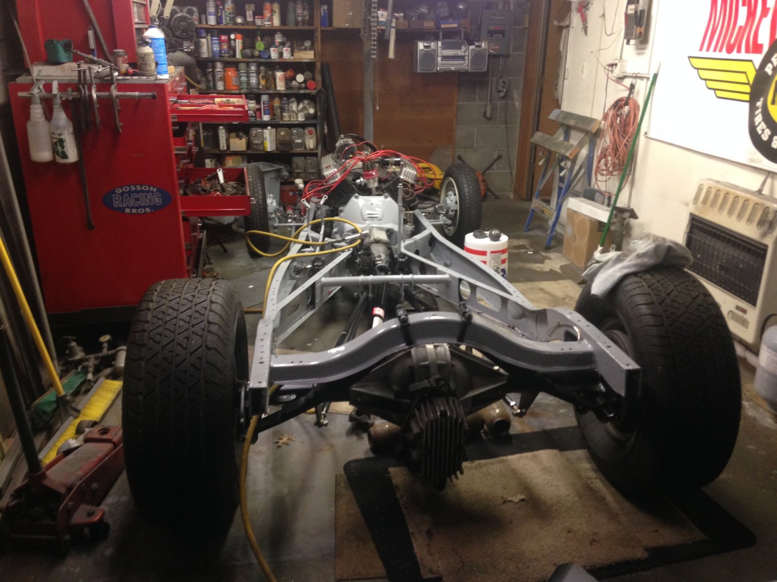

  9. This guy modified his 34 crossmember to use a model A center . Turning the U-bolts upside down [nuts on top] will get you a badly needed couple of inches. 34rearcrossmemberHAMB.jpg
    Tim, acme30 and lumpy 63 like this.

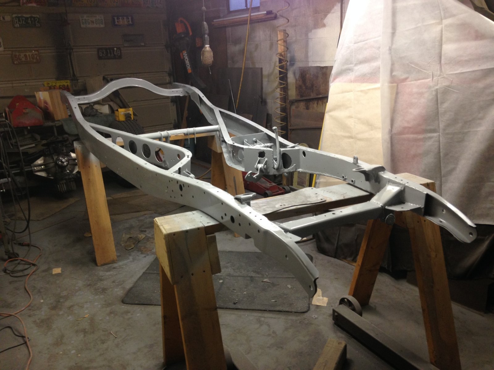

    IMG_1312.jpeg This is a So-Cal frame/crossmember/spring setup. They also put the hangers on the axle so they should be able to tell you what the correct positioning should be.

    @Bert Kollar cheers for the pics. What is that adjustible vertical rod directly the shock?

    Sway bar

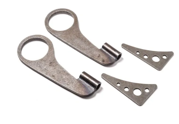

    I am also putting a Winters Q/C in my 34, I bought ladder bars and spring mounts from RJ's. He is a vendor here also, His stuff is very nice quality, good communication and overall a good guy to deal with

  15. What's going on here. It looks like your shocks are fully compressed and your spring is too wide for the distance between shackle mounts.

    i used those same brackets to hang a winters quick change under my roadster, i know they are advertised as being forged with no need for bracing but i added their forged braces also, there was a post here on the hamb about their tendency to flex without the brace.

    The rear is on a jack. The geometry was worked out with a pro frame builder. Havent bottomed out yet

    The forged hangers shown above are not the stock distance from axle center to spring center. I've done dozens of quick change rears with A springs and A rear cross members using the 35-40 rear spring hangers from P&J's combined with P&J ladder bars. If done correctly you will not need a panard bar. R-Jays brackets and ladder bars are the same as P&J's

    Silent Rick: Good looking installation. I have never seen the gussets offered, is that something new? I think the spring hangers are of excellent quality but my concern has been because they place the rear cross member closer to the rear end than the standard length hangers will the edge of the A cross member get to close to the rear end? Also if you study the deeper drop on the hanger compared to the P&J style hanger could the rear end travel be reduced?

    @silent rick where did you get those braces? Looks like a great idea.

    they're a socal speed shop product along with the spring hanger and matching ladder bar mount, all similar designed forgings. i looked for them on their site last night, saw the other two items but not the braces. i think i had to ask for them.
    as for not being the same dimension as a stock hanger, i centered my tire in the wheelwell opening and put the model A crossmember where it needed to be
