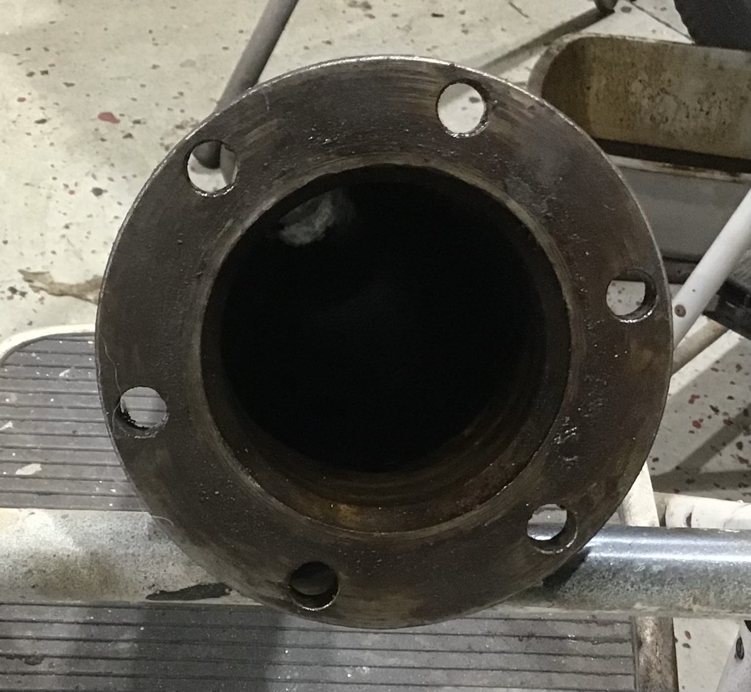

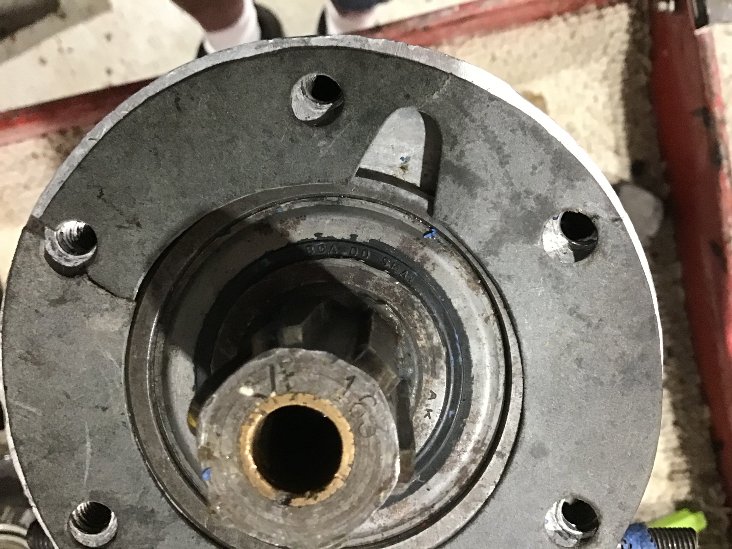

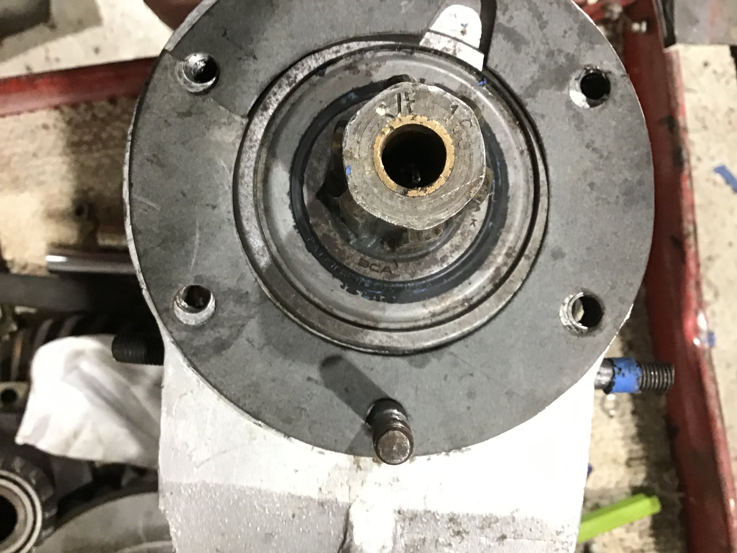

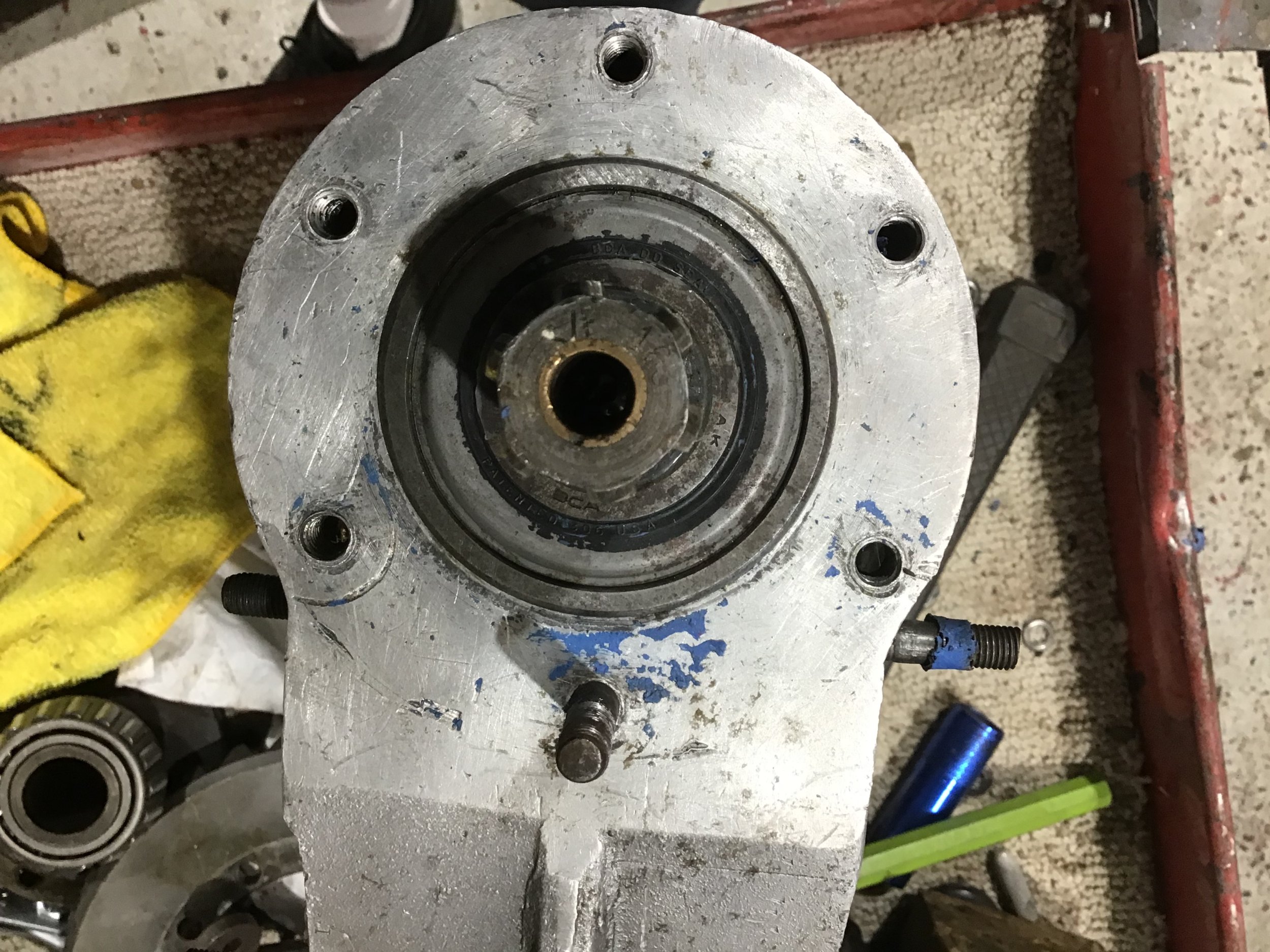

    I found a Hilabrand Quick change that my Model A bells fit but the torque tube stud holes do not match the Quick Change banjo. Does anyone know of a fix for this? Would a later model torque tube work?

    Halibrand quick changes for the model a have a torque tube bolt pattern smaller than the V8 and larger than the model a. Modify the A torque tube to fit.
