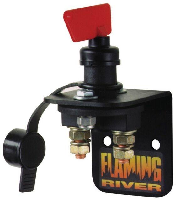

    [​IMG] I use these disconnects .I have them at work they are reasonable and the red key is removable
