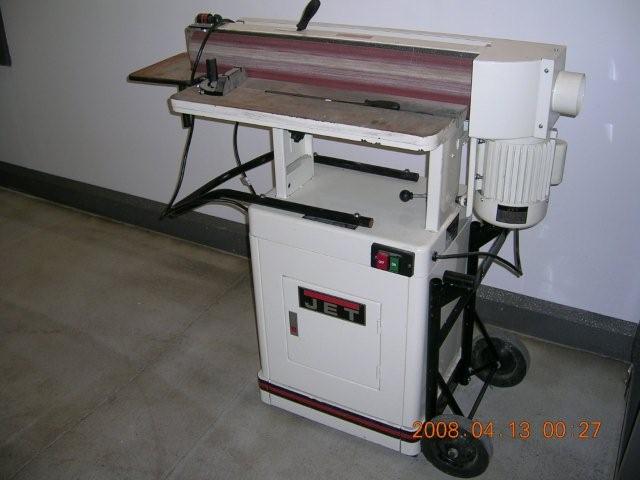

    Horizontal Belt sander. Works much better for contouring and flattening all sorts of things. I can't begin to guess how many times I have used this sander, but its in the thousands. They cost more than the the smaller vertical belt sanders, but the flat table and gravity make it much more usable. Its also long enough to flatten header flanges, just do it slowly to keep the flange reasonably cool. Put the machinist money toward one of these and then you have it for a thousand other things later on. One of my best tools! ;)
    I added the wheels and handle so I could move it easily. It was an old HF dolly.

    I bought a surplus supply of old belt sander belts of all sizes really really cheap. I cut them and clamp them down to my bench. this allows me to rub manifolds back and forth on the belt. I have done this for years, they look like they have been machined and I never had one come back with a leak. no buying a machine or dropping off ,waiting picking up and paying for a machine shop.....it is a work out tho.;)

    That’s cool! Gives me an idea of something I’d been thinking about. What’s the motor speed on the machine?

    Its 3450 and spec sheet says belt speed is 3900. To those of us who like to do a lot of fabricating, this machine is a joy to have. Lay steel plates down on the flat surface and make nice straight flat edges quickly, or rotate the part against the belt and make nice radiused corners that look machined. Radiusing edges is a snap. I don't know how many times I have inadvertantly filed a finger nail while flattening a small lug or bolt.:oops: Put a rod or bolt in a drill and turn the drill on while the sander is running and you can taper a starting thread or beautifully make a round end on a shaft. I have a plastic coffee jug mounted on the wall nearby for quick cooling. There are other brands available but you don't see many used ones being sold.......people who have them tend to keep them.;)
