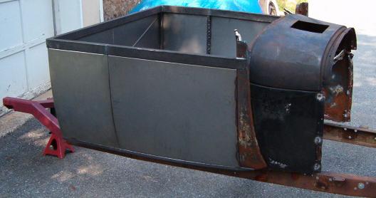

    a friend of mine has been looking to start on a model-A type project but he doesnt have a ton of money to pour into a body. so i agreed to build him a roadster pick-up cab pretty cheap. we decided something a little bigger then stock would be better so i used alot of the dimensions from my newest coupe/roadster and went from there
    basically i started with closed car 28/29 cowl posts. then i built a tubular framework to the dimensions of the cab. 2x1 at the top and the rest 3/4x3/4 but i left the top and bottom tubing spaced out 1/8 inch. i then made pan like skins that fit between all the tubing curved them all to match...rolled some beads in the back and all of a sudden we had a cab.
    the top and bottom tubing represents the top and bottom body line like on a roadster
    its pretty simple but it has the look he was after...no working doors but i put seams in the sides to simulate the seperation and if he ever wants down the road it'll be simple to split it at the seams and make a door to fit...its all welded on the inside so cutting apart will be easy
    well thats about it...im not sure if my explination makes sence but i figured i would share anyways as its a pretty cheap route to having a roadster pick-up

    here it is with the cowl...
    zach

    That rips. Kind of makes me want to scrap the body on my roadster and start over with just a cowl.

    thats one of the best home make RPU bodies i've seen....
    great job...and even more,great job on simplifing it for us ,'normal',guys...haha..

  6. Mission acomplished. I don't know how fast you work but He's got a rust free start. In short order he should be driving around the block.
  7. That helps give me ideas for converting my Murray Fordor to an RPU. That's the one that's supposed to have all of the body supported on a wood framework, except that all of the wood is rotted away.
    How did you bend the square tubing?
    Definitely one for the archives -- THANKS!

    just bent the tubing by hammering it over an open space....i used a 5lb sledge with a short handle and the end of an old press table stood on its side...hammer away....flipp it and hammer more if you go too far

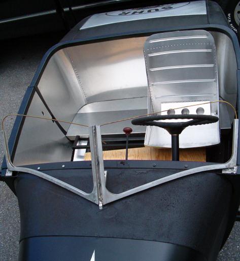

    what are you two planning for a windshield? it doesn't look like it'll take the stock stanchions. anyway, i like your idea a lot.

    the cab corners are just 3/4 box tubing....the rear side piece wraps around about 3/4 inch and then the rear pannel butts against it....so it can be finish welded and ground smooth or ground and a little bondo to be smoothand show no seam
    i dont have any other pic's as its in the bed of the truck (mobile storage shed!)
    heres one but not a close up
    zach

    burger
    heres the windsheild im working on for my roadster/coupe with the same cowl posts...your right it doesnt work out with stock roadster parts but its easy enough to just make things
