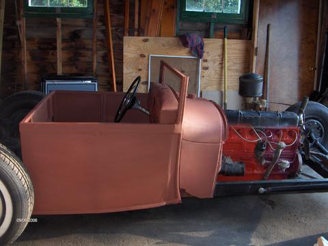

  10. JOECOOL
    Joined: Jan 13, 2004
    Posts: 2,769
    JOECOOL
    [​IMG] [​IMG] [​IMG]
    Here is some pic's of mine. I had doors but built rear section. Was easier than I had expected.
