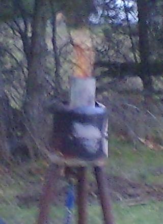

    Don, if come you south for the winter, I think we can fix you up with a 10-12 pound ladle you could pour a few hundred pounds in a day.....I don't think you will break a sweat, now making all the molds and breaking them down well that is like real work. I'm still pondering the spool.......should work but why it hasn't been done before????
    Thanks for posting your work it makes my day better! tt
