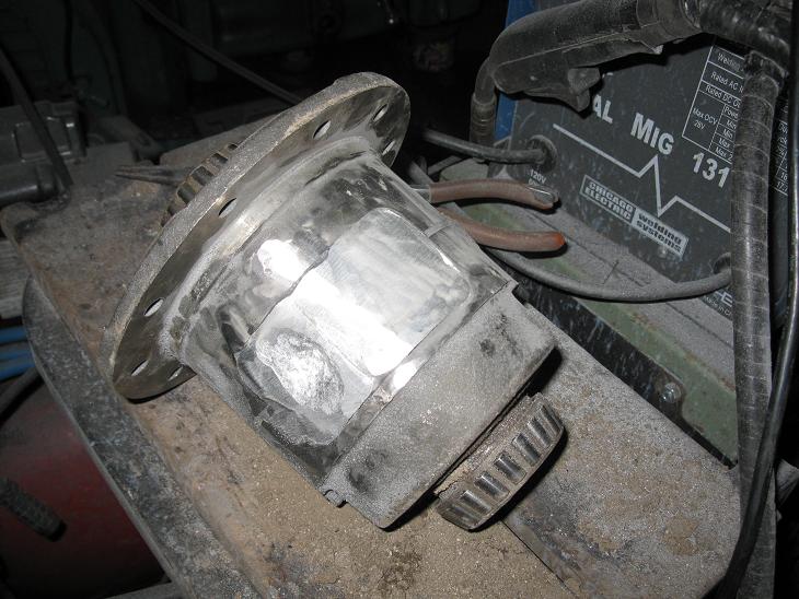

    ok, i hear ya,but it would be benificial if you had somthing to stuff in the spider gears so that no molten aluminum gets into the splines. good luck on your project, and lets see some pics luanching at the starting line !
  2. My friend Bill who supplies me wth most of my general use aluminum from his shop discards is the one I spoke of with the busted mini spools. We decided to pour one of these since it is no good as is anyway, not too big to pour and since he supplies all my general use (non piston aluminum. ) why not? If all goes well I will pour it tomorrow. It is no good anyway so we cant hurt it and if it works he has a usable piece.

  6. It turned out the diff Bill sent was his first broken posi unit and it was badly busted. Spider greas were gone , spidershaft broken. Posi unit chewed up . I popped it out and i used two of the springs to hold the side gear innner axle splines in place. I lined the splines up and also tacked a piece of sheet metal over most of the open side hole. I also welded the broken stubs of spidershaft in their respective holes. The slight depression is where I poured and that is where the last shrink always occurs. I removed the sheet metal I had tacked on to cover the open hole and gave it a quick cleanup. I dug out and shook out the sand from the splines. You can see the aluminum at the end of the hole. The inner section is completely full . I personaly find it hard to imagine this could come lose. A open diff would be a better candate but this is what we have . Fomerly good for nothing. Now a solid spool. Cost? I figured it out. $2.47(Propane 20 minutes)Anyway it was an idea I had and there it is as promised.

    Don, your projects never cease to amaze me! I would have never thought of this, but you did, and now you have a very cheap spool.

  8. Thanks for the encouragement.This aluminum casting thing has opened up a whole new world to me. While i poured this I also made a two slot adapter from my 318 poly manifold. To go from the old WCFB four hole to to large modern Holley slots. Like you would find on any modern dual plane intake. I have to clean it up a bit but I did shake it out. It seems so interesting. You want something , you glue it up in blue styrofoam, pack it in sand and 15 to 20 minutes later it appears. No shipping, no duty, no brokerage fees and no waiting. Also you never get the wrong part. I think I may have created a monster. This idea for the spool came while I was waiting for a melt. Anyway for what it is there it is. Anyone else want to try pouring aluminum I will gladly give details on how I melt and how to make it. Very simple , No funny materials to find or buy like on the internet sites or foundry books.

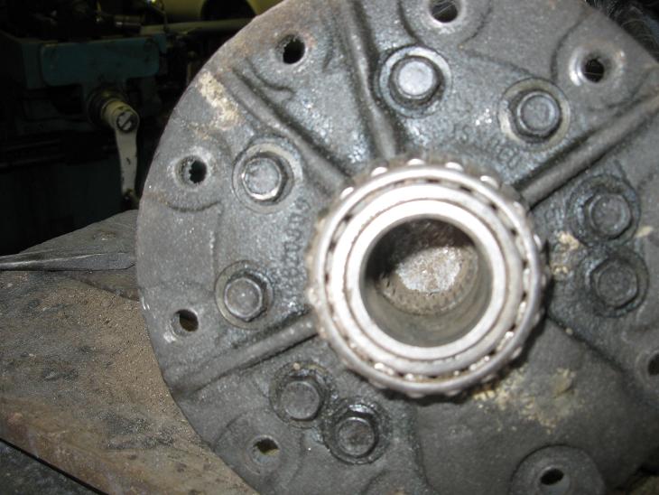

    My only concern, and you may already have this covered, is sometimes the splined axle ends protrude through the side gears in the carrier - so they may not seat fully in the housing ends.
    I forgot - what kind of rearend is this? Hopefully not a C-clip style, as you now have no way to retain the axles. I'm anxious to see how well this works!

    Don, Not to argue with you, because you are usually right..And you and I see eye to eye on almost everything...But....
    Your statement that aluminum is stronger than steel (by weight) is true..
    BUT...That plug is approxamatly 6"x6"x6" (or 1/2 cubic foot)> aluminum is 12 lbs (or so) per cubic foot..
    So the plug is 6 lbs (estimated)
    Steel is 40 lbs per cubic foot, so 6x6x6 is 20 lbs (est.)
    So...you would need to double the weight of the aluminum plug ( aprox.) to get close to the strength of a steel plug....12lbs x 1.27(27 %) = 15.24 lbs
    To simplify ( and in round figures ) 30 lbs of aluminum is just slightly stronger than 40 lbs of steel....

  11. But Dave we dont need 6x6x6 inches of steel . Lets us say just for the sake of argument we made a thick wall splined steel sleeve to join the two axles. Say 1/2 inch thick just to be on the safe side . No one would worry about it breaking. That would be about 8.1 cubic inches of steel. (outside measurements minus the hole) Instead we have 6x6 X6 = 216 cu inches approximately of aluminum. I think we are well covered here. We are ususaly riding on Alminum wheels too and several trannnys like the 727 often have aluminum mounted planet gears, aluminum sprags in the converter too. It is pretty rare to see them borken in normal racing use and they are none even close to this thickness. .
    Yes this is a C clip diff but will use C clip eliminators and if the axles bump the aluminum we will relieve that with with a big drill or a small slice off the unused portion of the splines. Certainly an easy fix of a little thought and a few minutes work. And will not deter performance in anyway shape or form. It would also be no big problem to make the hole deeper past the splines with a bit of a sand core. I dont think it is necessay but so be it. Anyway. It was just an idea I had. I think it is workable and safe. I said I would pour it and show you . I have. I think it will stand a lot more then we realize but I agree that the proof is in doing it. Bill will have it back this week. My part is done.
    Don
    Also the fact that this aluminum is for the most part trapped and encased in steel must account for something as well. In the back of my mind way back in my early days as a BMC mechanic there was at least one car i worked on that had an aluminum carrier. i think it was the Austin Heally 3000 but i might be wrong. I can see it though in my minds eye. And then there is aluminum driveshafts. Hollow thin (relatively) tubes of this stuff handling hundreds of HP and sometimes over 1000 . How does that work?

    However....Given that the 27% stronger figure is based on weight, not volume,, I think that you would need a larger amount of aluminum to equal the strength of steel.

  16. However....Given that the 27% stronger figure is based on weight, not volume,, I think that you would need a larger amount of aluminum to equal the strength of steel.
    Dave the axle itself is less than 1 1/2 inches in diameter of steel. This is like you said 6 inches of diameter and cast completley into two side gears of 3 inches diameter sealed in a steel housing with two sections of spider shaft sticking into it at least an inch plus stuck with an odd shaped opening which it is also cast into. if the sidegears go around in that Ill be a monkeys uncle. The axle will break long before this will. Before i did this five springs pushing against two side gears stopped it from spinning.
    Larry i wondered when you would jump in. Yeah I am definatley keeping warm doing this. I get even warmer trying to justify it.
    I suggested this but like i said I dont need it as I have all my diff stuff already. I did this for a friend so I could keep my commitment to try it and show you. I did. End of story. If no one wants to try it OK. I have satisfied my curiosity that it is doable . I think it is safe and S T R O N G! I am returning it to Bill. I have other fish to fry. (Aluminum fish of course!)
