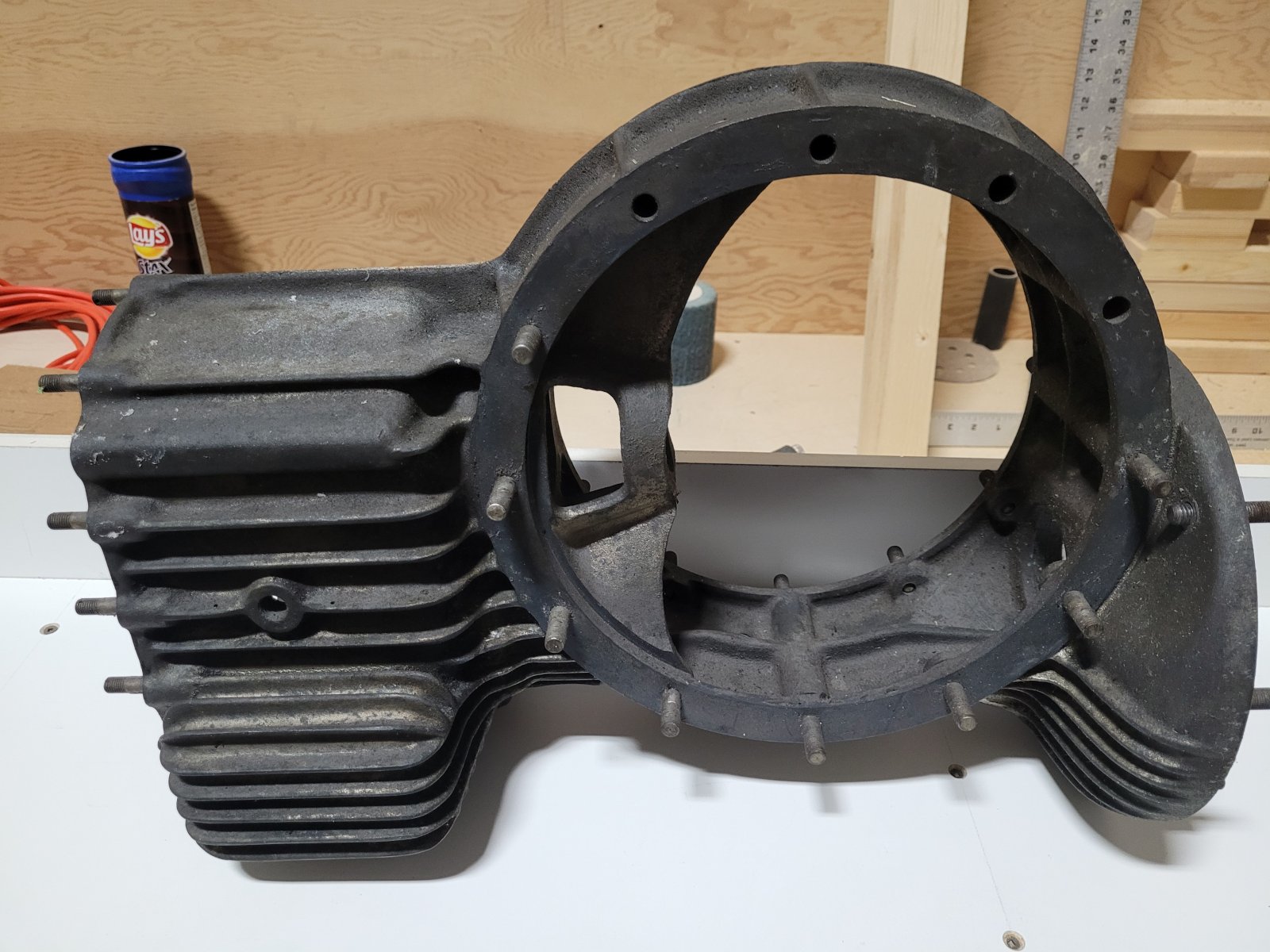

    Does anyone know the grade of steel used for the lower shaft of a Halibrand Champ (301) quickchange? I am finally going to look at ***embling my magnesium Halibrand transaxle case but as a quickchange and will need a longer one-piece shaft machined to fit. Just want to know what to start with.
