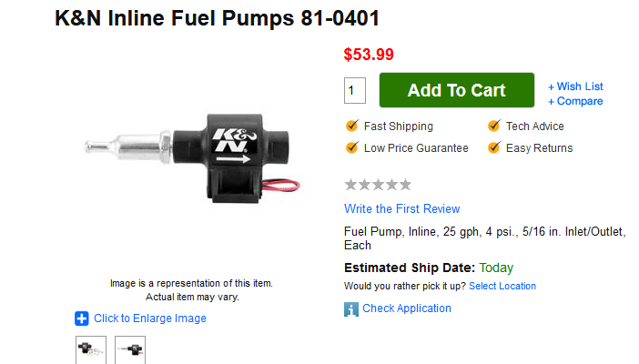

  2. [​IMG]
    I have used these on several cars, works well.
    Just Gary and Hamtown Al like this.

    My thoughts EXACTLY!!. Helps quickly diagnose itself. Frame mounted p***enger frame rail in 87-91 Ford F150 factory mounting bracket.

    Same here.

    I ran a facet on my 39 ply for 20 years never a problem . Like the 39 guy carried a spare never needed it

    I've ran both Facet and Mr Gasket versions of that style pump for years now. One on the Lincoln right now, my E350 motorhome with the 460 has one also. Simple and quiet.
