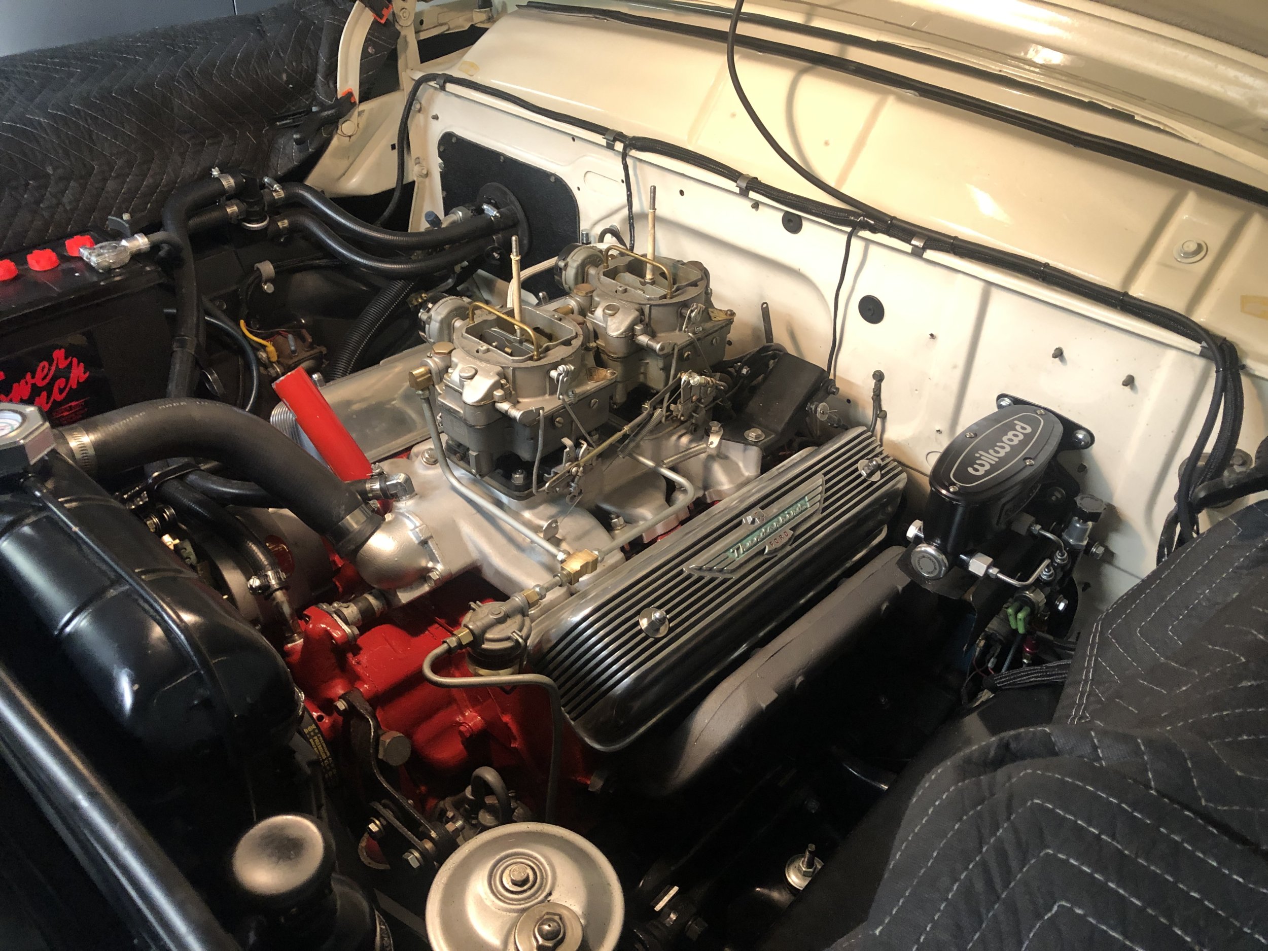

    Pressure can be your friend or enemy. Most fuel lines are 5/16”. It’s better to have 3/8”. Many use -6 AN which is called 3/8” but not even close when you check the fittings. My stock fuel lines is 5/16” and the pressure is under at 4 psi. and feeds dual quads and in 8 years never ran out of fuel. Granted they are not big carbs but the same as a 245/270 hp Chevrolet 283. I have a Carter and would use before any Holley. I would mount it on “Lord” bushings . IMG_4522.jpeg
