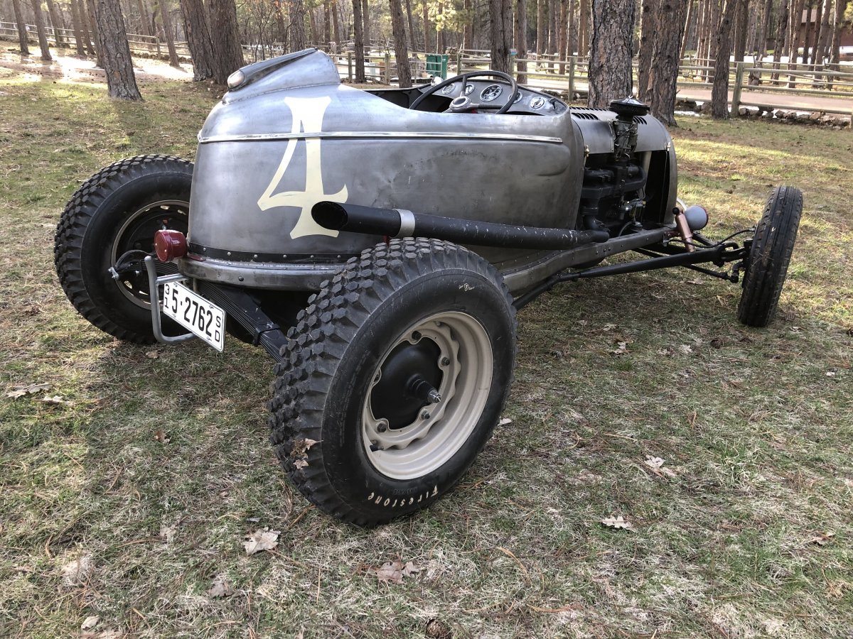

    Trying to figure out the most cost effective way of turning the volume down on the car a bit
    Right now it's just open headers. I'm looking at a couple of different things and I'm not sure what the most effective option is.
    Got these Auger style inserts, that I'm leaning towards
    https://www.speedwaymotors.com/Auger-Style-Muffler-Pair-3-1-2-Inch-O-D-,382830.html
    Or whatever you wanna call these
    https://www.amazon.com/SCHOENFELD-D...hoenfeld+Insert+Muffler&qid=1594077048&sr=8-2
    and possibly add a kick out
    Is there any other cheap options that don't change the look too drastically that I haven't stumbled upon yet? Thanks
