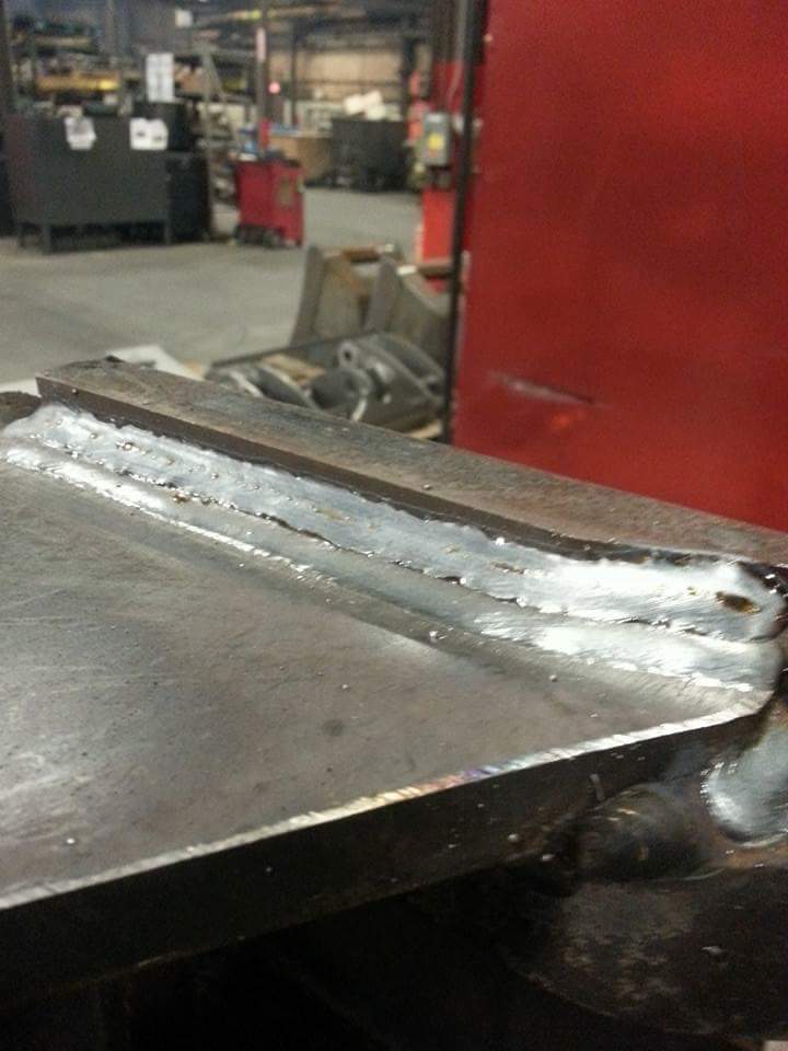

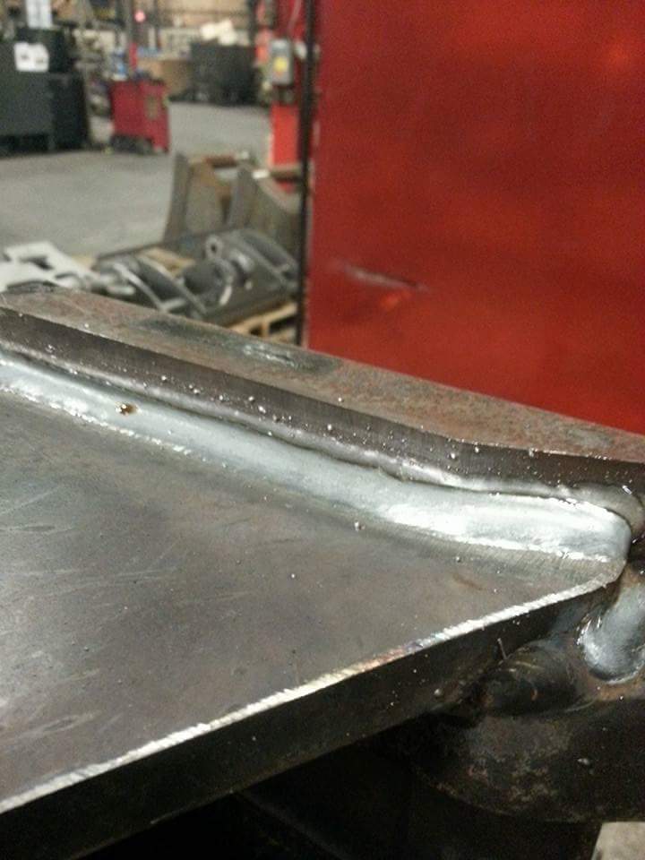

  17. bobbyt239
    Joined: Mar 5, 2017
    Posts: 13
    bobbyt239
    I weld heavy equipment loader buckets and excavation buckets for a living. I will say this, welding is an art form and takes many of hours of learning before you even get pretty welds...uphill, downhill, overhead and flat horizontal. Much of the steel I weld is way over an inch thick and I never weave, zigzag or oscillate unless the metal is scaly or has any kind of contaminate. The little 110 welders can only do so much. Little s***ch welds and spots are pretty much what they are intended for. Down hill welds are adequate as long as they have a slight crown or flat but never concave or cold rolled. FB_IMG_1488766210368.jpg FB_IMG_1488766219796.jpg FB_IMG_1488766230843.jpg
