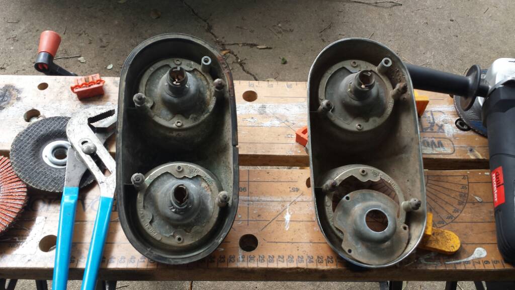

    I want to run '58 Chevy tail lights so i picked up some at a swap meet:
    Knocked out the reflector housings and painted them white for more light reflection. Pop riveted them back in:
    [​IMG][​IMG]
    Had to make the holes bigger for the replacement bulb sockets and to change the small reverse lights over to dual element. Borrowed a hole punch from work:
    Crimped in new dual element bulb sockets that have their own grounding tab:
    Wa la. with 3 new lenses and gaskets from www.taillightking.com
    Does anyone know where to find the base gasket for these housings? I only have one.

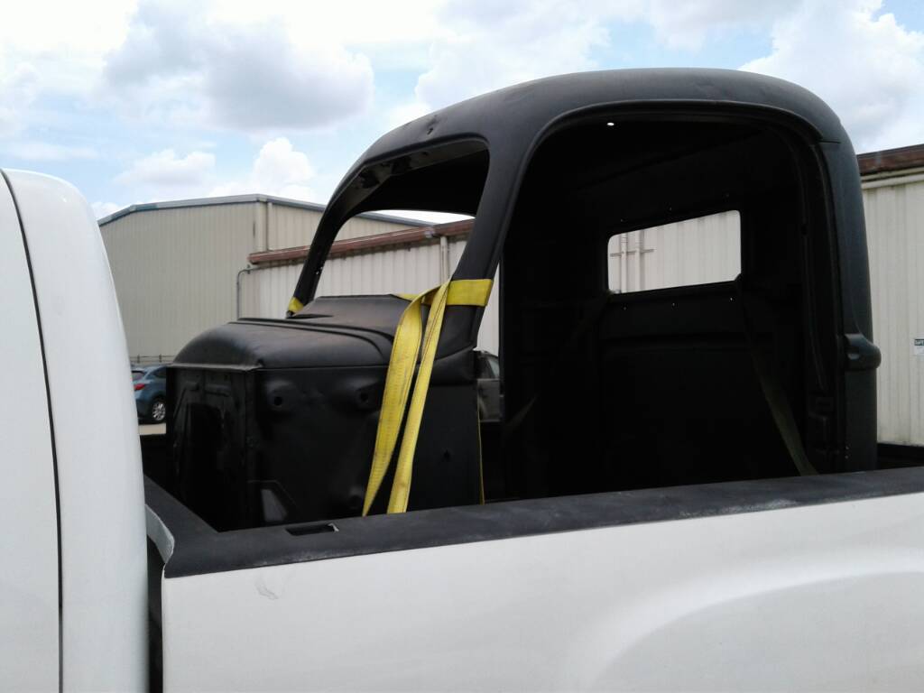

    treb11
    Well I've reached a point where the cab is needed to get all the interfaces right. Brake & clutch pedals, steering, battery box mounts etc etc. So I hauled my cab out and brought it to the garage. Need to get cab mounting wood.
