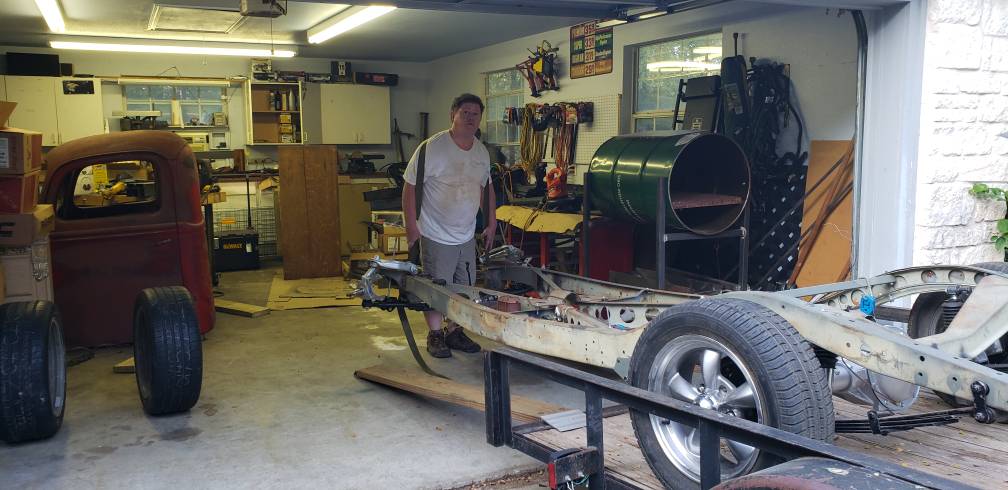

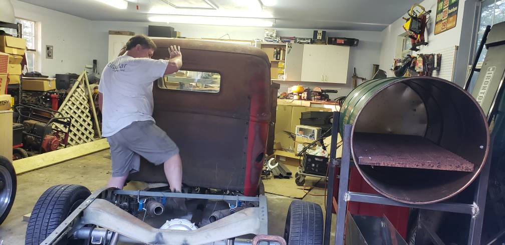

    Retrieved my ch***is from our previous house. Since it is only a 1/2 roller, I unloaded using my two favorite tools, brute force and stupidity. 20200915_183738.jpeg 20200915_183835.jpeg

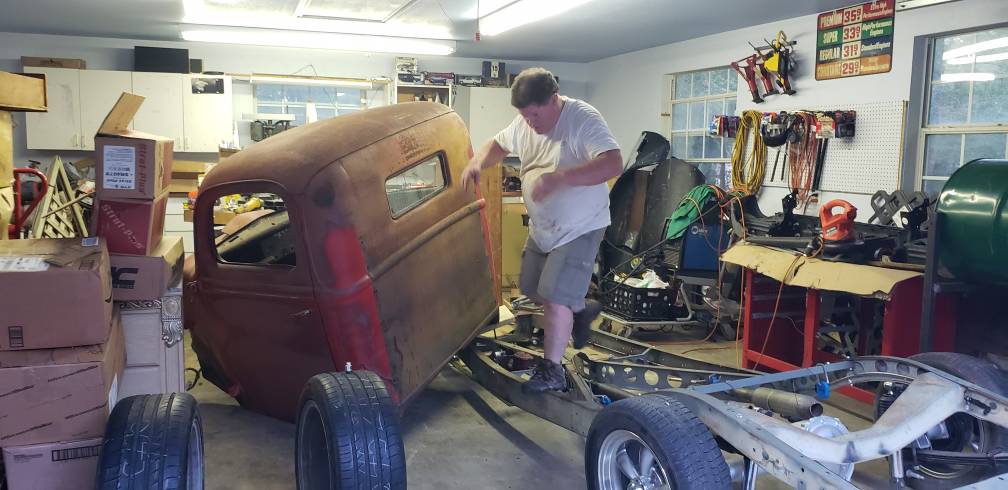

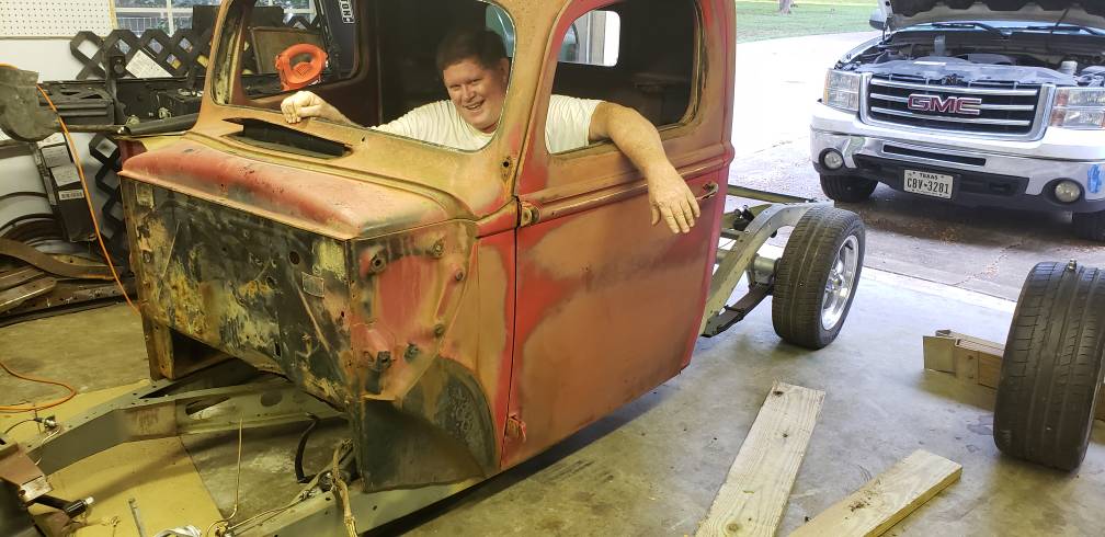

    And as long as I'm sweating, what the hell, I'll throw the newest cab on for ****s and grins. Same tools..

    Great use of the "Strap" method. Use to see guys moving Refrigerators by themselves using a strap like yours. :)

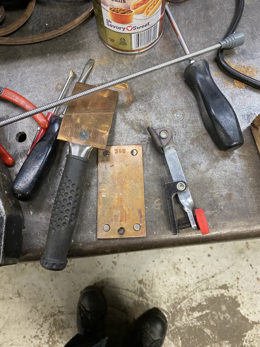

    I do have some chunks of copper I will be trying. They came from high amperage industrial fuses.

    I also use copper strips off buss bars. Just clamp it tight and weld from the back side. Try a few practice pieces to get the hang of bit and then do your repair, let me know how it works for you. I have been doing this **** for over 60 years and was taught by a man who did body work during the Great Depression and WWII when you had to fix everything. Frank

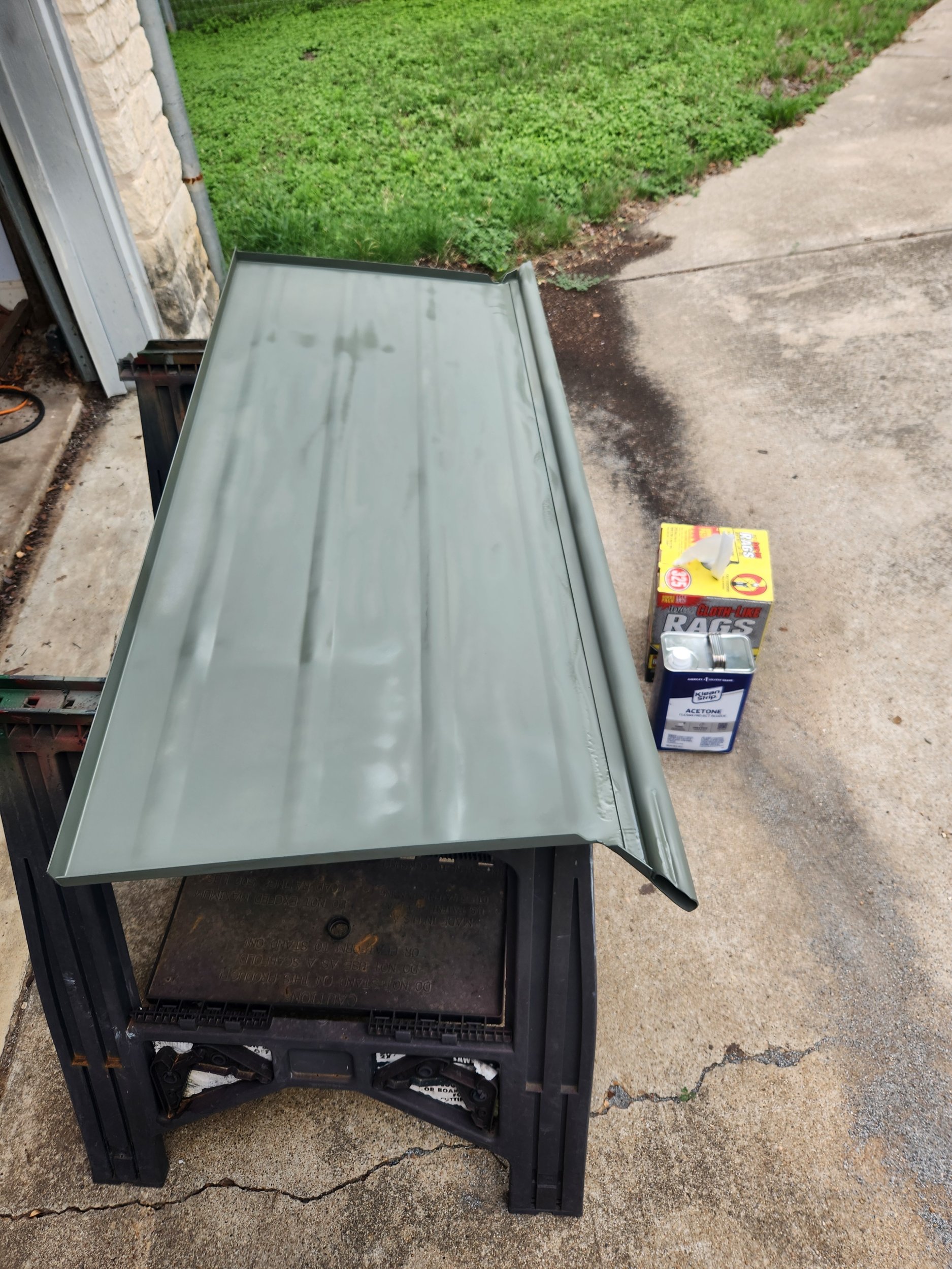

    Long overdue update. After shoulder surgery and PT, I decided to start pecking away again. Ordered a front bed panel from Bruce Horkey. Nice piece. Got it protected in etching primer
    impala4speed and Algoma56 like this.
