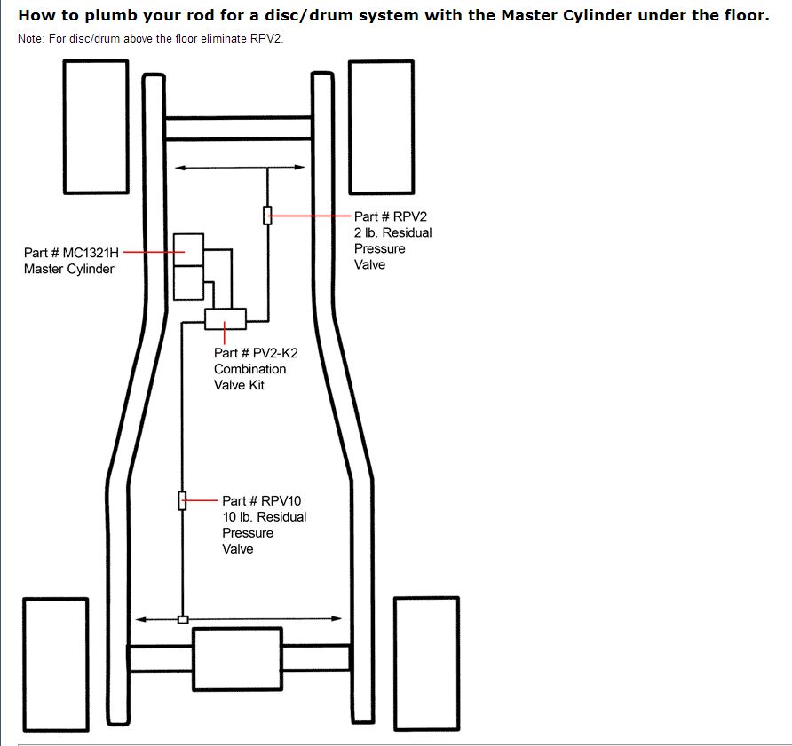

    You will get a lot of different opinions and experience. Here is what MBM Tech Support recommends.
  3. Lots of questions.....
    rod length: has to be 'loose", with some play with pedal up.
    If you have a newer MC you should not need a RPV on the rear, but one will not hurt.
    No, you should not need one in front.
    I would not use a factory type metering block unless the front an rear brakes were off the same vehicle..
    What is your specific problem??????

    Your '41 rear brakes need a residual, whether stock internally in the master rear outlet port, or an aftermarket 10 lb. inline external valve. (JFYI, I'm using Wilwood aluminum rpvs with no problems.)
    The front discs may need a 2 lb. aftermarket residual because of the low master location. I would install one.
    You don't really need metering/hold off, but an adjustable proportion valve would be a good addition.
