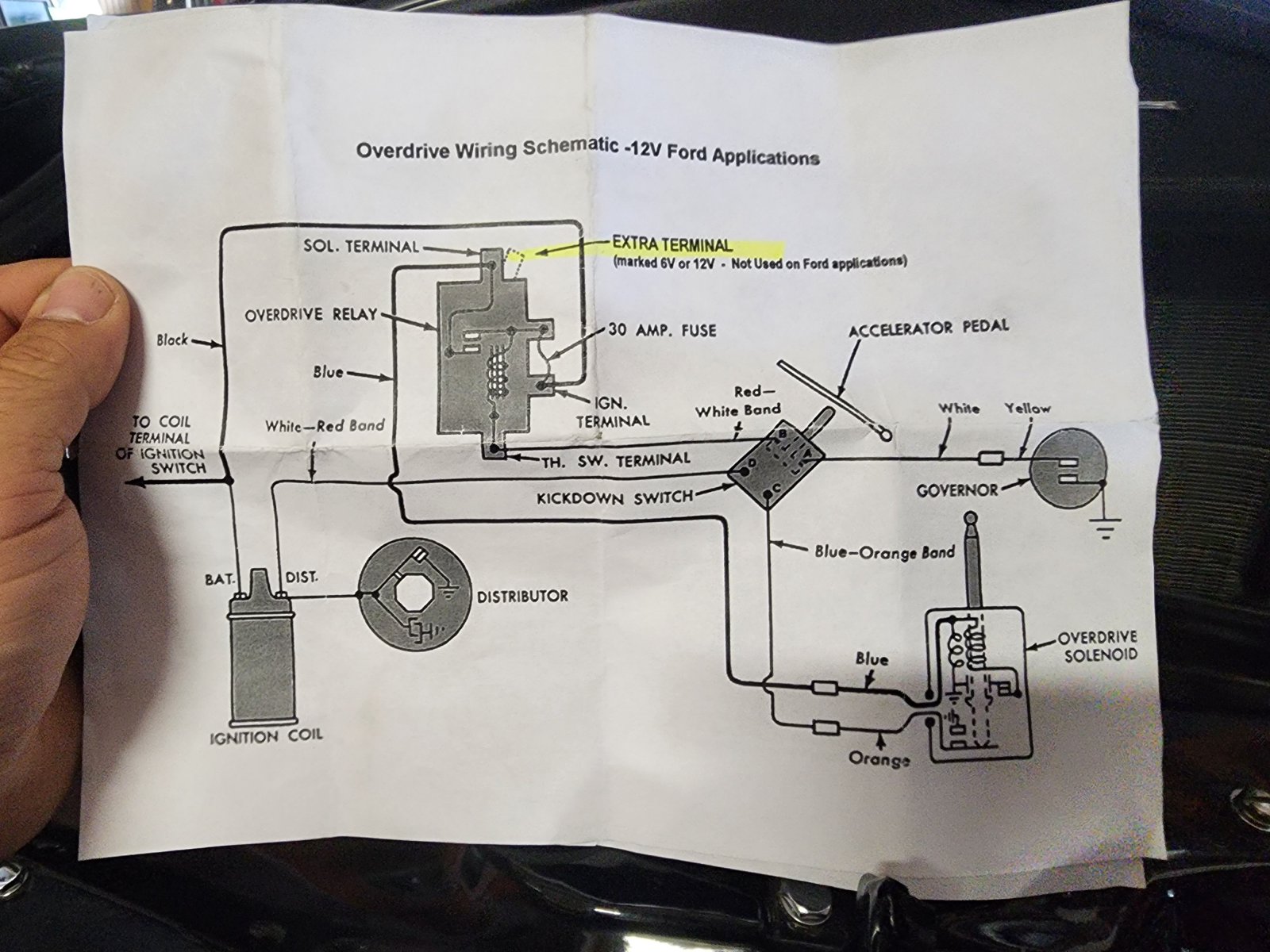

    Ok, in my 49 ford club coupe that has been rewired to 12v negative ground with an 8ba flathead and factory 3 speed with the r10 overdrive, how do I byp*** the kickdown? I don't plan on using it. The overdrive has a new 12v solenoid, 12v relay, nos govenor, all from vanpelts. I have chased all the wiring harness, all connections are good, all wires are new from Dennis carpenter, nothing has rubbed through, when the od handle is pulled out, it locks out like it should and operates like a regular 3 speed. When the handle is pushed in, the transmission freewheels as it should, but no click from the relay, and it does not kick Into od. How would I go about byp***ing just the kickdown so the overdrive will still work like it should as in kicking in at 28mph and such? Thank you!

  15. halfsack
    Joined: Dec 27, 2012
    Posts: 233
    halfsack
    I really appreciate all of the help and patience you guys are having with me on this. So, going by this diagram, unhook the wire from the govenor that goes to the kickdown switch. Next I ***ume just touch the end of that wire to say, a piece of frame or such with the key on?

  17. jaracer
    Joined: Oct 4, 2008
    Posts: 3,072
    jaracer
    Yes, be sure you have a good ground such as the transmission itself. That's what the governor grounds to.

  22. ^^^^ That indicates the fuse is good. Following the posted diagram, the relay is "pulled in" by going through the kick down switch and then the governor contact to ground. As stated, disconnect the wire going to the governor and ground it. You should hear the relay "click" when you turn on the ignition. If not, the relay could be bad.

  26. New relays, like anything else can be bad. Easiest way to test it is to put a jumper on the lug going to the kickdown switch and ground it. The relay should click. If the relay is wired correctly, the power to the ignition will be cut off momentarily when the relay is pulled in. In this case, I like points.

  30. One thing I learned in my near 40 years of working in the electrical trade is when troubleshooting, don't ***ume anything. Check it all...
    Yep, with the key on that should operate the relay and while you're under the car, unplug the blue wire to the solenoid. When the relay operates, 12V should appear on the blue wire. If it does, you've just 'proved' most of the wiring. With the governor wire still grounded, plug the blue wire back together, you should hear/feel the solenoid operate. Do this test with the overdrive cable pulled out (OD locked out) to avoid damaging the OD shift pawl. If it all tests out as above, the issue is in the governor.
    It needs to be remembered that the governor gets its ground through the transmission case. It screws into the tailshaft using a pipe thread, and any thread sealant or paint can interfere with that ground (especially teflon tape). I'd pull it out, clean the threads to bare metal and reinstall minus any sealer, with just a bit of oil for thread lube or better still, some anti-seize. While you have it out, it wouldn't hurt to pull the top cover off and make sure the internal weights are free to move and there's no broken connections.
    We tend to make stuff 'pretty' with paint or powdercoat but that can interfere with ground paths. That's one reason why the factories tended to be skimpy on paint on a lot of the bits.
