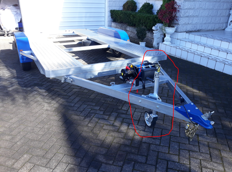

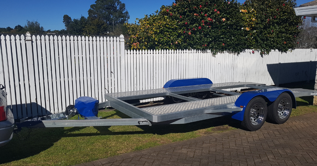

    We have built a few race car trailers so we have a bit of experience here.
    If you must build a single axle trailer Choose a Torsion axle that is correct for the load.
    The reason is........Single axle leaf spring suspension will Roll Oversteer and is prone to swaying.
    Torsion axles do not roll steer at all.
    If you decide on a Tandem axle setup , a rocker equalizer leaf spring will balance the load better.
    Rocker equalizer suspension with "Shackles on the rocker" will Roll understeer which is inherently more stable than roll oversteer.
    Don't use the slipper type that lengthens the wheelbase when compressed.
    So for a single axle trailer, the shopping list should include a "Dexter" torsion axle with electric brakes And a 50 deg "A-frame" coupler. AND a boat trailer foldaway "Jockey wheel" instead of a tongue jack.
    There is no reason why you can't make a new single axle trailer "look" period correct. The secret here is the choice of fenders and wheels [for example]
    Try and keep the moving parts to a minimum [eg: tie-down loops] so they dont break.
    Here is our latest race car hauler [This is homemade]
    It is tilt-deck , Dovetail rear, and Long ramps with built-in tilt limiters. Plus onboard battery, remote control winch and battery charging
    The ramps and tilt-deck automatically self latch.
    The idea was to load a low race-car without needing to dismantle it at the track
    We can normally knock-up a trailer in 2 weeks , but this took 3 month [because lack of motivation after building over 100 trailers]

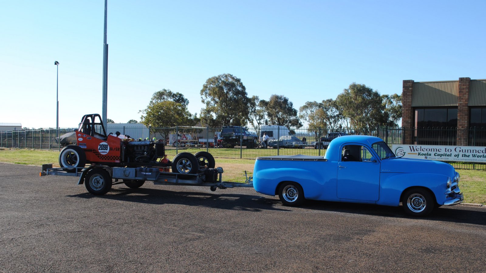

    I've got a hankering for a similar single-axle trailer for the FED I have in construction. Similar construction to Dana's holey trailer. Does yours tilt (drive on), or use ramps? I'm hoping for the tilt version, but am unsure of the mechanics. Need some schooling.
    Agree on truck tyres and hydraulic overrun (surge) brakes).
    Cheers,
    Harv

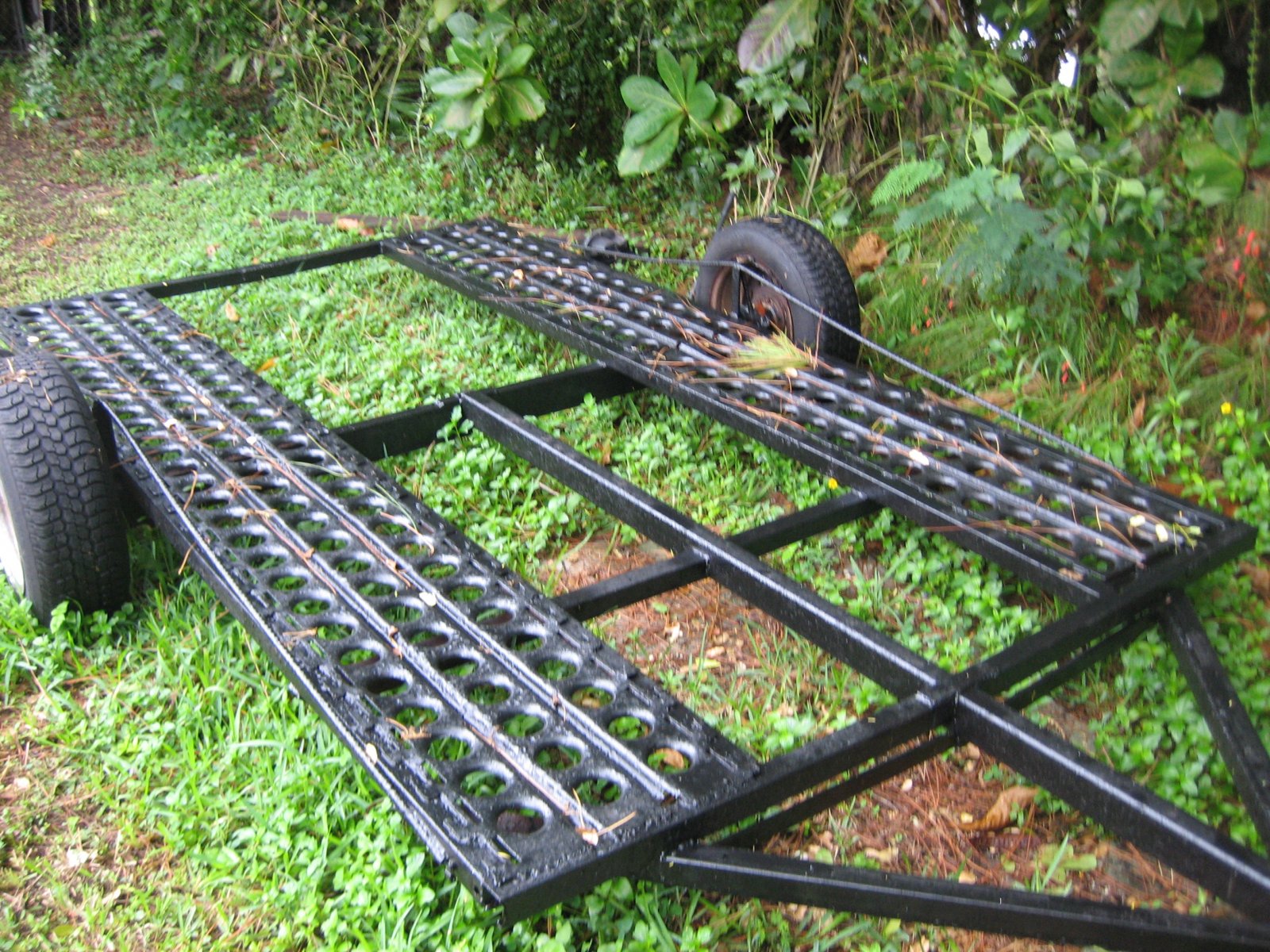

    Mine wasn't a tilt, just decent length ramps. The problem with a FED is similar to mine. Because most of the weight is toward the rear end of the FED you need to have the trailer axle far enough rearward to get 10% of gross on the the coupling. I bought a coupling scale from a caravan parts supplier so after weighing the trailer and race car and all the **** I loaded on it (gazebo shelter, water container and toolbox) I shifted the axle back till I had 10% on the scales. My wife was towing one day returning from Gunnedah drags and was doing 140kph (about 90 mph) overtaking two B-doubles and the trailer didn't give an ounce of grief.
