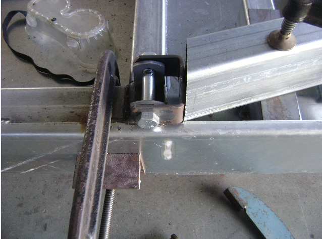

    On a tilt trailer all you need is a pivoting drawbar / tongue [a single axle or rocker equalizer suspension allows the deck to tilt]
    It helps if the deck is 50/50 balanced and the payload always settles at a point of equilibrium.
    But with a rear heavy dragster the 50/50 deck would be impossible so the axle will need to be moved rearward.
    A couple of van door gas struts help the deck to tilt in this situation.
    here is a photo showing the tilt deck pivoting drawbar / tongue [this trailer has a 50/50 balanced deck]
    In this example ^^^ the pivot is also the front spring hanger bolts [shown below before welding]
