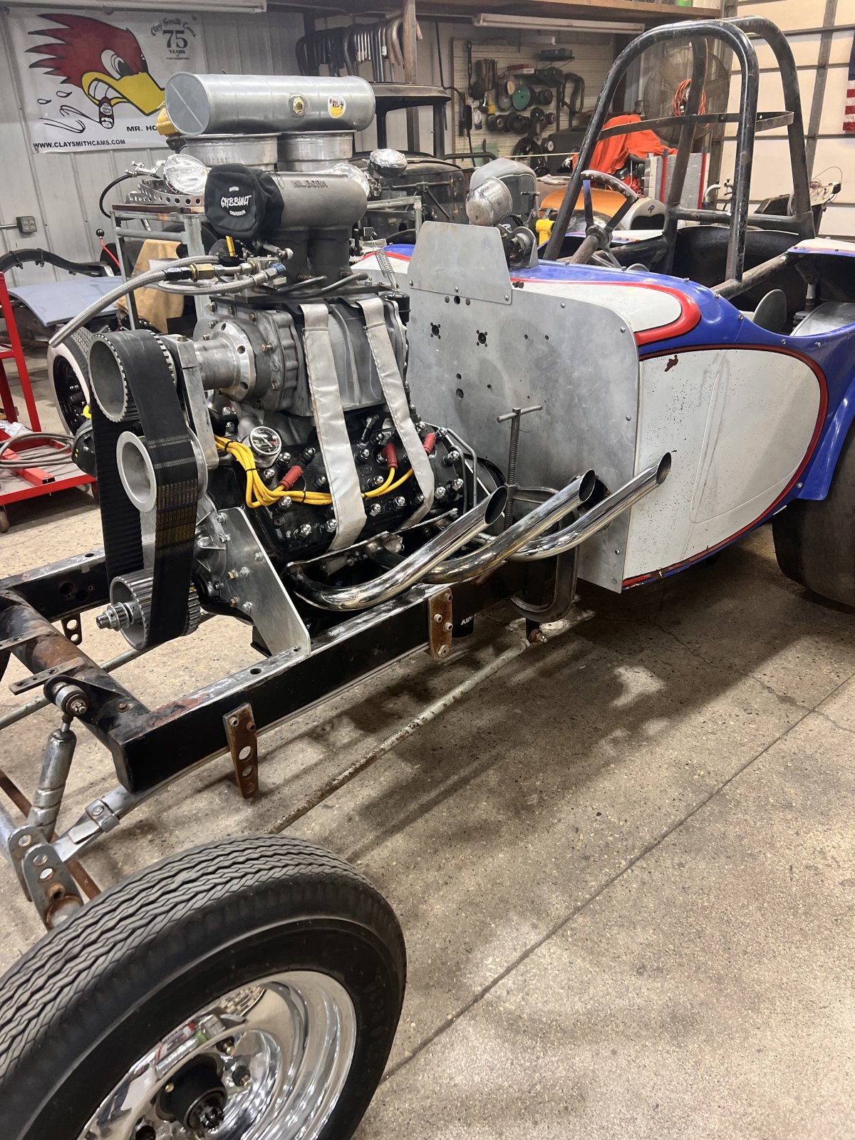

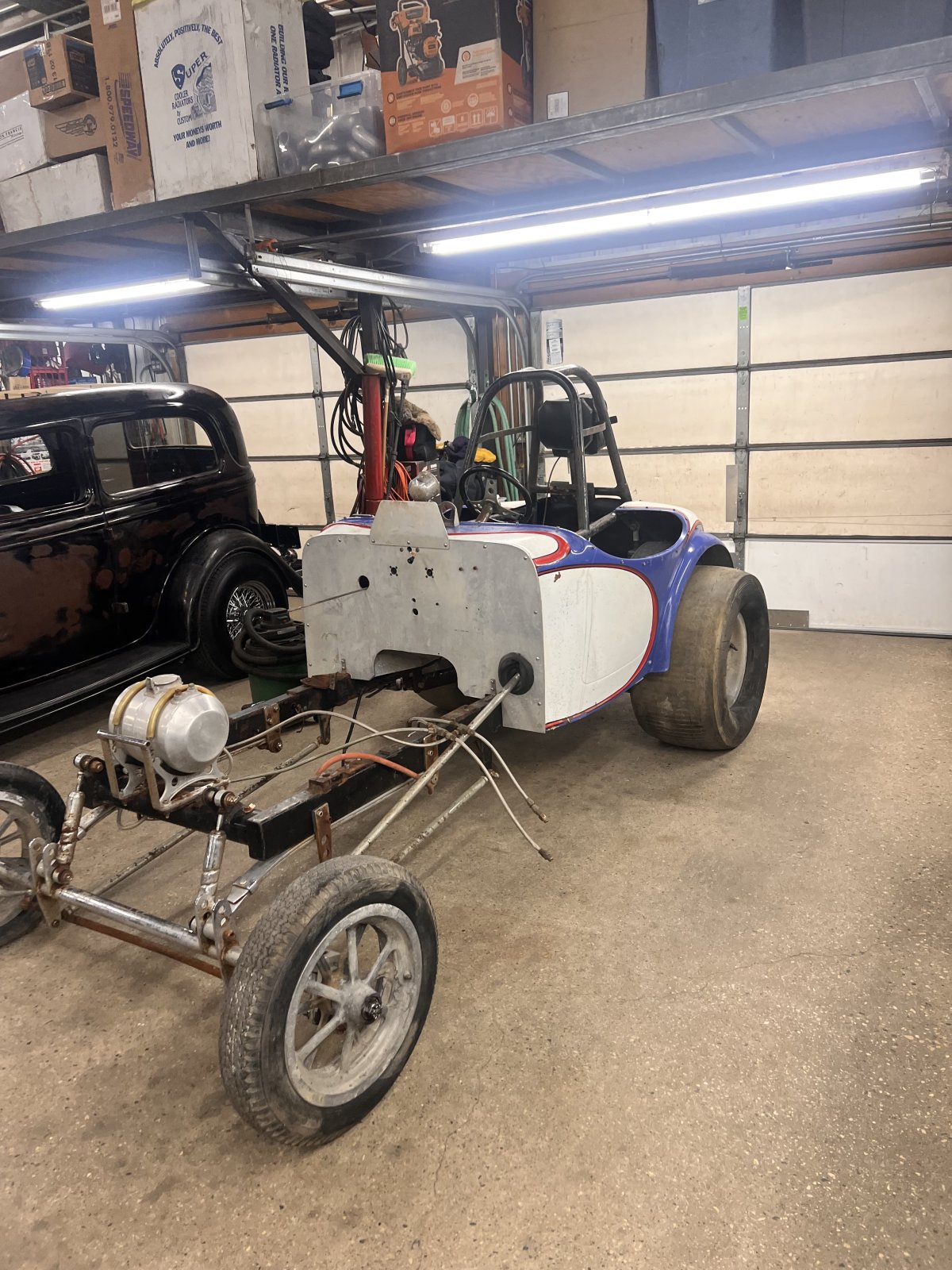

    We acquired this old Bantam Altered. Looking for any history or pics. Came from Omaha Nebraska area. Possibly raced Sioux City Dragways? Any info would helpful.
    We plan to run my blown flathead in it from dragster I listed for-sale. Currently adapting the Flathead to Clutch Flight Transmission that came with the car.

    Since you sound like you have had experience running a car with a blower do you think the tech guys will require more stringent compliance to blower car safety rules than if you run it normally aspirated? Aside from the lack of a 6-point cage will they require things like blower tethers, etc. to run where you plan to race?

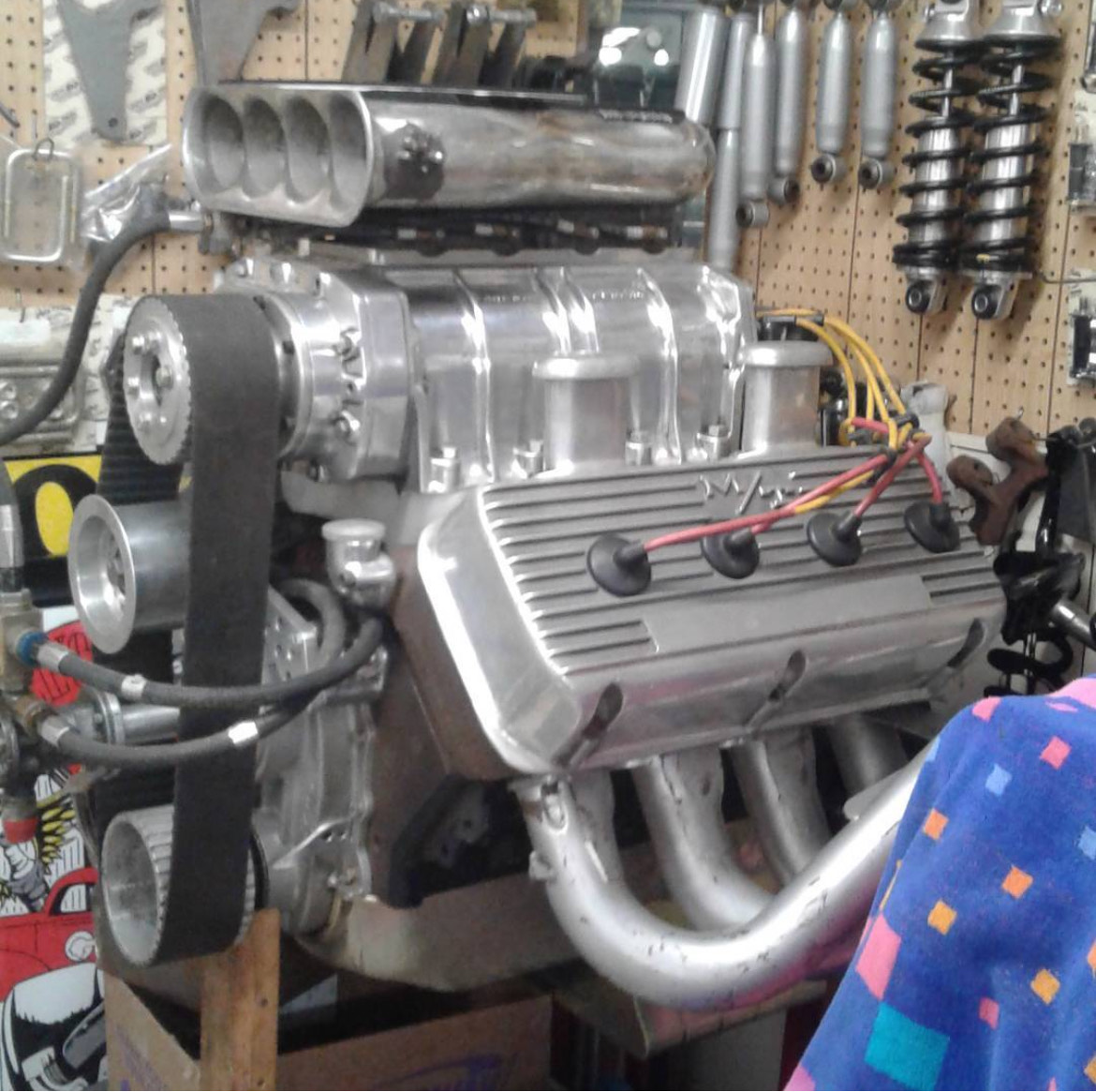

  4. Man,,,,that’s a good looking blown 8BA,,,,,,looks very strong .
    A lot of pretty pieces on it too to look shiny ,,,someone did some good work .

    This matters where you race. What events you go to. I run small nostalgia events like Fall Out Drags in Wisconsin.
    We run the blower motor first we had to have the blower restraints, and belt gaurd on gas now it’s on alcohol we added fire system, oil pan diaper, better fire suit.
    The cage is these cars are grey area because NHRA bases the rules on speed more than anything. This car will most likely not reach the speeds that require it have a certified cage.
    Again this far the tech inspections I have encountered encourage more things than they require. But they still look over the car, belts, helmet, and fire suit.

    It doesn't matter how fast it actually is capable of, it is how well it protects the driver if the **** hits the fan. That cage looks like a decent starting point to build a cage that will indeed protect the driver if the rig gets upside down and backwards or runs off the end of the track because something else happened.
    From what I have seen at nostalgia drags, the cars that get out of shape the most are the little alterds or short wheel base dragsters that don't pack all that much horse power but when they pull to the line everyone close by backs up a few steps rather than get closer to get that good shot.

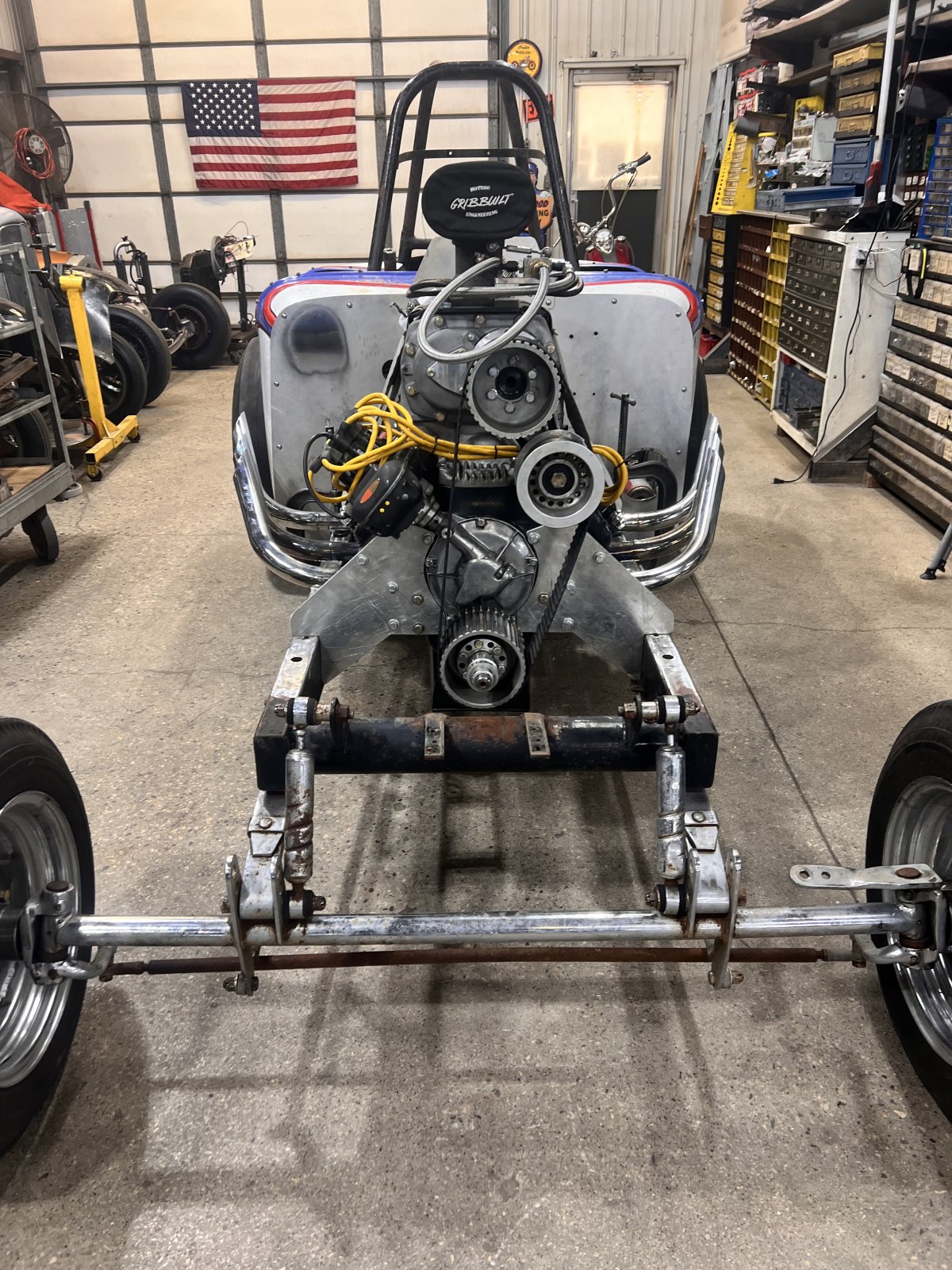

    I haven't seen a front suspension like that, it's interesting. I can't help you out with history, as far as running the car, we ran my MG which was a 1960's race car exactly like it looked in 1964. A roll cage was required if the car went quicker than 10.90 so I didn't want to put a cage in the car and kept it in the 11.0s but with a mild motor and a light car it was in the 10's all the time. We were more for showing the car than getting a $3. trophy, we had a lot of fun. Enjoy the car and stay safe, good luck.

    Generally speaking, if you run 9.99 or quicker in the quarter your car needs to have the ch***is certified for NHRA. And RECERTIFIED every three years, at a cost of about $200. While cars running slower do not need certification, the safety equipment required for each type of car must still conform to their requirements and expiration dates. Your best bet if you plan to run NHRA tracks or at events that follow NHRA guidelines is to get a rule book and comply to it.
    I don't want to harsh your buzz, but I see things on your frame that will not comply. Some outlaw tracks may allow you in, but with the dwindling number of tracks it would make sense to me to build a car that will be accepted anywhere, allowing for more choices of which events to attend. Good luck.

    The above helmet clearance is not going to fly even if the ch***is was well done. I'm 5' "5 and it's a tight fit.
    I'd not want to run 9.99 in any part of this.

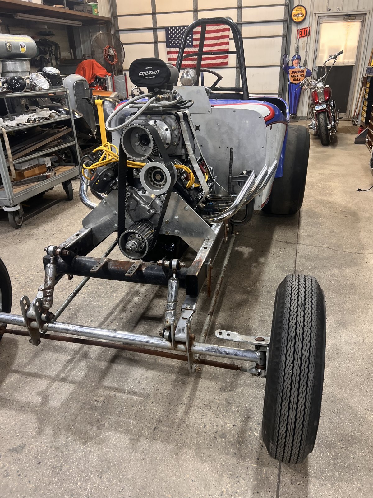

    Blower motor has been installed! Built a mid plate to adapt the Clutch Flyte Trans to Flathead and front motor mounts

    The HA/GR in my avatar uses a similar suspension. It's a trailer spring cut in half with friction shocks to add some dampening.

    The idler pulley, in my experience running it on the downside didn't work out too well,,,
    have you ran it in the past that way?
  24. CGribble
    Joined: Nov 30, 2006
    Posts: 13
    CGribble
    Yes we have not had any issues thus far

    The unique front suspension ( Quarter elliptic with a single bolt mount on each end ) looks similar to a Car Craft project roadster from the early 60's the frame was longer, overhanging the front axle, with shocks mounted from the side rather than the front. The frame was channel rather than tube. Still trying to track down the article, may give you some insight who designed or built the ch***is.
    It was Flathead powered !
