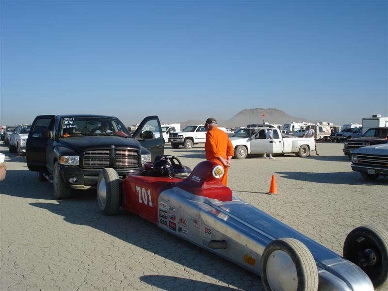

    Body & Paint, this is an area I have very little experance. I have a glass '27 body with an aluminum nose on my LSR car. I do not have all the tools and lack a lot of the patience to do body work. But the time has come to do the best I can with what I have.
    I would like some input on the best / correct way to prep aluminum for automotive paint. I think I can muddle my way through redoing the glass work I screwed up last year. Anyway I need a very basic outline of how to proceed.
