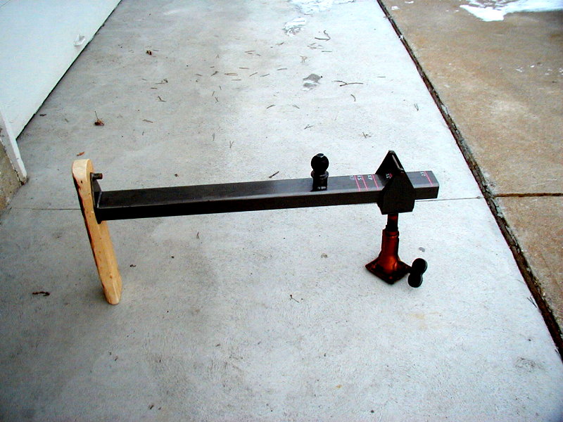

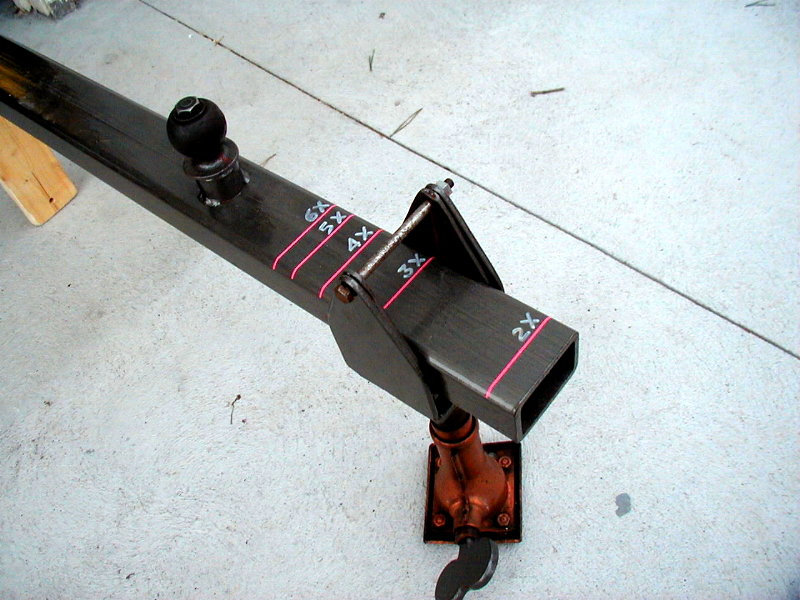

    Generally, 10% of the trailer GTW should be the tongue weight.
    You can make a tongue weight scale using a bathroom scale. and this.

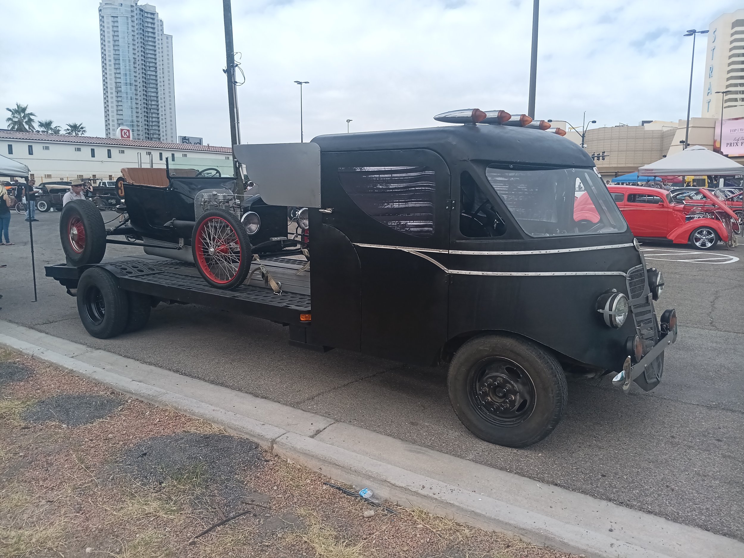

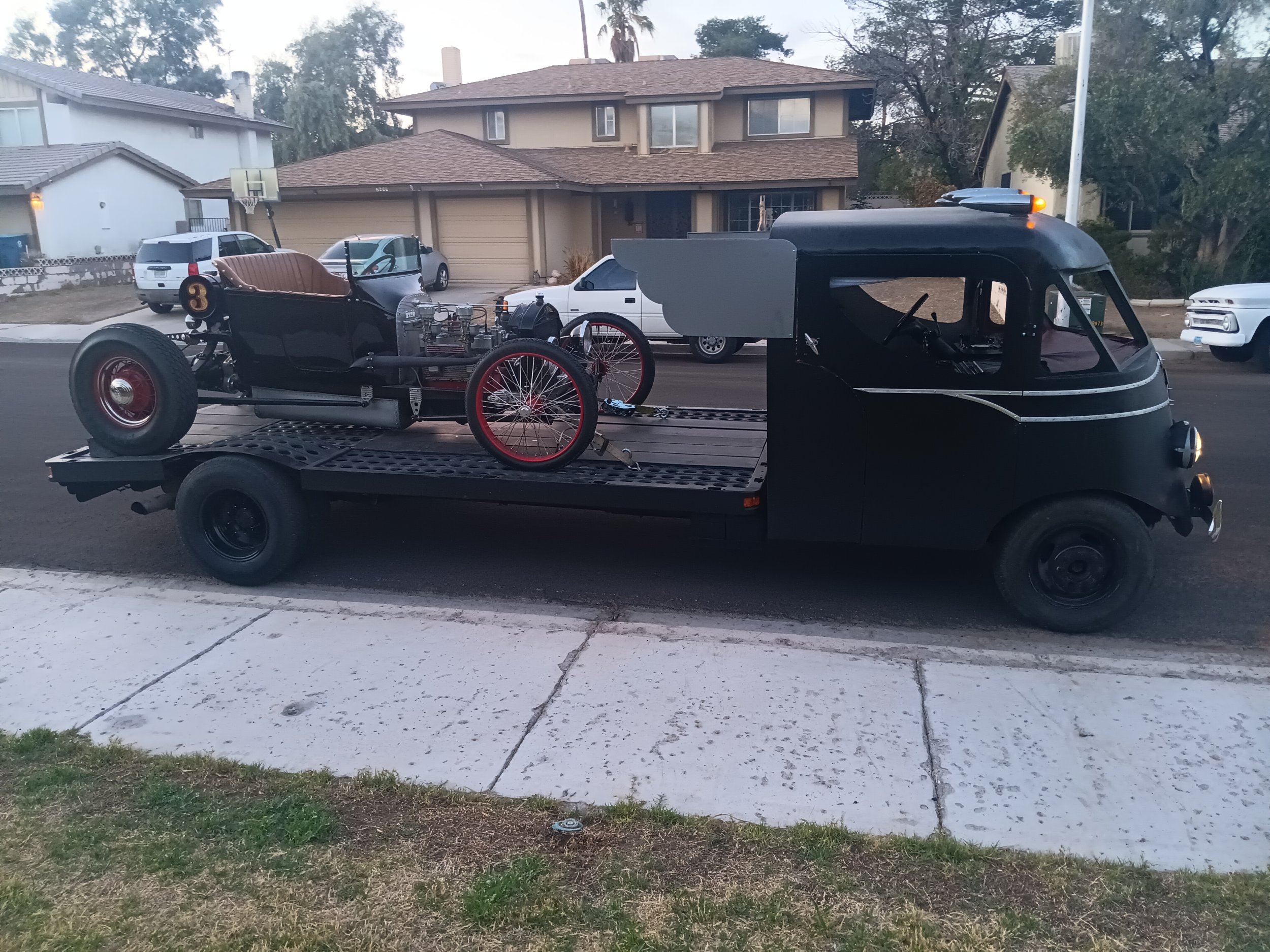

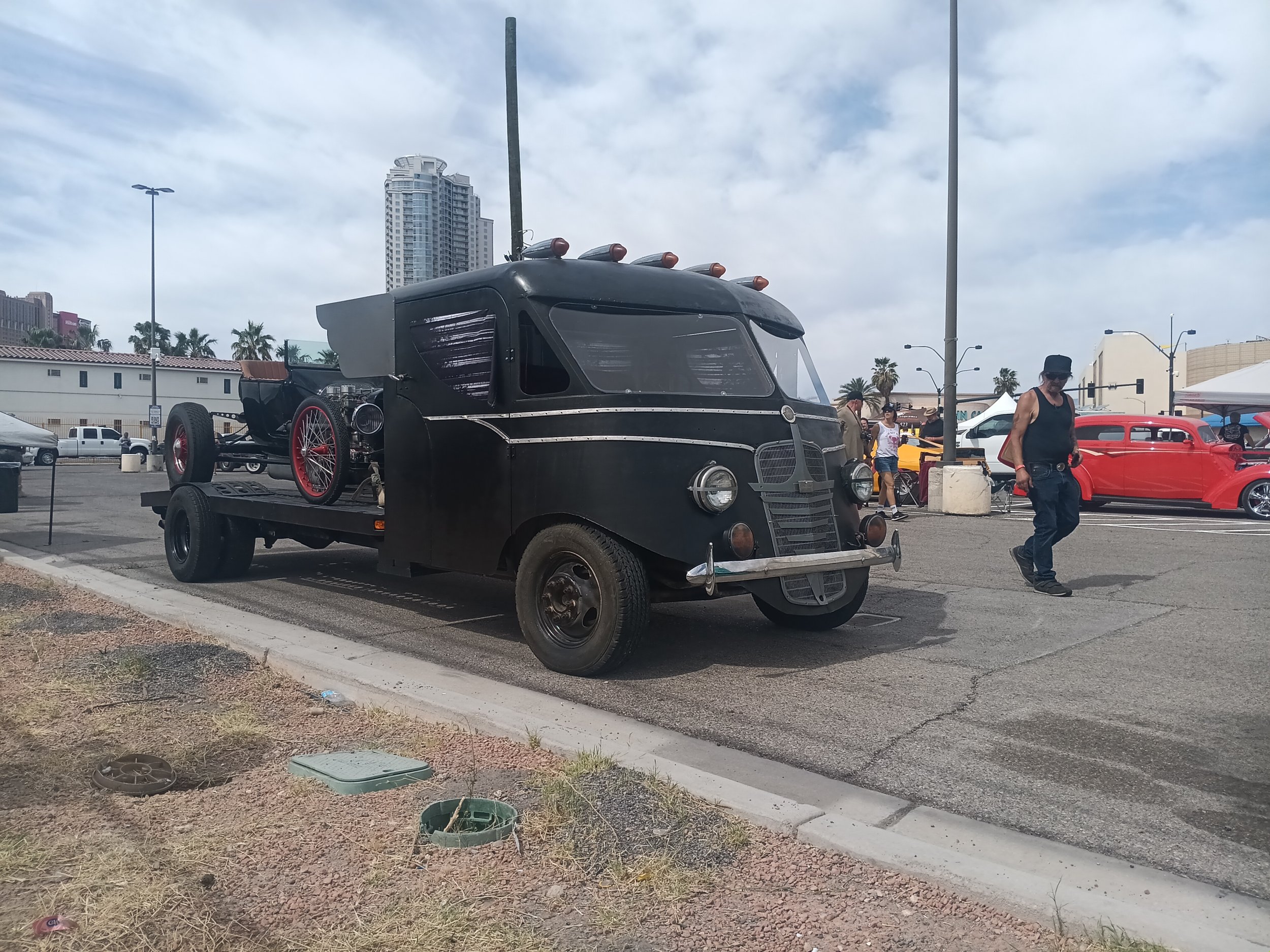

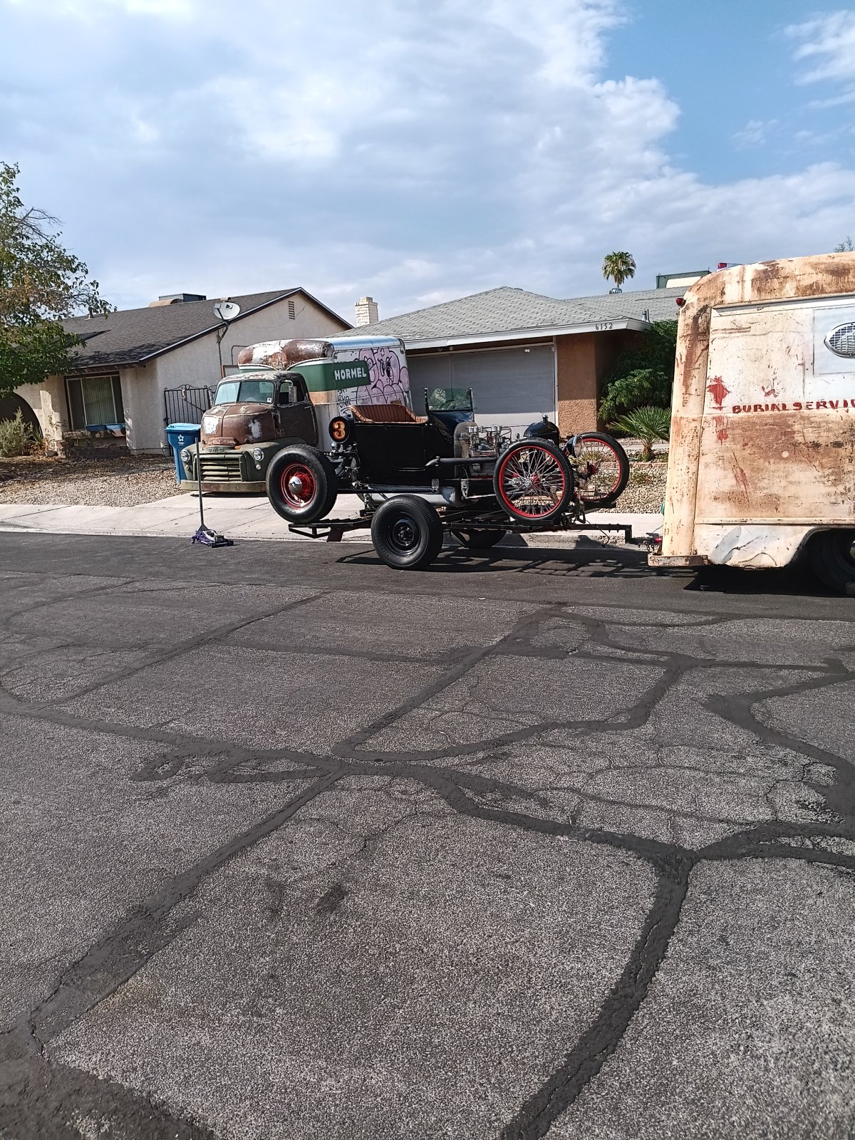

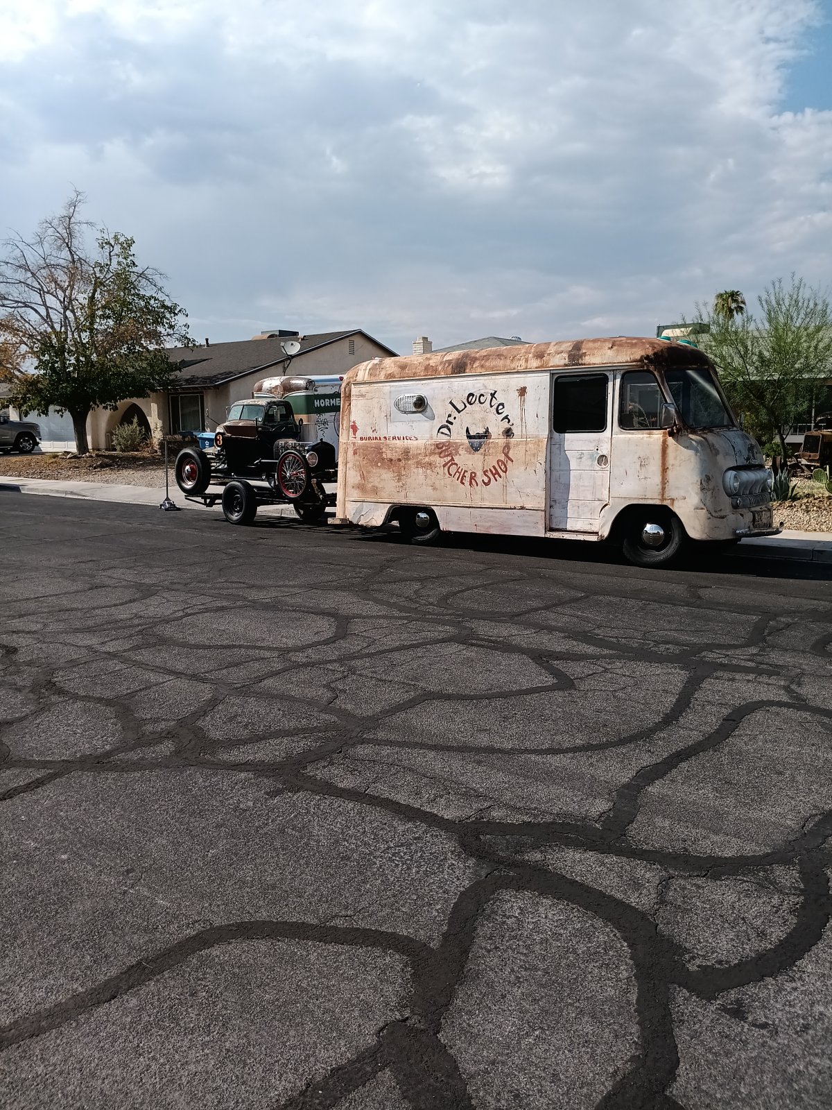

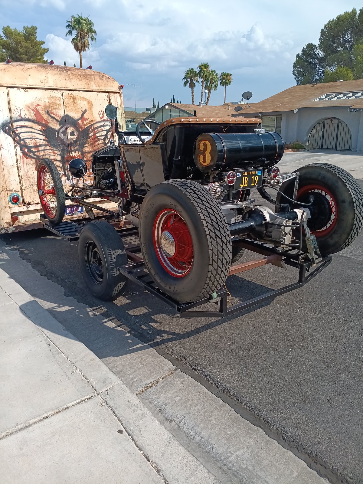

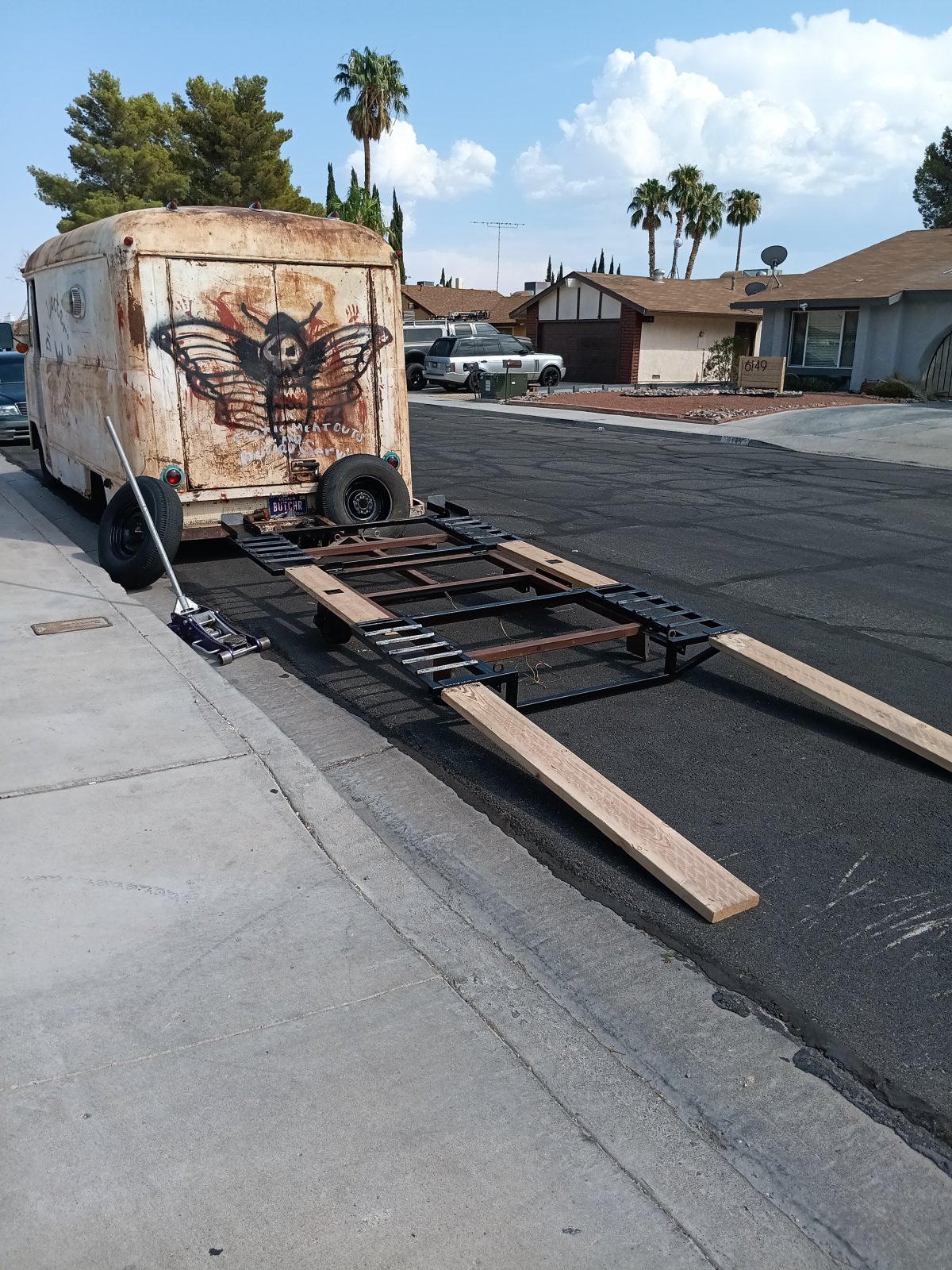

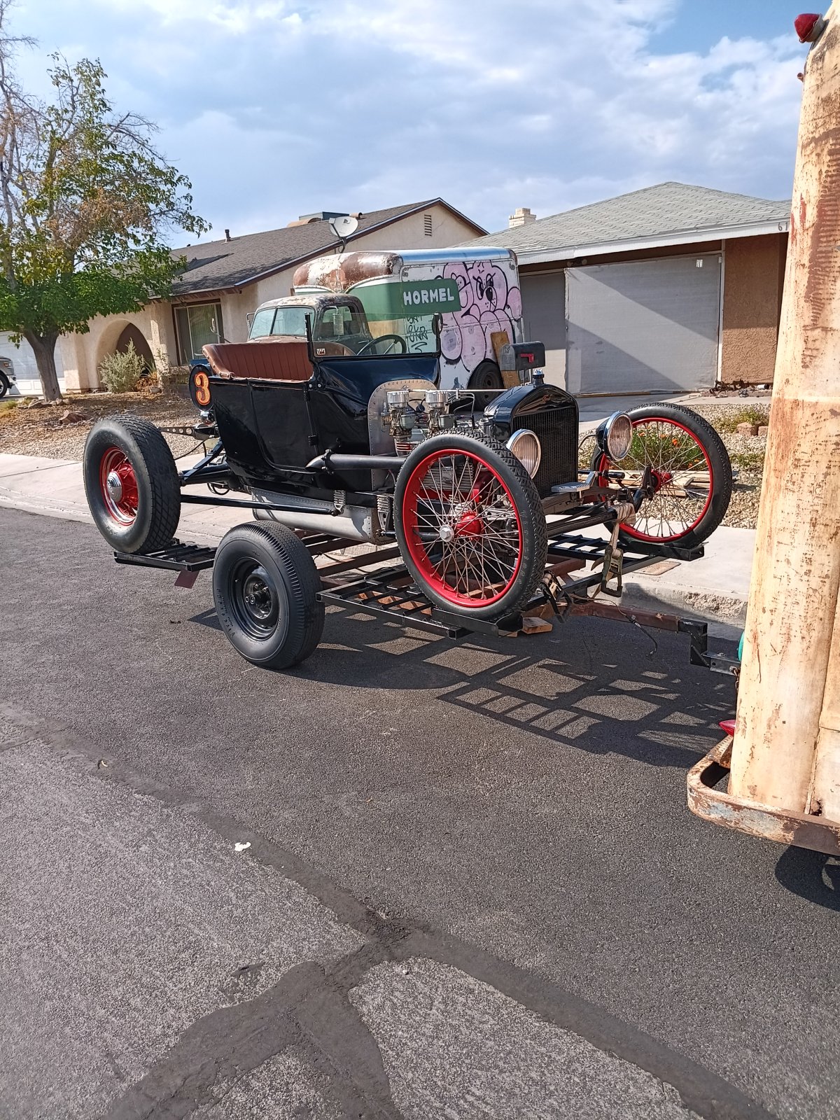

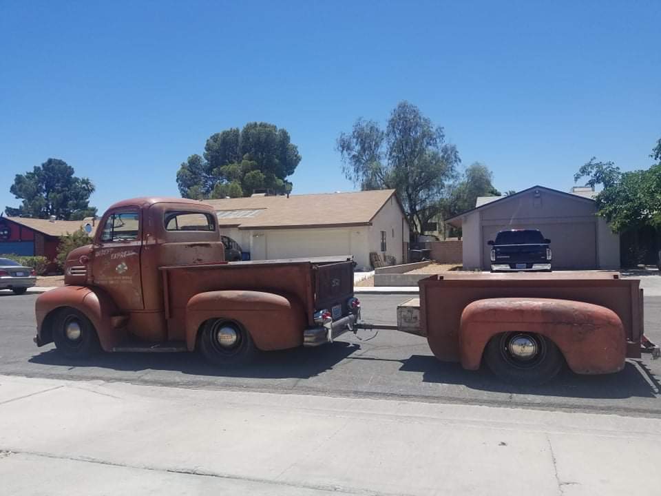

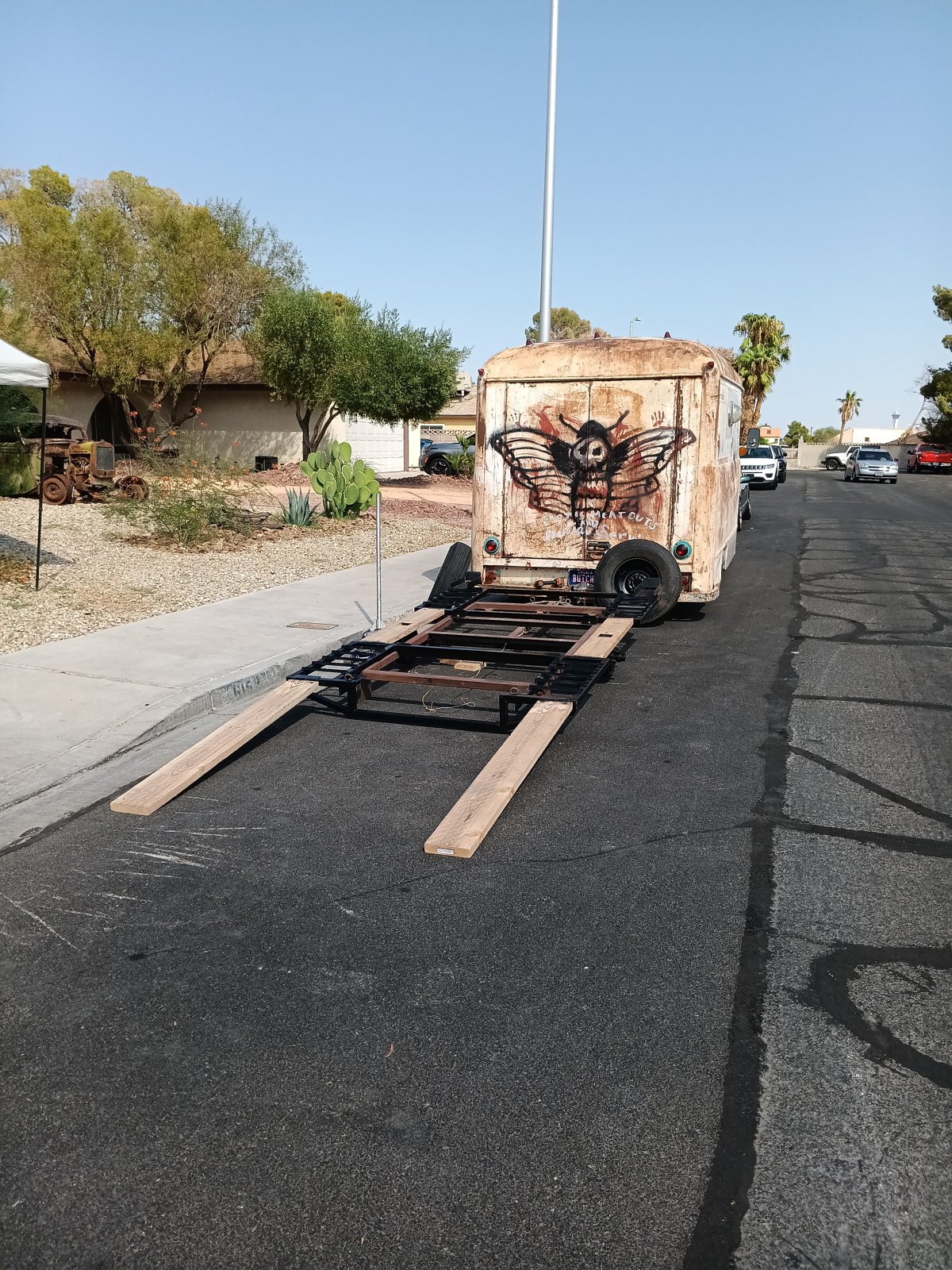

  8. I modified my coe matching utility trailer that I originally built with just 48' f1 fenders the rest is sheet metal/tubing etc..
    I made it so I can disassemble it to a flat bed and it only takes 10 minutes.
    So I modified it some more to pull the model T..and the added frame work comes off with 4 1/2" bolts...
    A little PITA taking the wheels off..
    Still gotta build fenders and some type of truss on the bottom of the main rails since they are bowing..
    Oh and gotta lower the front of the van.

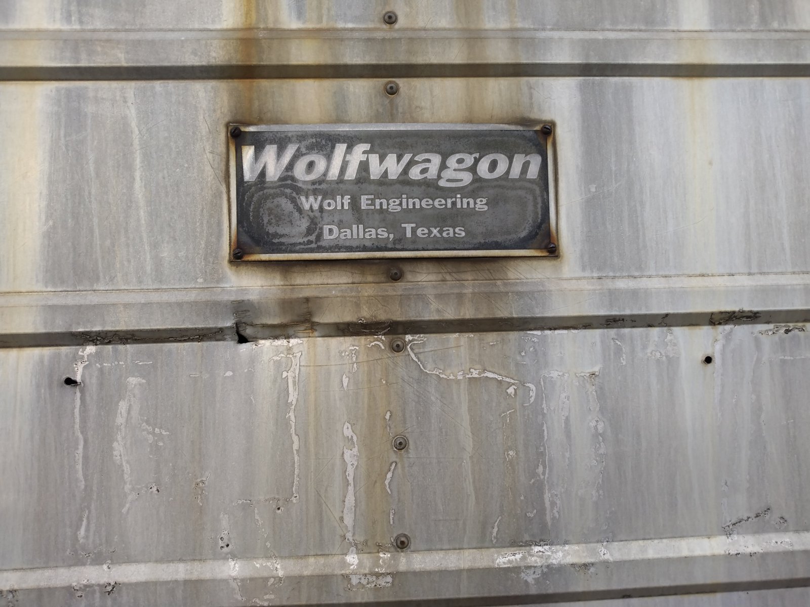

    They are called Wolf Wagons, I saw them on a trucking site on FB. They would hook two of these together, each unit had an engine and driving controls, one driver. He would drive to a destination unhook make his deliveries with the first unit, then empty out his second unit hook them back up and return to his terminal. It was kind of a variation of double trailers...seemed quite labor intensive and did not catch on.

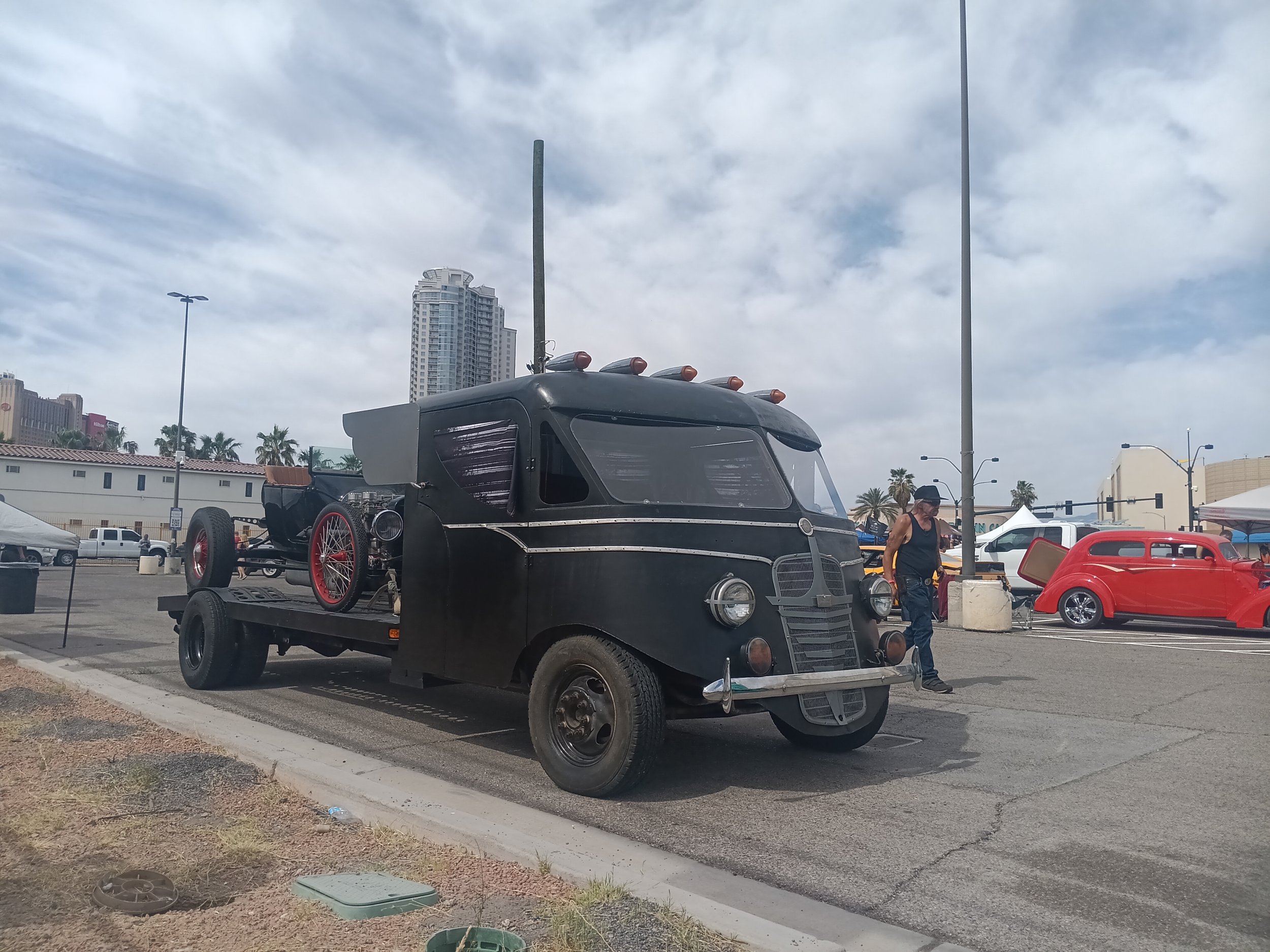

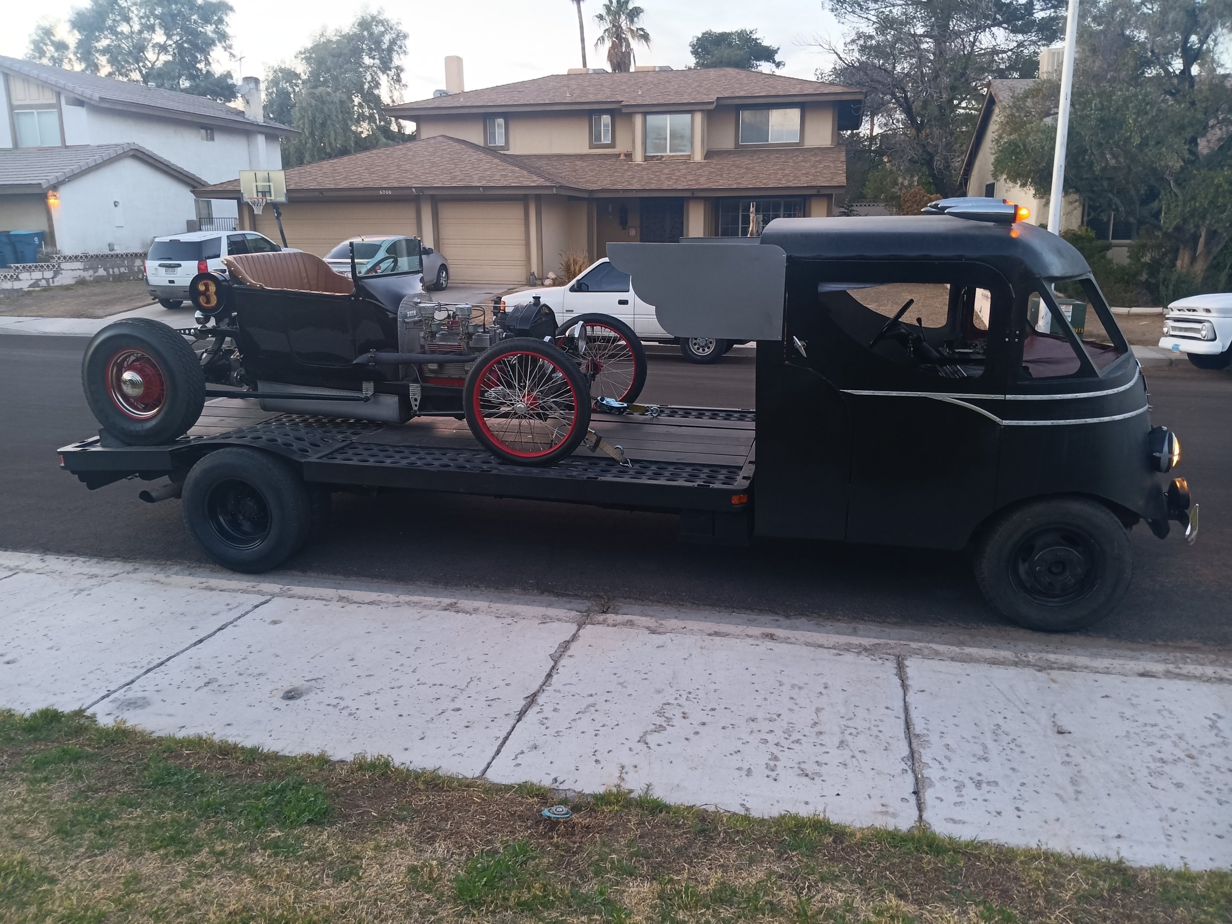

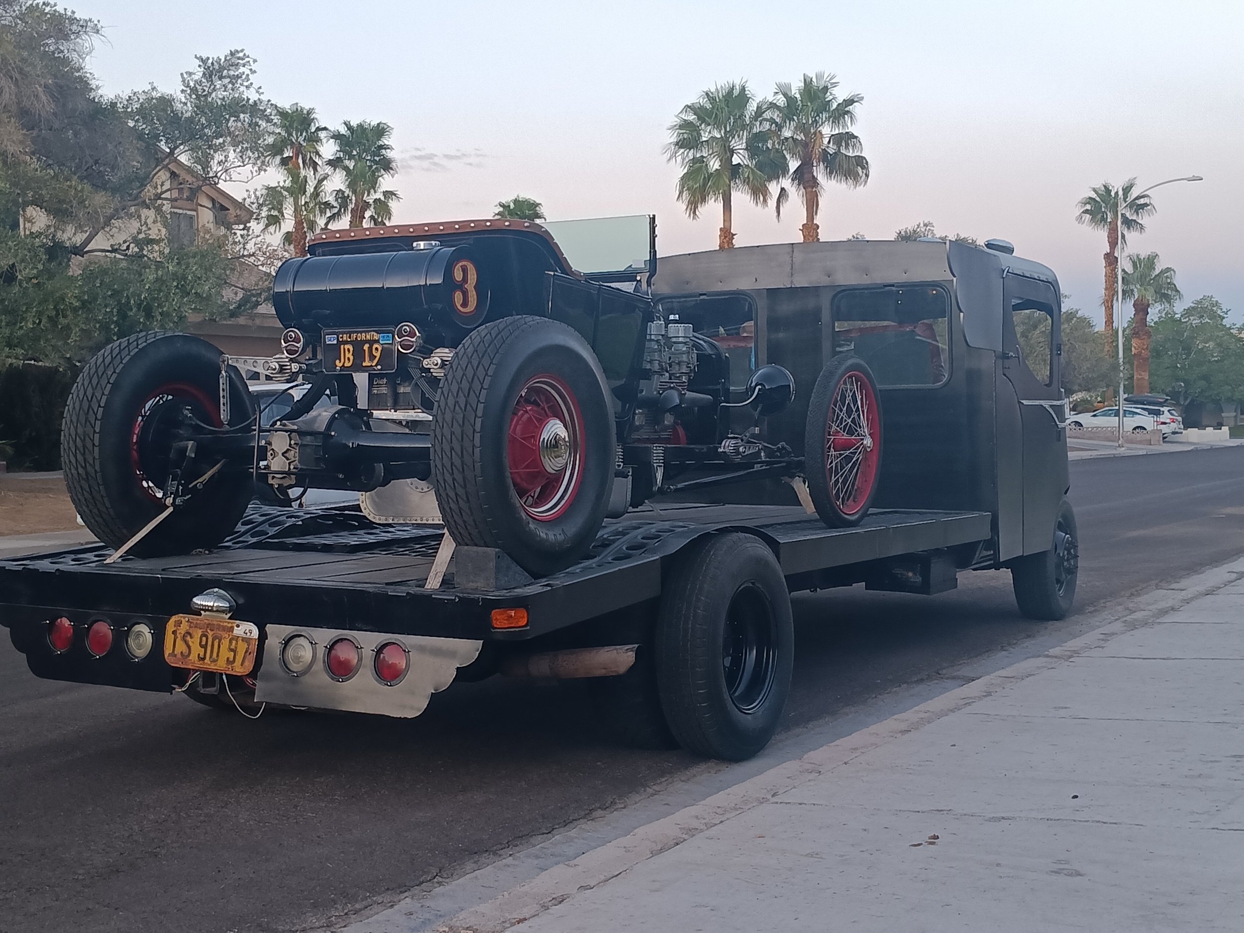

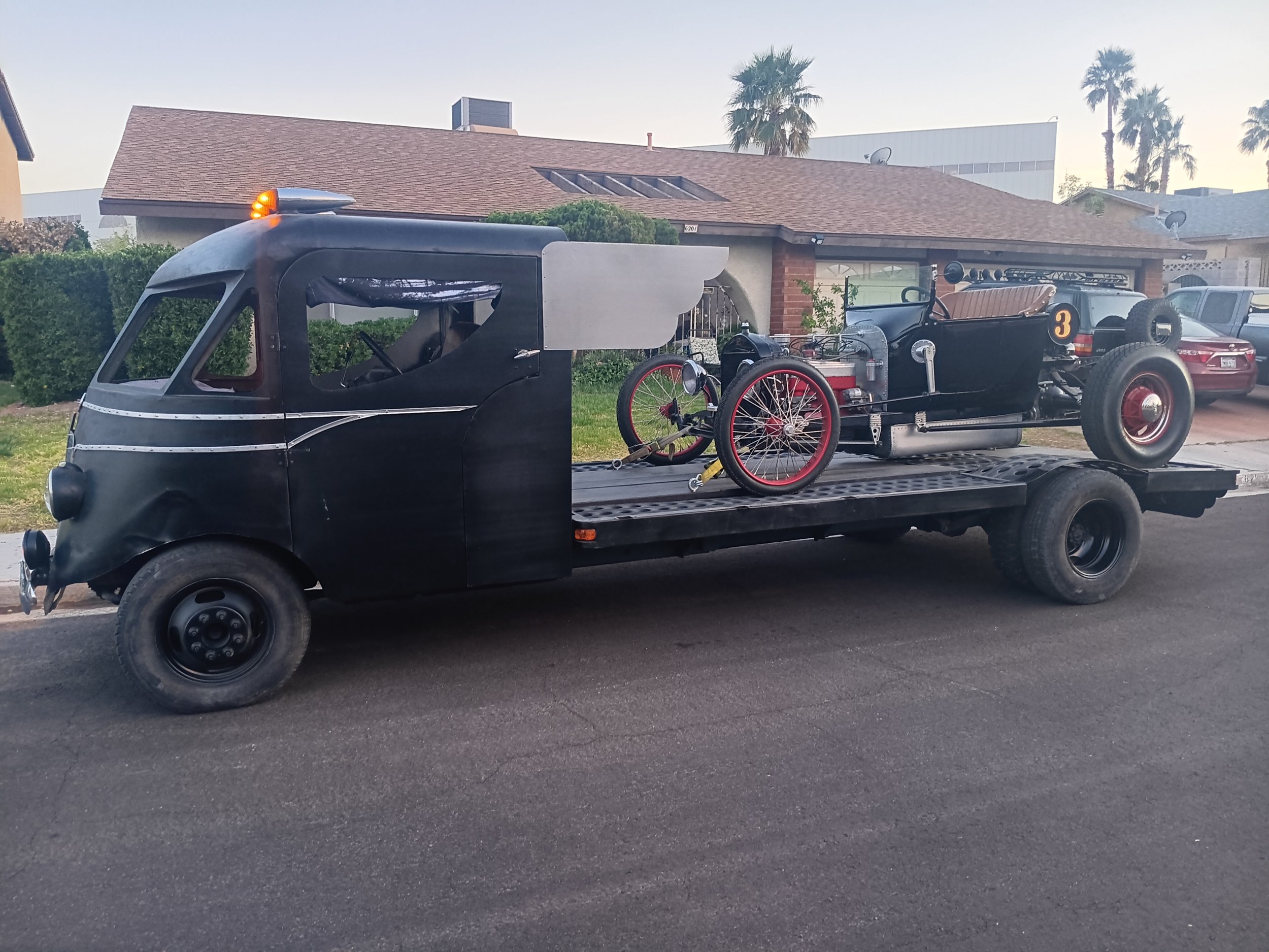

  17. My barebones flatbed.

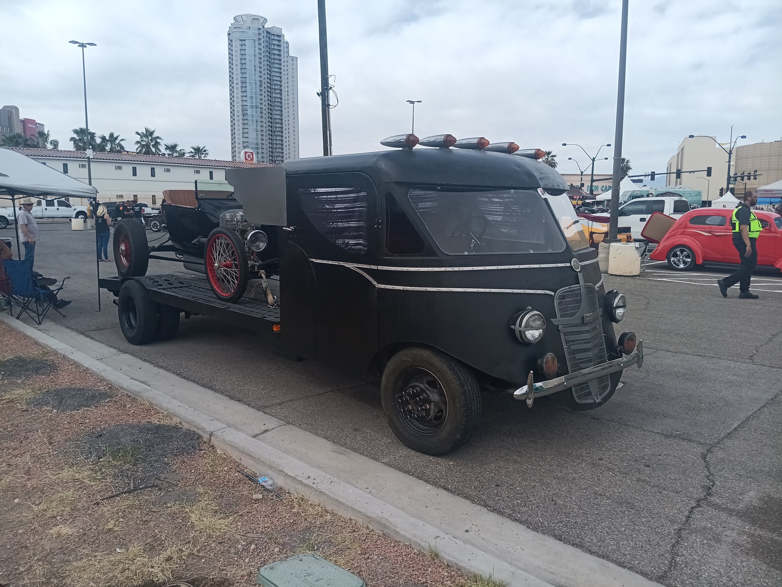

    Hey @iwanaflattie
    That is indeed a bad ass rig! The license plate says 49, so I am just curious what the original truck was or is, was it a bread truck? What is the make and model ? At first I thought it might be an old IHC Metro, but I know that isn't correct.
    Thanks from Dennis.

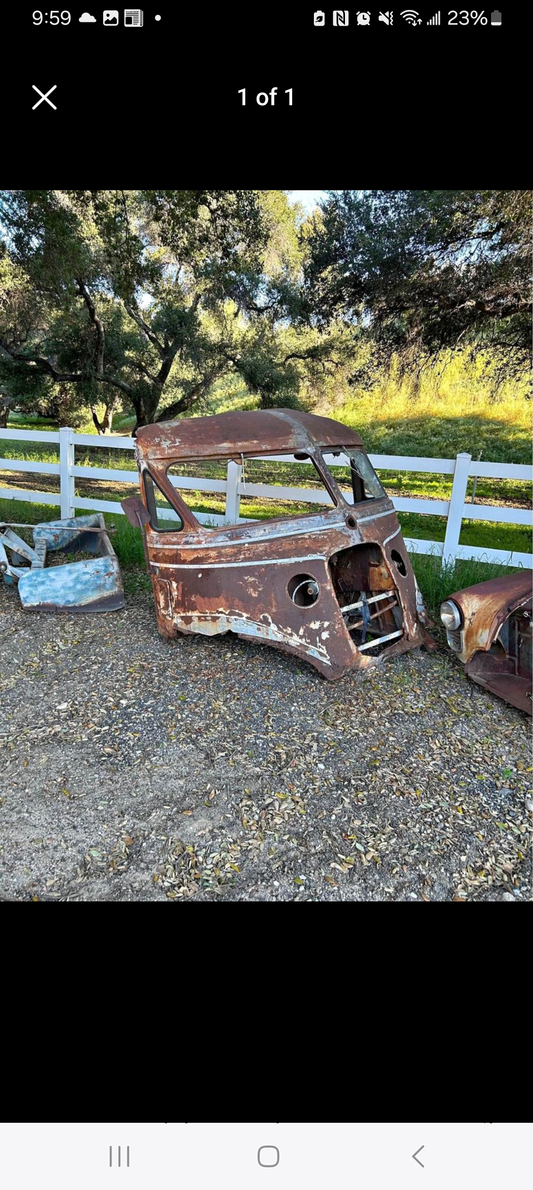

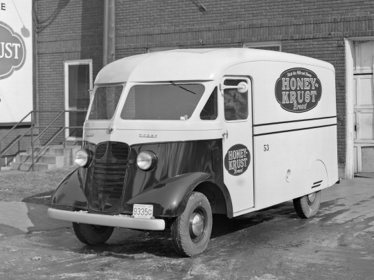

  19. Hey Dennis,I assume it's a 1940 dodge monteplier,based on the pictures I found online..I only found the "face" and I knew I had to do something with it.
