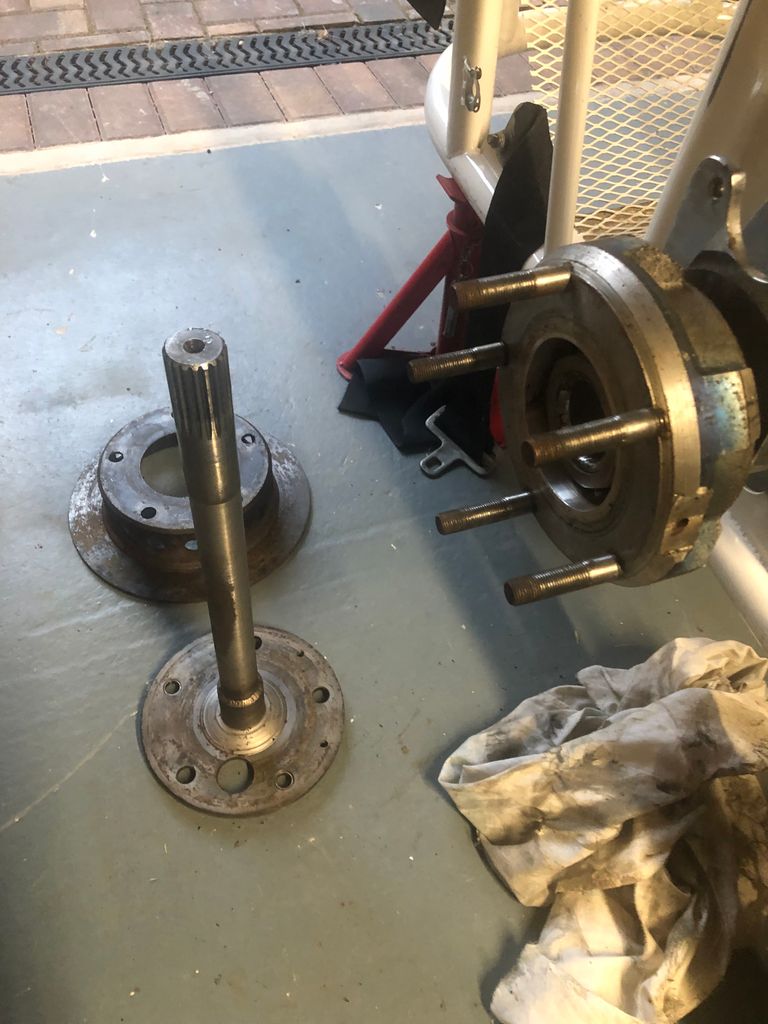

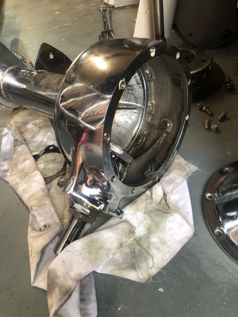

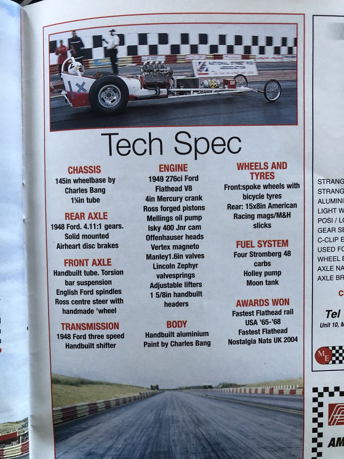

    Quick spec now is the engine 276ci, has a 4 inch crank, forged pistons, isky 400 cam, vertex mag and 4 Stromberg 48's. Gearbox is a side shift early 3 speed, 1st isn't used, and the rear end is a narrowed banjo but with later half shafts.
    It has been in Dean's collection since the rebuild but has occasionally seen the light of day. In 2004 Dean flew Charlie over to the UK, while now in his 70's, to drive the car at the Nostalgia Nationals where he ran a best of 11.26 at 124mph, lifting the wheels on every launch. In 2006 it took part in the historic dragster display at Goodwood and was fired up during the daily cackle fest. Other than being displayed a couple of times at events around 2008 it hadn't been ran.

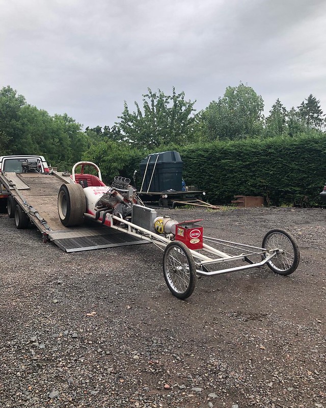

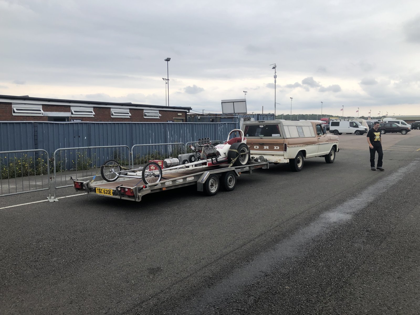

    Pics from when I picked it up

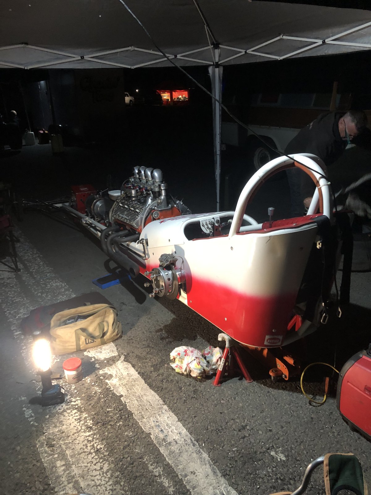

    The plan now was to go through the car and get it to the point that it could be raced again at the Hot Rod drags at Santa Pod raceway last September.

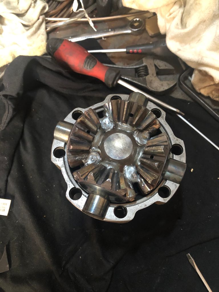

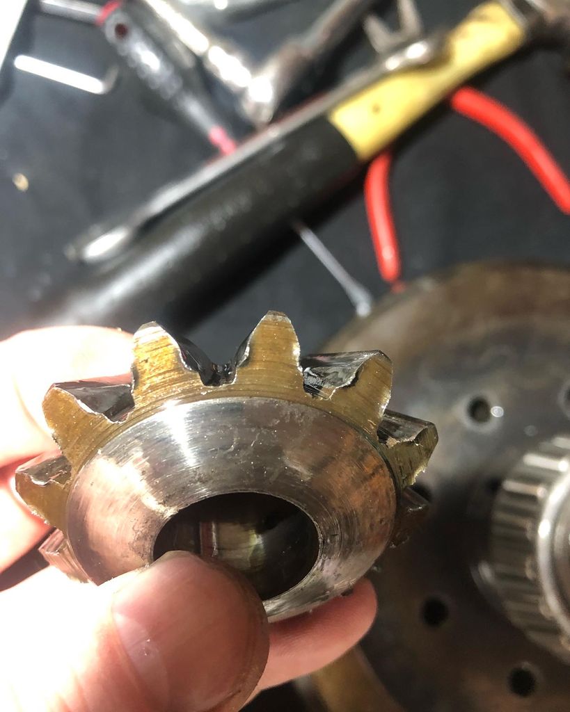

    A few issues arose during the rebuild like 1st gear being smashed, airheart brake calipers were corroded, carbs needed rebuilding, etc etc.
    The spider gears were also no good so I asked my good friend Pete (nutrocker) to weld them up so we had a 'Lincoln locker'!

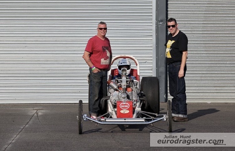

    By this point Pete had also jumped on board to help with the car at the track, loan a trailer etc so I asked Dean if Pete could co-drive which he agreed to.

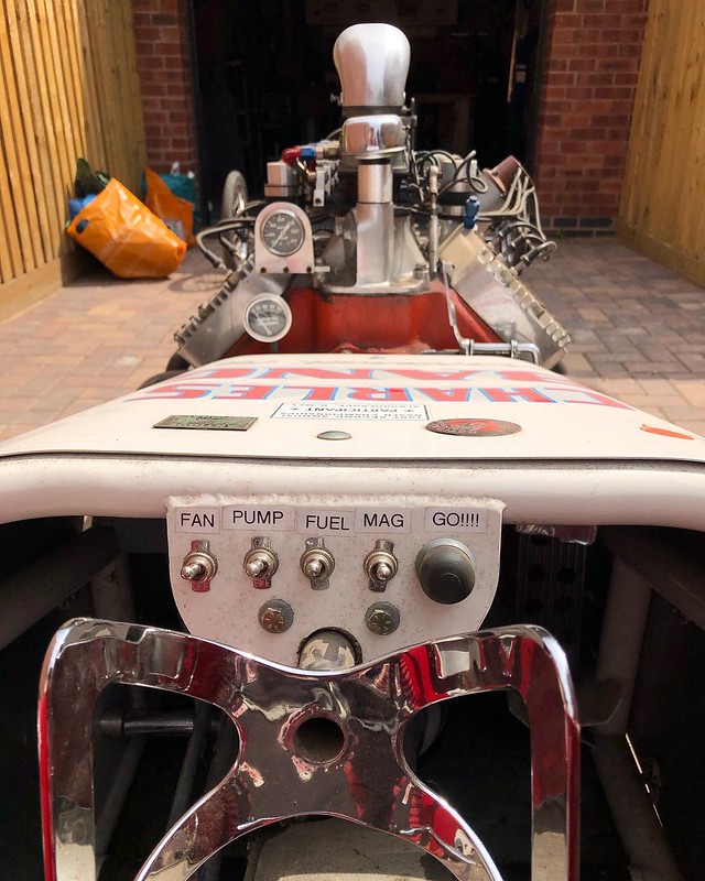

    First fire up, brake and gears check.

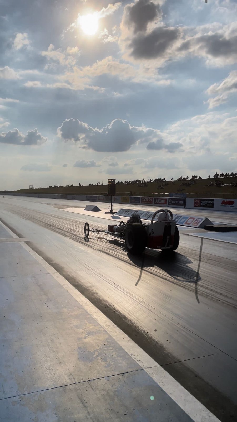

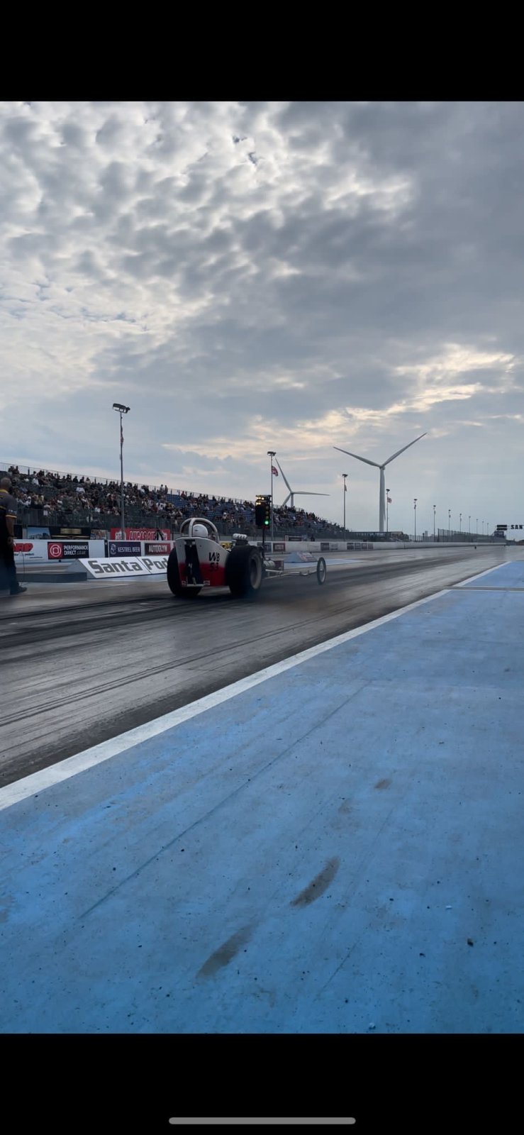

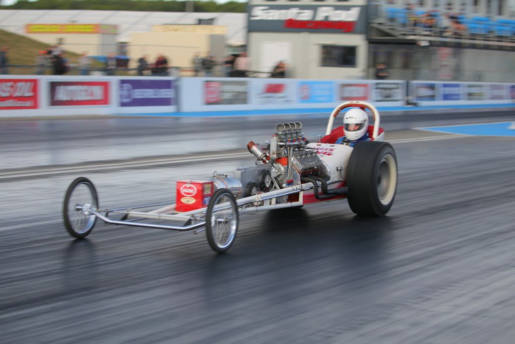

    So how did we do?
    Pretty good but we couldn't better Charlie's performance from 2004. We put 11 runs on the car over the weekend with Pete running a best of 11.7 at 116mph and me a 11.8 at 116mph. Of course we were both acutely aware that it wasn't our car and that it is pretty historically significant so side stepping the clutch off the line and pulling wheelies wasn't going to be an option!

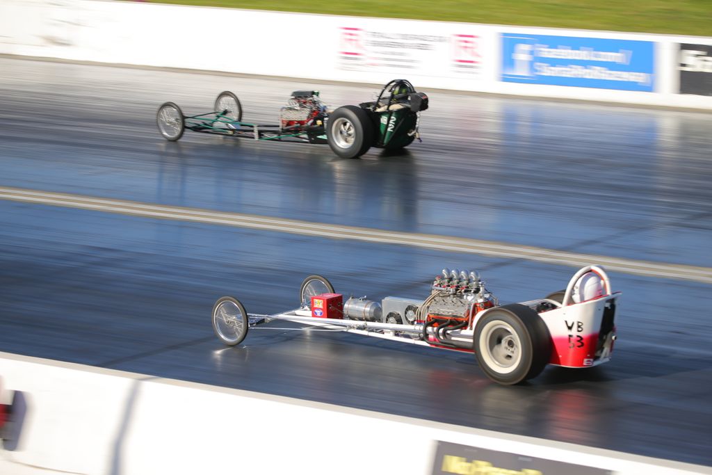

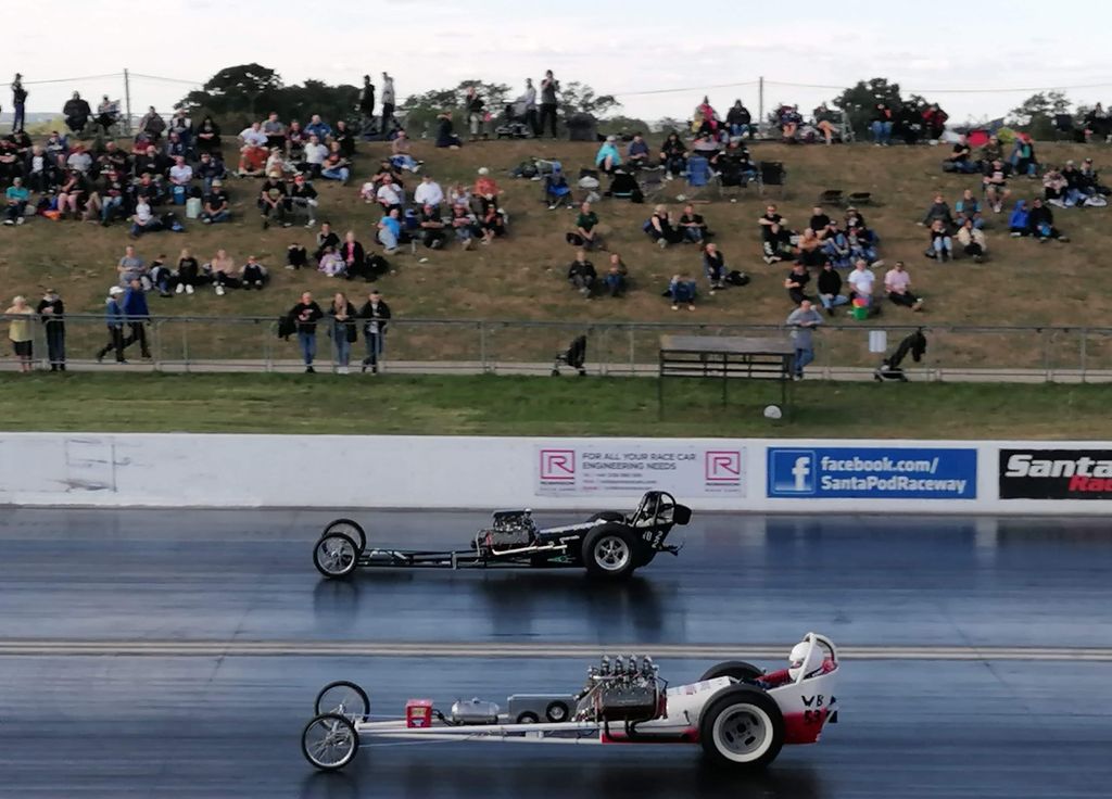

    The coolest part was that we got to match race with the only other flathead dragster currently competing in the UK owned by Bradley and Ken Cooper. Ken is THE flathead guru over here and was running 10's in his own flathead dragster back in the 60's. Their car now runs high 10's on methanol so had us covered on every race but it was fantastic to have the cars side by side.

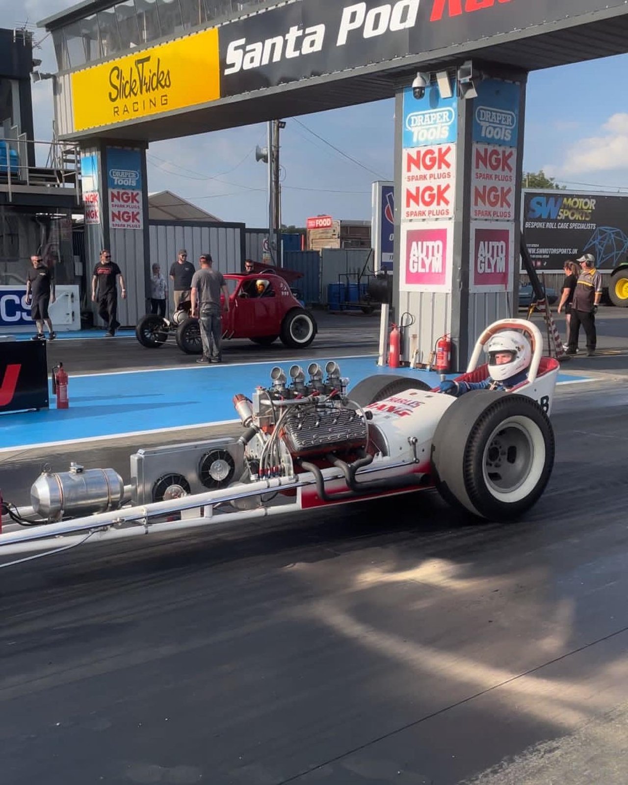

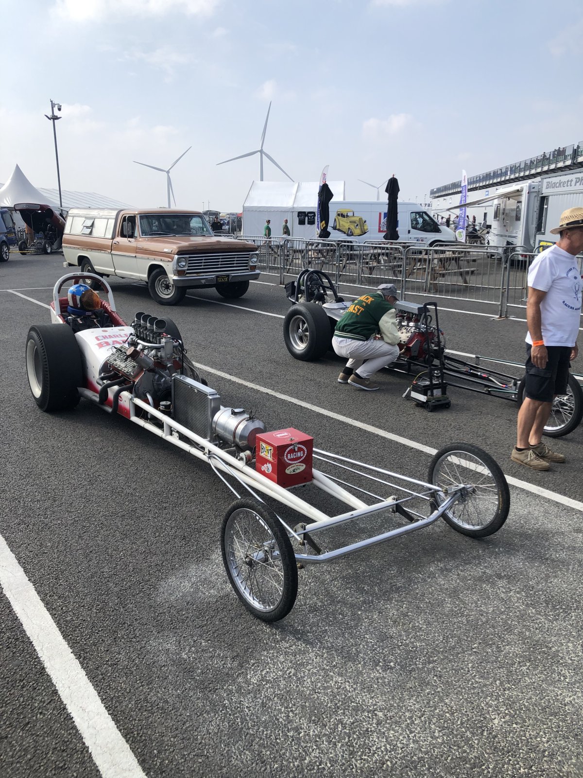

    One year on and Pete and myself found ourselves once again racing at the Hot Rod drags in the Charles Bang special.
    Huge thanks to Brett for loaning us his trailer and to Damon who ably ***isted in running the car all weekend.
    Slight bit of drama on the Thursday as the airheart caliper's that I had to strip and rebuild numerous times last year to get them to stop leaking decided they didn't want to hold fluid again after sitting for 12 months. 3 hours and numerous rebuilds later we had brakes that worked, sort of.
    Once again we had the honour of match racing Ken and Brad cooper although engine woes put them out on the Saturday. During the Friday we were also able to pair up with Azza and Eff's Topolino. Another rear deal, flathead powered, built in the 60's dragster that hadn't seen a drag strip for many many years.
    Times were down on the previous year with a best of 12.2 but we think the clutch has seen better days and is slipping on the launch, backed up by slower 60 foot times. Still a great weekend and hopefully if we get to run the car next year we can spend a bit of time sorting the little issues out.
