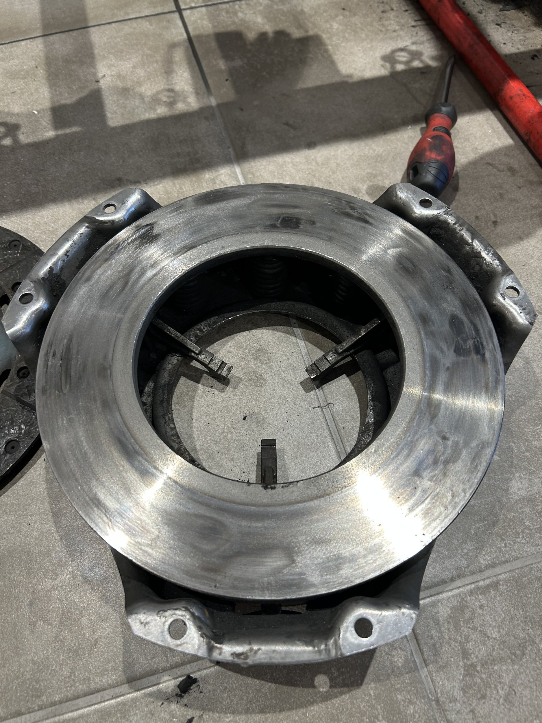

    To this end, earlier this year, I went over and pulled the trans to confirm if the clutch was the culprit of our slower e.t's
    Not every day that you get to wrench on an original 60's digger sat next to a 50's Indy car!
    Safe to say the clutch had seen better days!
    The car uses a stock 10 inch flatty clutch so a new kit was ordered from Rock Auto and I had the flywheel skimmed.

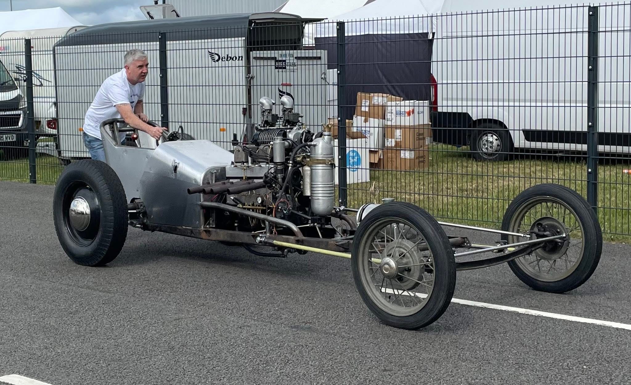

    With the car in one piece after the event thoughts turned to the next one which would be the Hot Rod Drags again in September. The only work carried out prior was to replace the HT leads as they were pretty old and brittle.
    I also put together an info board detailing the car's spec and history as people are often intrigued by it.
    Pete had also decided that tow cars aren't cool enough and wanted to push the car instead. He knocked up a push bar and fitted a board to the front of his model T modified which just so happens to run a blown, overhead converted, dry sumped etc etc 4 banger! Needless to say the combo drew plenty of attention over the weekend!
    14cdaaa0-0b44-471e-8361-abfefa13a29b.JPG 06872cb5-85a0-4865-ace2-5a1f3256cc6f.JPG

    Unfortunately half way through Sunday the clutch once again threw in the towel and started slipping BAD. Damon managed to nurse it through to the win in the meltdown final slowing to a 14.9 but we had to retire the car from further compe***ion.

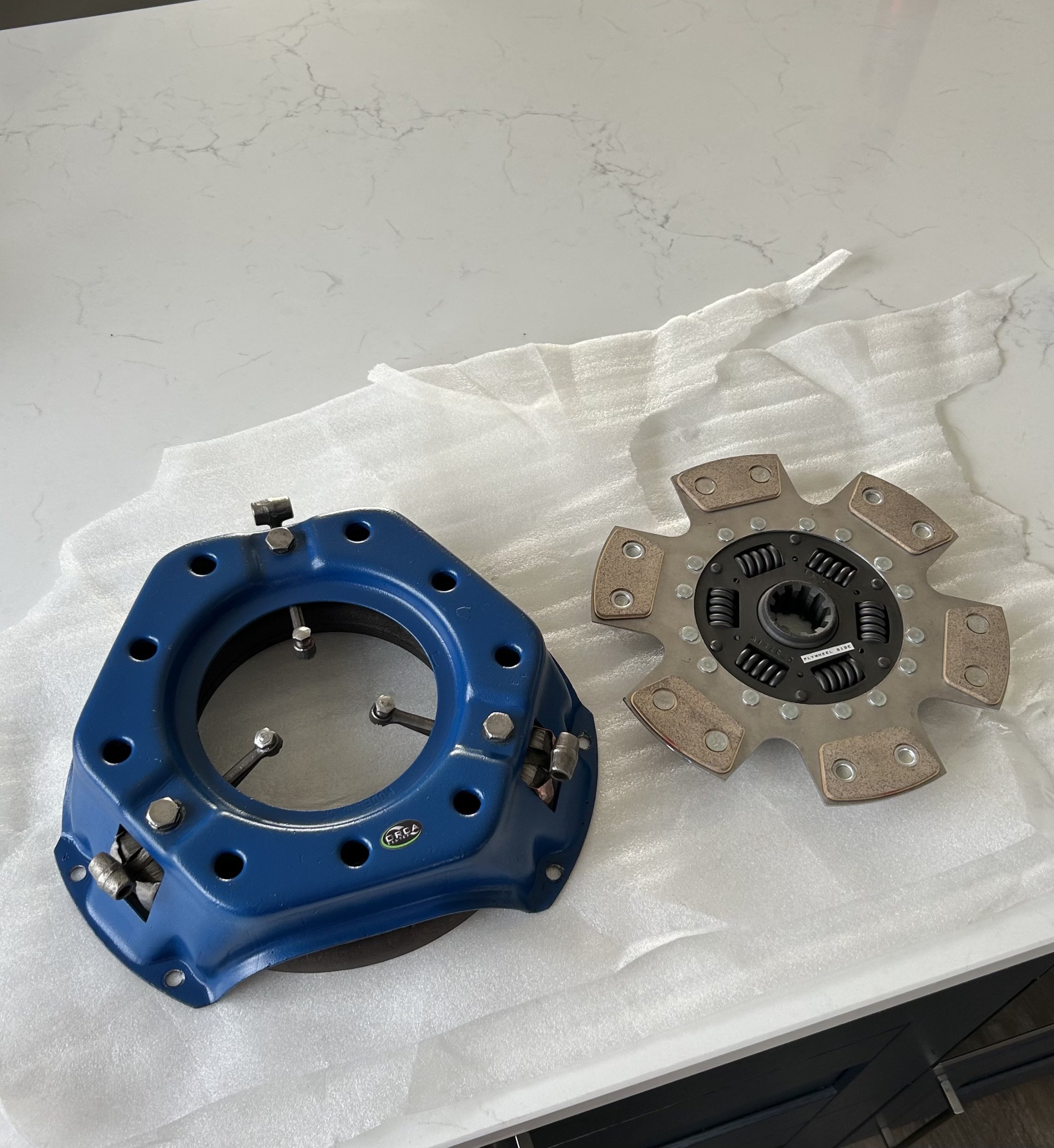

    With race season just around the corner it was time to, once again, remove the clutch from the Bang dragster and ***ess the damage. Well, if the last one wasn't worn enough we certainly made sure this time!
    Not wanting to repeat this process every 15 or so runs we decided an upgrade was needed. Pete resurfaced the flywheel and also machined it for a steel insert. Meanwhile the pressure and friction plates were sent to Orca Clutch in Hants who couldn't have been more helpful. What they returned was a 6 pad sintered friction plate using the flathead centre and a refurbished pressure plate. Interestingly Wayne at Orca was surprised that Charlie had obviously built it with 3 different springs pressure's so that it has a bit of a 'progressive' nature to it. Another one a Charlie's secrets revealed it seems.
    A couple of weeks back I went over and refitted everything, while doing so and out of curiosity, I pulled the intake off the as we hadn't looked inside the motor before.
    Bare in mind that when Dean commissioned Charlie to rebuild the car there was no real intention at the time of it ever racing again and that the flatty needn't be anything special but it seems Charlie couldn't resist a bit of porting while it was going together.
    So it's all back together and we will wait and see how the clutch performs in a couple of weeks.

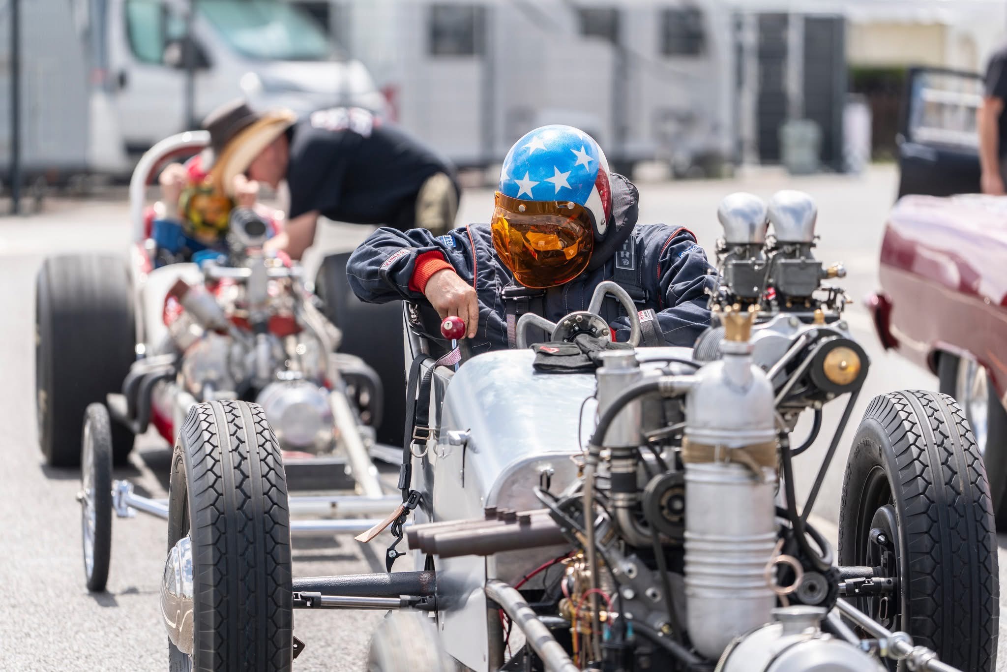

    Next up was Dragstalgia at the end of June where we once again joined the rest of the wild bunch at, what is now, the biggest 'traditional' style drag event of the year.
    The newly christened 'Proper Charlie's' drag team turned up with not only the Charlie Bang Special but also Pete and Damon's new car. With the blown banger and running gear from Pete's T, added to a bunch of parts Damon has been collecting, a six week thrash saw 'The Charlie Bang'er' early rail job debut.
    The plan was just to run it in RWYB on the Friday but the chief starter had other ideas due to the lack of roll over protection. The plan all along is to fit a roll hoop on the car but the first iteration didn't meet expectations in term of style and was duly cut off with time running out to fabricate another. So, somewhat disappointing but not totally unexpected, it meant the car was now put into action as tow vehicle.
    Friday and Saturday saw extremely hot temperatures and a heavy head wind which meant performance was down with the car posting times in the low 12's. With the weather looking a little more favourable for the Sunday we decided to post our dial in time somewhere in the middle of where we usually run and where we were running. 11.99 seconds.
    Amazingly the gamble worked and over the three runs that count we somehow managed to bag third place in wild bunch compe***ion. Not only that but an earlier run had seen Pete reaching for the sky again which also meant he won the showmanship award from the wild bunch and best wheelstand of the event from the organisers!
    The real highlight though was having flathead racing legend Ken Cooper back at the track, after a couple of years away, with son Bradley racing their 'Back to the past' dragster. It was great to have the two cars lined up and we matched raced 5 times over the weekend with the Coopers breaking back into the 10's again on one run.

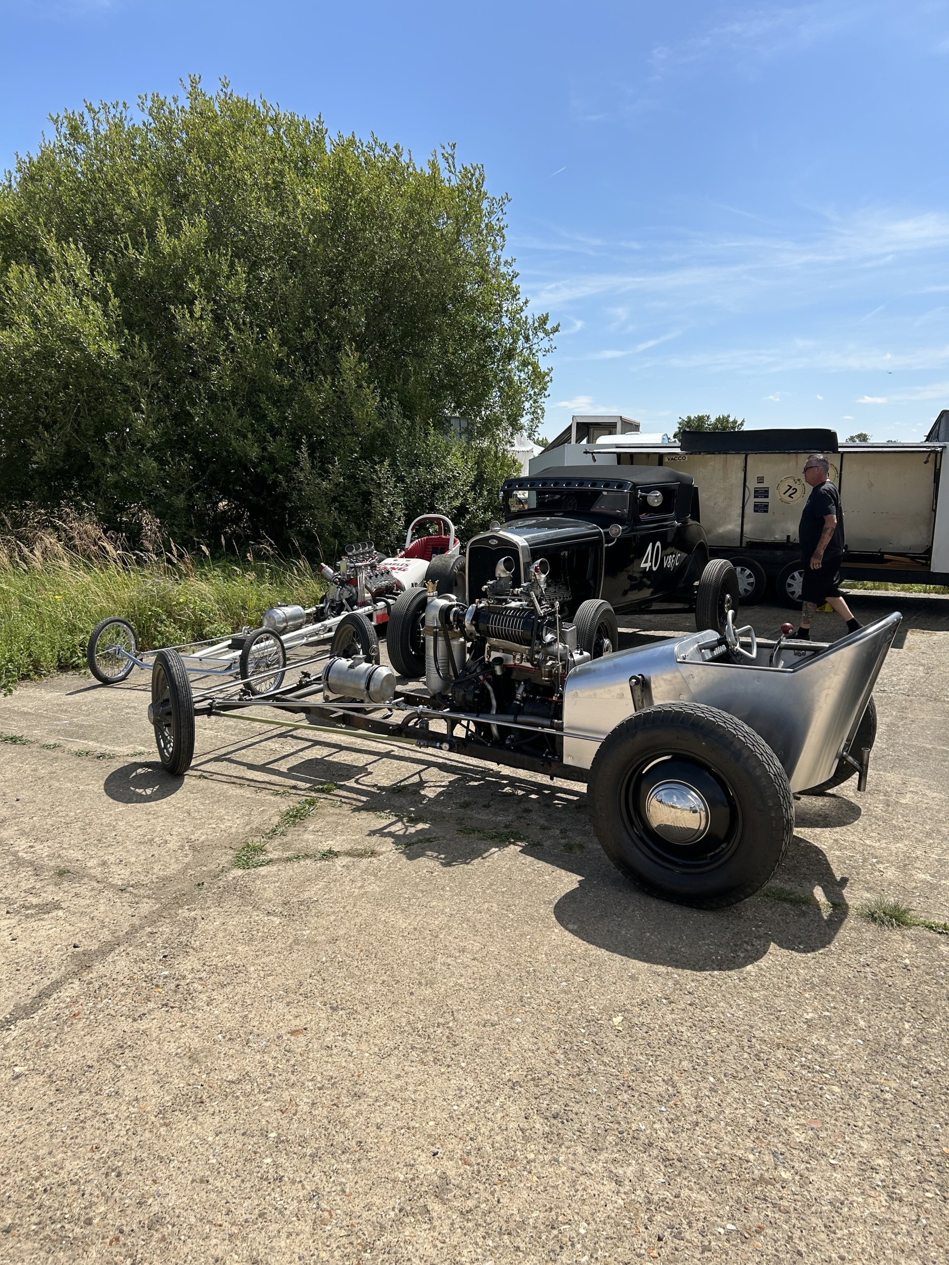

    Hot on the heels of Dragstalgia came MPH vintage drags. A complete departure from Santa Pod, this was an 1/8 mile flag start race on an old, some what bumpy, unprepped ww2 airfield.
    Not strictly open to compe***ion cars, we contacted the organisers a few weeks earlier who pitched the idea of us running both rails as an exhibition element of the event before and after the main hot rod grudge racing. Happy to get some runs in, especially on the blown banger, we jumped at the chance.
    So while I ran the Bang car and Damon got to grips with the rail job, Pete took his A sport coupe along to embarr*** some overhead valve motors!

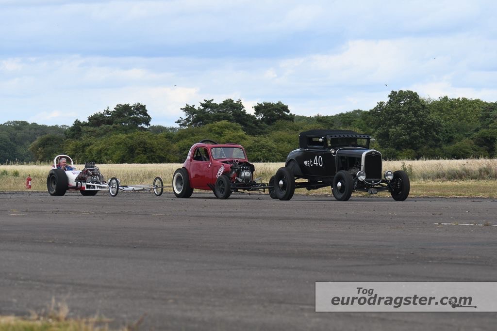

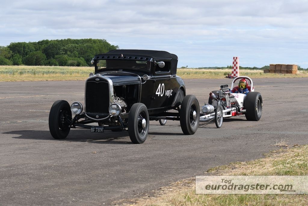

    So Saturday morning saw both cars start the event off with a couple of side by side runs to warm up the crowd. Surprisingly the Hoosiers hooked up pretty well on the bare surface and the car seemed pretty settled over the bumps. the banger too sounded happier on some new plugs and ran well.
    In the afternoon we just had to line up with our friends in their 'Chinese Bandit' flathead altered, a car first built in 59. Charles' car is mere pup having been built in 63!
    The guys have put a lot of work into getting the bandit running well but it wasn't quite enough as I lifted the wheels out of the hole and took the win. The race made for some great pictures and video.
    Pete meanwhile had made it to the top 8 compe***ors of the day, the only flathead to do so, who then went head to head to find a winner. Unfortunately he pulled the eventual victor early on and was knocked out.

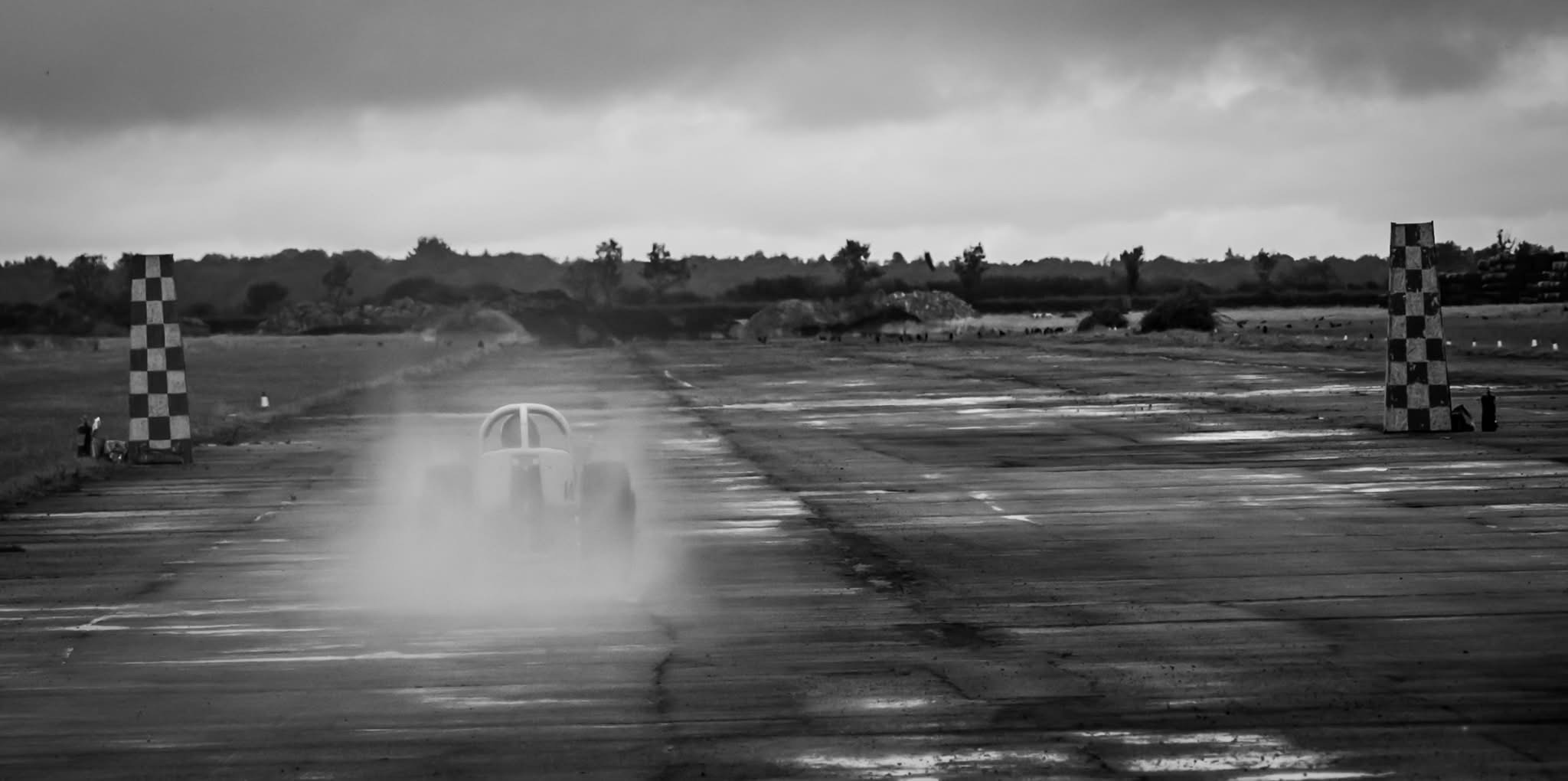

    Sunday arrived and so did the rain. We thought the event would be called but the organisers were happy for racing to continue in singles on the now damp track, even the rails!
    Flathead dragster, on slicks, in the wet? What could go wrong? We put two more, somewhat, exciting runs on the car in the unfavourable conditions before deciding discretion was the better part of valour and packing away. One of the trackside photographers showed us one of his shots that showed the car still lifted the wheels on the 1/2 shift in the wet!
