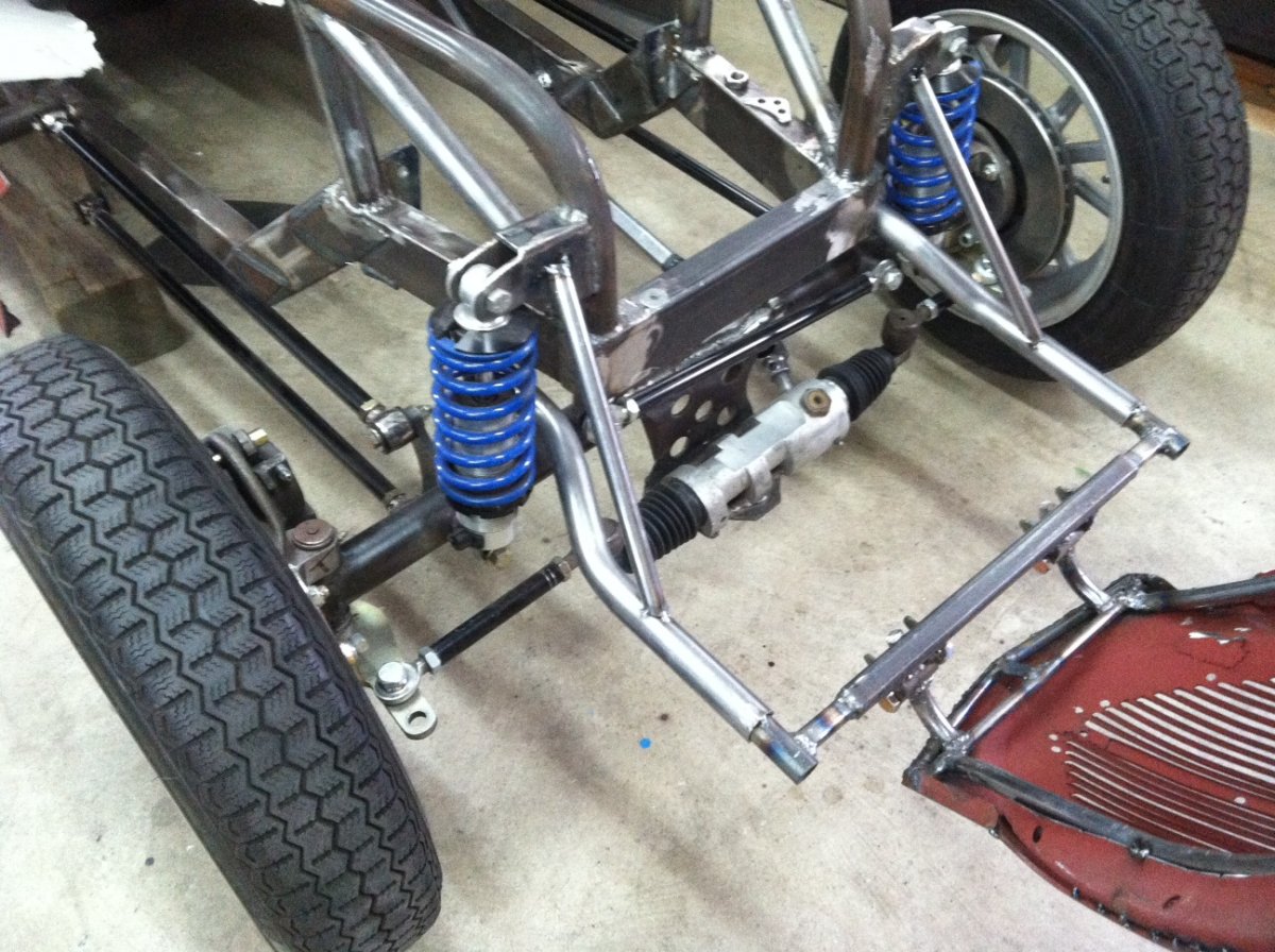

    I am using an Appleton rack in my Fiat. Very compact unit and built very strong. Mine is a manual rack ,but they also make power steering ones also. I believe these are used in sprint cars and in late model modifieds mostly. photo63.JPG

    I hope that you don't have too much wheel travel when your car is together with the weight of the motor etc in place. As it sits right now the panhard bar is going to push the axle to the left as the suspension compresses which will cause the left wheel to toe in and that will be accentuated by the short tie rod on that side swinging in a tight arc. If the panhard is level with the ch***is loaded that will help but you will still have toe in. In addition the car will scrub the front tires in turns due to the ackerman being way off with those steering arms. You may also want to think about putting the axle end of the four bar in double shear. Not trying to be a **** but that is what I see.

    Thanks Roo,
    No offense taken. Good advice is good advice appreciate it. I have made a few changes since this picture was taken and in my initial test driving I haven't noticed any poor handling yet. The double shear is in the plans when I take the car back apart. Thanks Again
