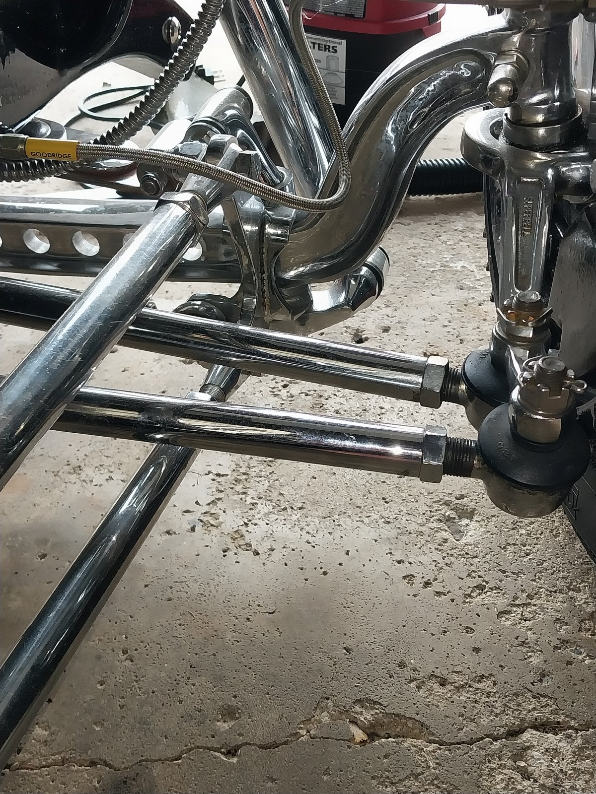

  8. First photo is with left hood raised, (left hand drive).
    Second photo, it hardly shows with the hood closed.

  10. Seems like the Unisteer is designed around 4 bars and hairpins.
    The "dead" end of the rack extends outward when turning right and can get really close to regular split 'bones if you are not careful.
    The connection to the RH steering arm is also interesting to work out with the wishbones and a brake kit that requires stock steering arms. Drag link isn't low enough to go under the wishbone like it does with a regular cross-steer box.

  11. The comments about split bones clearance may well be correct.
    I have Super Bell 4" dropped axle and matching dropped steering arms, along with P&J hairpins, etc.
    The steering link and tie rod are nearly parallel from front view and top view.
    Here are photos with full left and full right to show more than adequate clearance.
