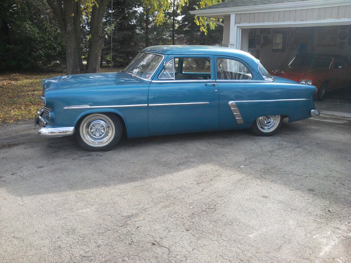

    I have 215-75's on my '52 Ford. It's got 3" blocks in the back. The radials make it more difficult to get the tires on and off due to the fat sidewall of the tire, unlike the bias tire's more flat sides. I'd run bias on my car if money was no object but this was cheaper and the car is a budget build.
    My '53 is the same way, and you have to let the air out of the tires and jack the body way up so the rearend will fall down with the springs to get the wheel off, a real bastard. One person suggested using air shocks which you could fully extend to get the rearend away from the frame, and you could still jack on the axle for height. That seems like a great idea to me, and I'm planning to do that on my '53 at some point.

    Thanks! This is a budget rebuild as well. Air shocks would help a lot I am sure. I have 3in blocks in the rear and am getting ready to do the good ol' aerostar spring swap to lower the front down. I've decided to get rid of the white walls so its nice to see your photo with a level ride and the radials on it.
